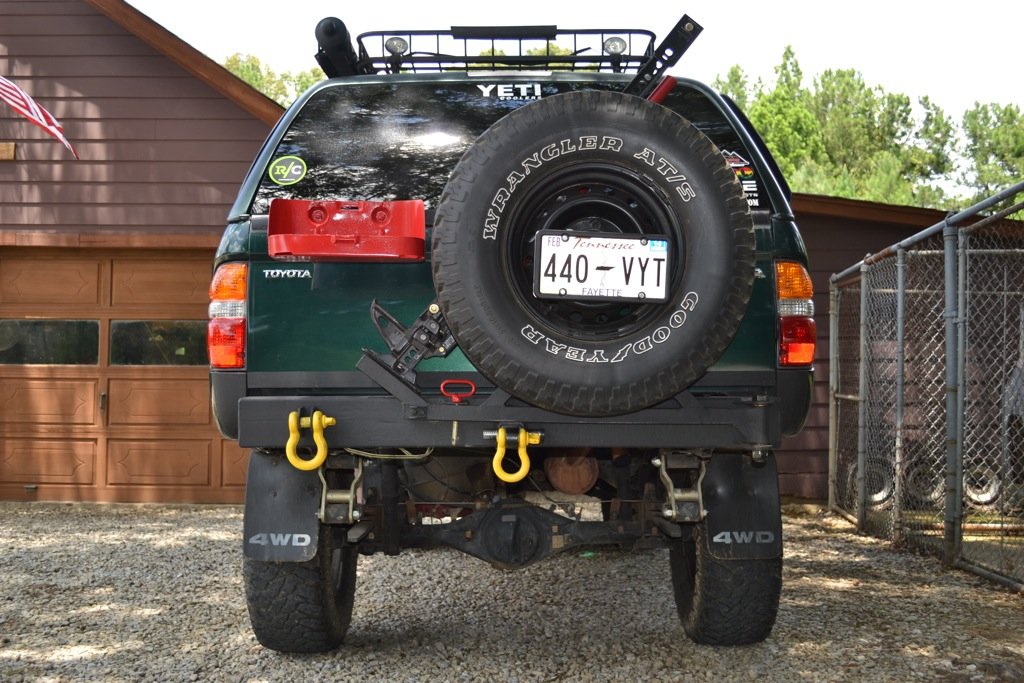

    Thanks! Like I had mentioned, I planned to have it on the swing out all along but couldn't ever decide on a good angle or spot to put it. All I knew was that I didn't want it sticking straight up. So after toying with it and having TacoSkeet hold it at different angles while I stepped back and looked and checked for clearance, I decided on the spot it currently sits.
    Much appreciated! I never thought of the sword and shield thing till you two mentioned it but now that's all I'm seeing!

    whoever did it it came out great, I'd love to have a bumper like that on my truck. If the isn't a spare mounted can you open the topper window without having to swing out the arm?

    As far as the back window opening without a tire, no. It hits the Hi-Lift. I wanted everything tucked up as close to the rear of the truck as possible. If I wanted to be able to open the glass all I would need to do is shorten the vertical bar by about 4" and extend the horizontal one about 3-5". Then everything would clearance without having to swing out the tire. I don't mind it though. I'm used to opening it now so it's no big deal.

    Your rear bumper/spare tire holder/license plate/ hi lift is awesome! The more Im on TW the more I love the function/look of a tire gate. Your truck and BoxRockets work on Paul's tiregate, is making me consider one.

    Thanks Woody! I love the looks of it and the function is awesome as well. I love having all the other 1st gen Tacos around double take when they see me driving around with the new bumper. I modeling mine off of Box's original bumper design but modified it slightly to fit my needs/wants. I still need to add the wrap around tubes to allow for the side protection. That will happen in a few weeks hopefully. Then I think that's all for the rear bumper.

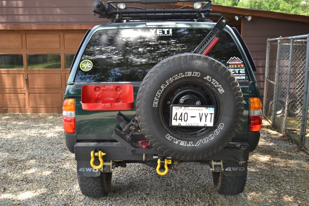

    What size HiLift is that? Is it long enough or does it near the end when jacking up your truck?

    It's the 48" X-treme. It comes close to maxing out. I think I have 4 or 5 "notches" left on it before the tires come off the ground. I should have gotten the 60" when I got my new one but the deal I got was only for the 48".

    Yeah, No problems with the 48" but it never hurts to have a little extra. I also didn't want to deal with the extra 12" hanging out above my tire on the back.
    Plus when I get my sliders built this summer, I feel as though I will be using less of the jack since they will be mounted quite a bit lower than the rear bumper. Good luck!

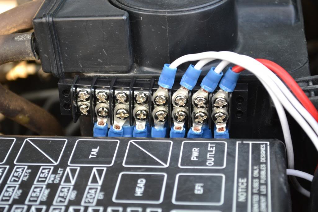

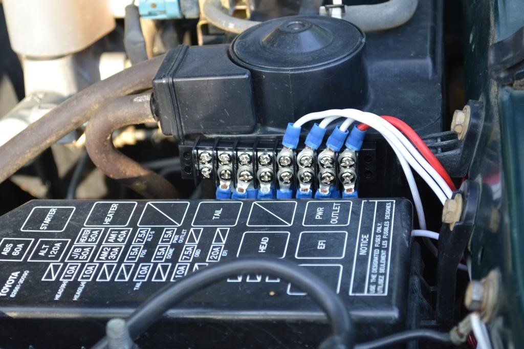

    Forgot to take a picture of this the other day but I cleaned up all the leads going to my positive terminal. I got tired of having half a dozen wires running to the positive post. So I borrowed TacoSkeet's "organizational" method and added a terminal block with 8 available posts. I only used 4 because I wanted to keep my amp hooked directly to the battery. Here is the end result:
    And a close up shot. Wiring this thing was pretty simple and I love the result.

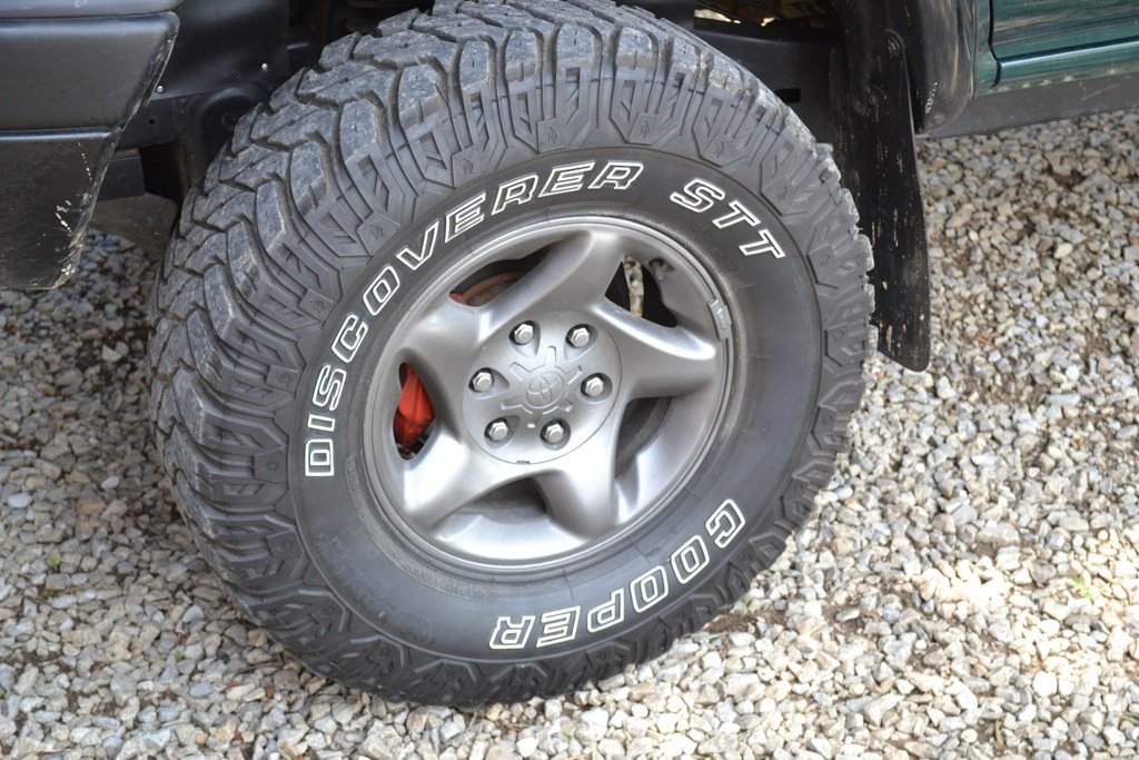

    Also got some new tires today. 285/75/16 Cooper STT. Going to get them mounted up tomorrow and then I'll update this thing. I realize I should have documented my CV swap but oh well, I'm sure I will have to replace another one sooner or later. Only mods I've done lately are redesign the Hi-Lift mount and lower the spare tire mount.

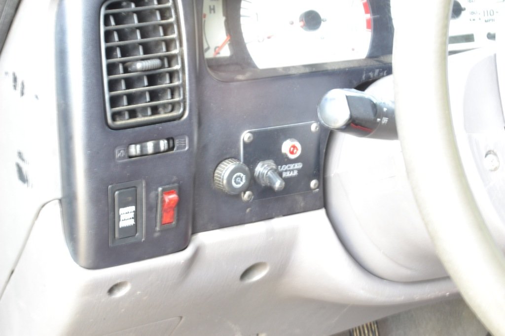

    Oh, also ordered a 12voltguy locker wiring harness so that should be in early next week. Then I'll be ready for my sliders, and back to the trails!

    ready to see those stt's on! oh and the locker wiring harness too, Ill be glad when I dont find you accidentally "locked" on the highway
