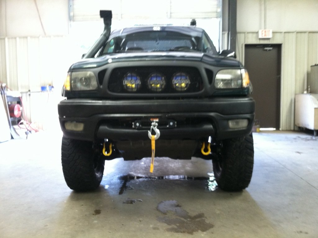

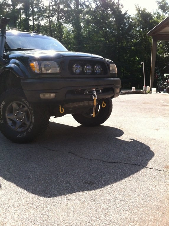

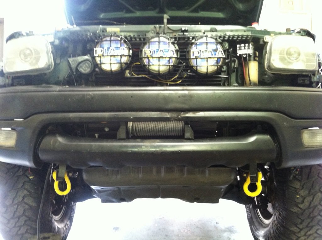

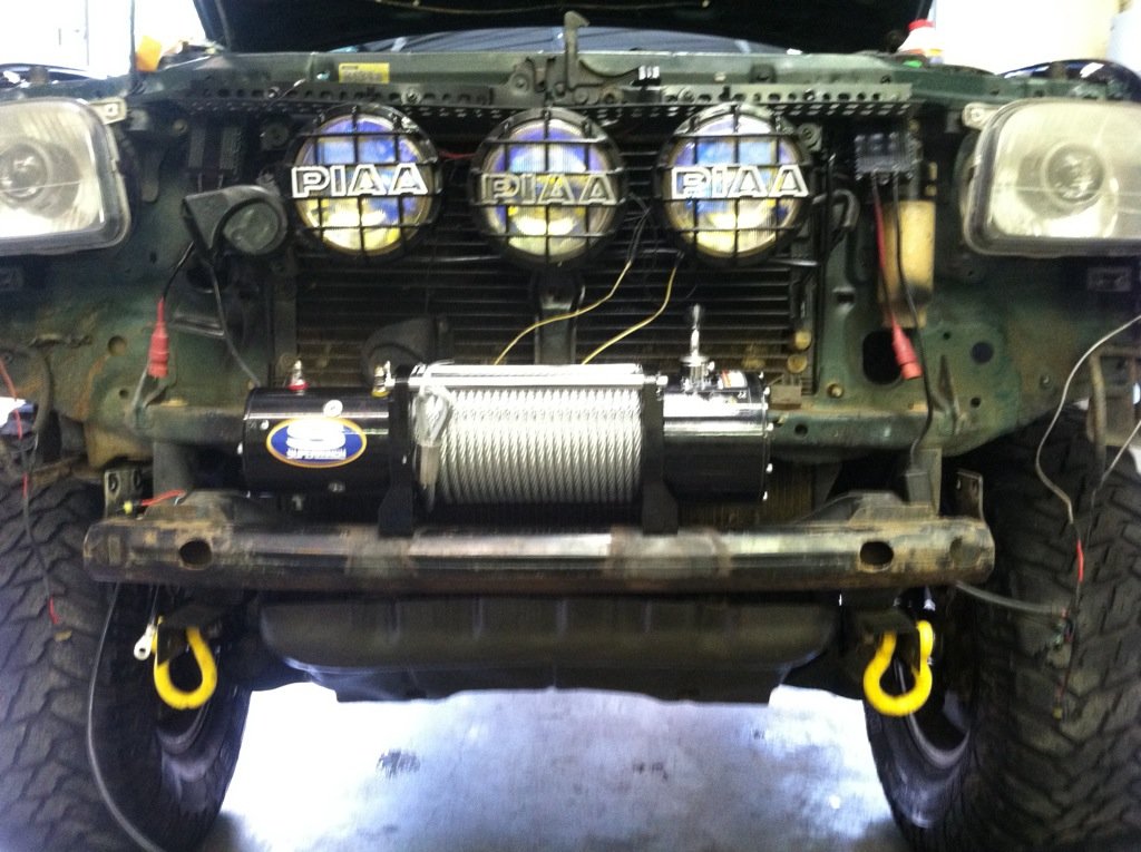

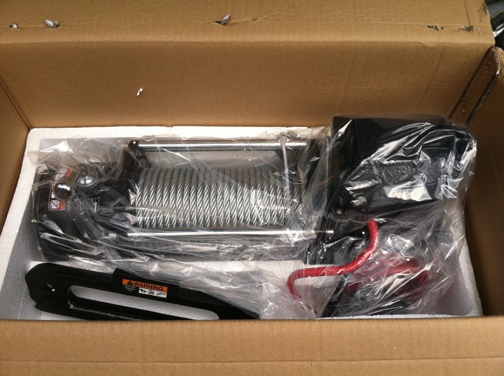

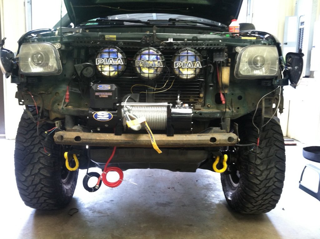

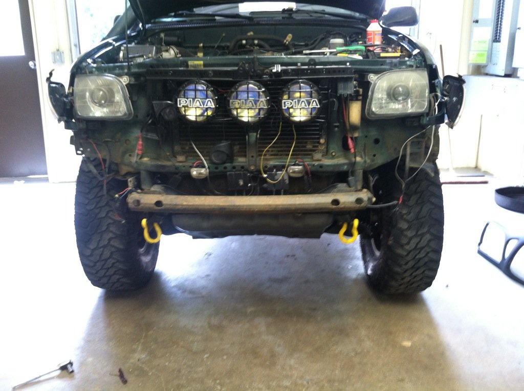

    Finally got the winch wired up and mounted. Just got a few more little things before I say it's "complete". It's fully functional and operational but just not 100% there. I need about 2 hours at the farm with a welder and grinder and then it will be complete. I love how it turned out though. Very well "hidden" and exactly what I wanted it to look like. Ended up have to relocate the control box and lengthen the wires between the winch and control box. Very please with the turn out.
    First opened the box:
    Bumper removal:
    Just kinda getting my gears turning and ideas rolling:
    Getting there...
    And all buttoned up...
    Forgot to add the pic of the LED dash mod but here it is too:

    AWESOME MAN!!!! the trucks a beast. it turned out great how u have it hidden in behind the bumper. looks like it fits in their perfect. did the only thing u cut is the pieces in the middle of the valence opening? thats what i plan on doing when i get a winch. anyways looks bad ass man good work.

    Yeah, I trimmed the lower valence a bit by removing the middle two vertical pieces/a little bit of the metal as well. Not too much trimming was needed, I obviously wanted to trim as little as possible to maintain the "factory" looks of the bumper. I trimmed just enough to clearance everything. Thanks. Appreciate the compliments

    How do you have the winch mounted? I hope you have more than just the flimsy front crash beam. That thing is held on by just a couple bolts and those aren't very secure.
    Love the stealth look but make sure that thing is mounted on some beefy material directly on the frame before you ever use it.

    Currently the winch is on a 1/4" plate spanning the gap between the frame rails. I still plan for about 2 hours of to welding will finish and button up all that. I have to add a brace behind the back of the plate as well as gussets to provide extra Strength. The only "pull" I've done so far is winding the cable onto the spool. Hoping to get a few hours to be able to button it up this weeked.
