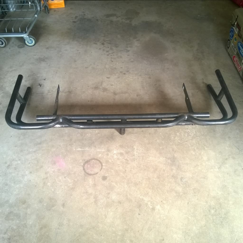

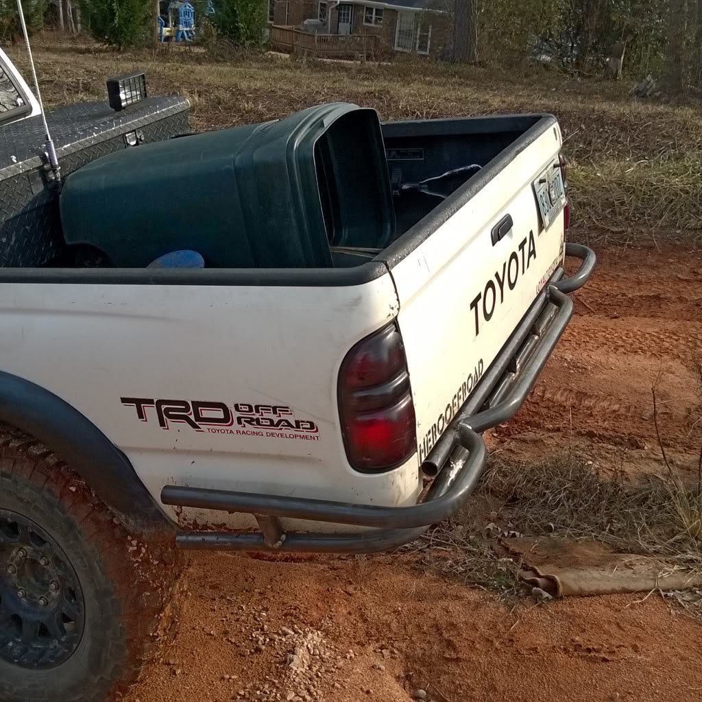

    Start of a rear tube bumper.

    That bumper kicks ass! Really like how the wrap around turns into part of the "shelf" in the rear.

    Thanks man! still have to add a hitch, some tube caps and some plate up top possibly. Then will get some integrated reverse lights via Blitzpro 6lz's.
    & Its high clearance as possible without cutting bedside!

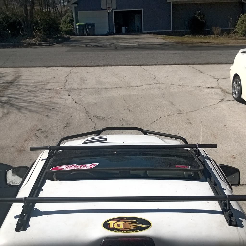

    Got my home made "Yakima" style cross bars into the T4R tracks today after paint dried last night! Way heavier duty than the factory crossbars

    So I figured I'd bring our convo to a more appropriate place. My bedsides are already cut so that's not an issue. I'm wondering how you would tweak the design for a true high clearance bumper. Not sure how it would work with the upper and lower tube. Wanna draw something up?

    Id just not take the wrap arounds as wide as for non cut bedside.. just suck them in more towards the center of the tailgate then the center step wouldn't be quite as wide either.
    Move them in something like 1.5"-2" since as of now they sit around 3/8-1/2" away from bedside as is and material is 1.75" so move in 1.5 should leave you a little sticking past

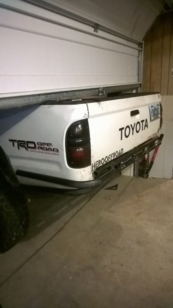

    A little late but bumper installed with reverse lights mounted and wired up.
