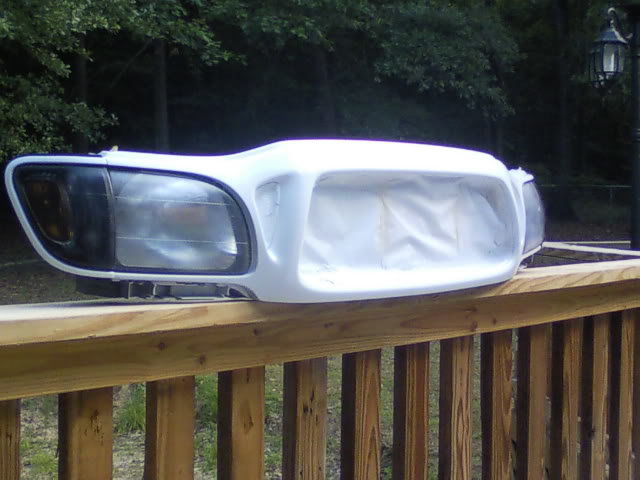

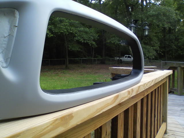

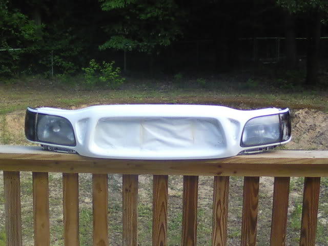

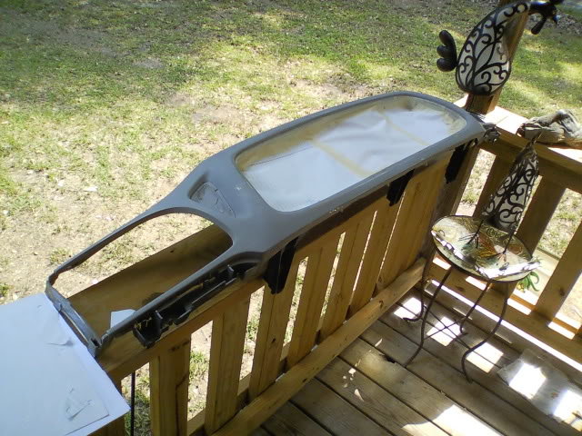

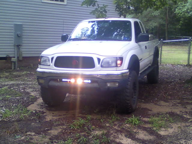

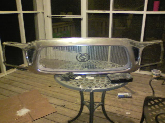

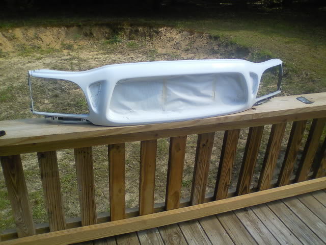

    1st Gen Satoshi anyone?
    start by getting all the chrome and bars off the grill surround.
    Just mocked up of how it will kinda look in the end...

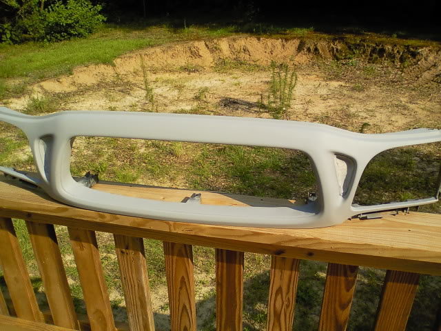

    fiberglass, bondo & sanding primer done:
    First bit of paint layed down:

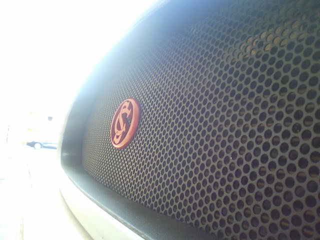

    Mesh painted and installed:
    Still have to paint he surround obviously but just havent had the time to find the right white to colormatch it to the truck.

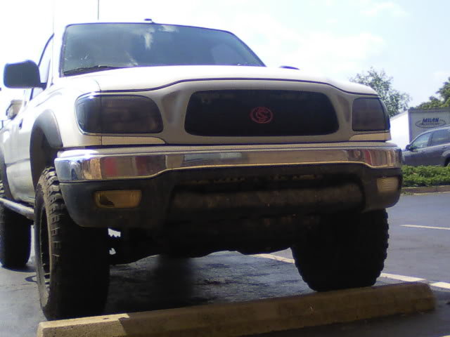

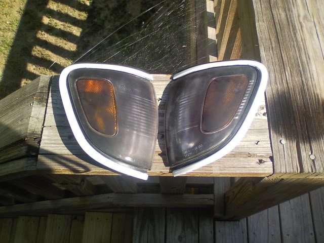

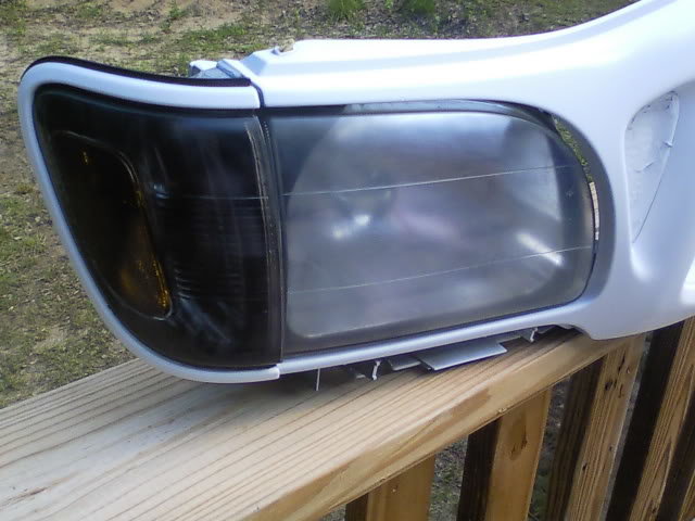

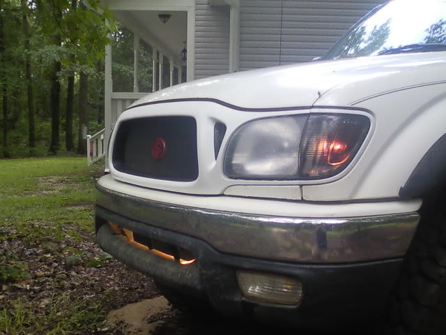

    Finished up and painted satoshi grill mod:
    starting out by sanding down the primer with some 400 grit wet sand and taping off the mesh and everything i wanted to keep black.
    then i taped off the corner lights to paint the chrome strip around them white as well. While i was at it i went ahead and sanded a good bit of the black VHT off them to make them a little lighter and cleared them and the white at the same time.
    painted surround:
    Mock up of clearead surround, corners, and i also did a Headlight resto for free to get the spotty VHT off:
    & all finished up!
    everybody knows what these things look like stock so no need for a before and after but it was deffinatly worth the 40 bucks and 2 days time i spent on the whole project.
    I think it turned out great and i actually surprised myself with the painting especially when you take the time to sand and prep before you paint! I shouldnt have to mess with this thing for a good while!
