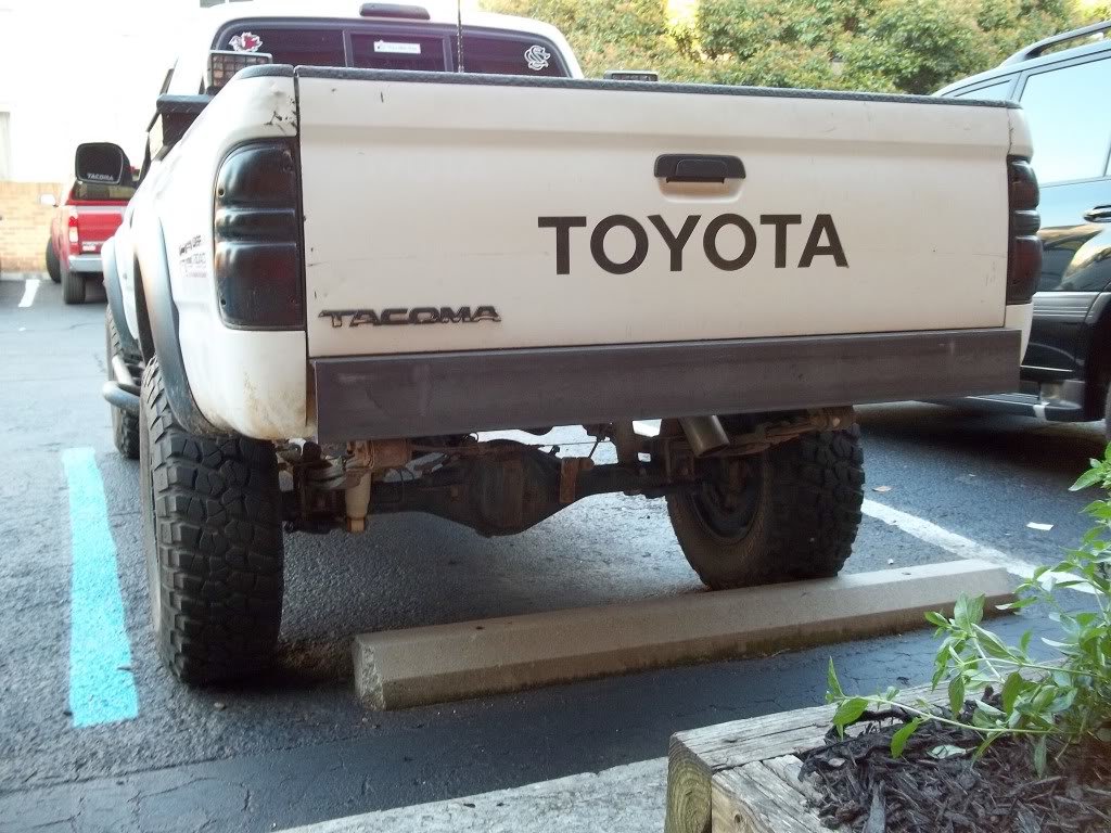

    Look at build!
    Owell, cant complain with pricing of these guys and they are doing the work minus me cutting and disassembling everything out... Ill let them do all the geometry and welding so its not a hack job

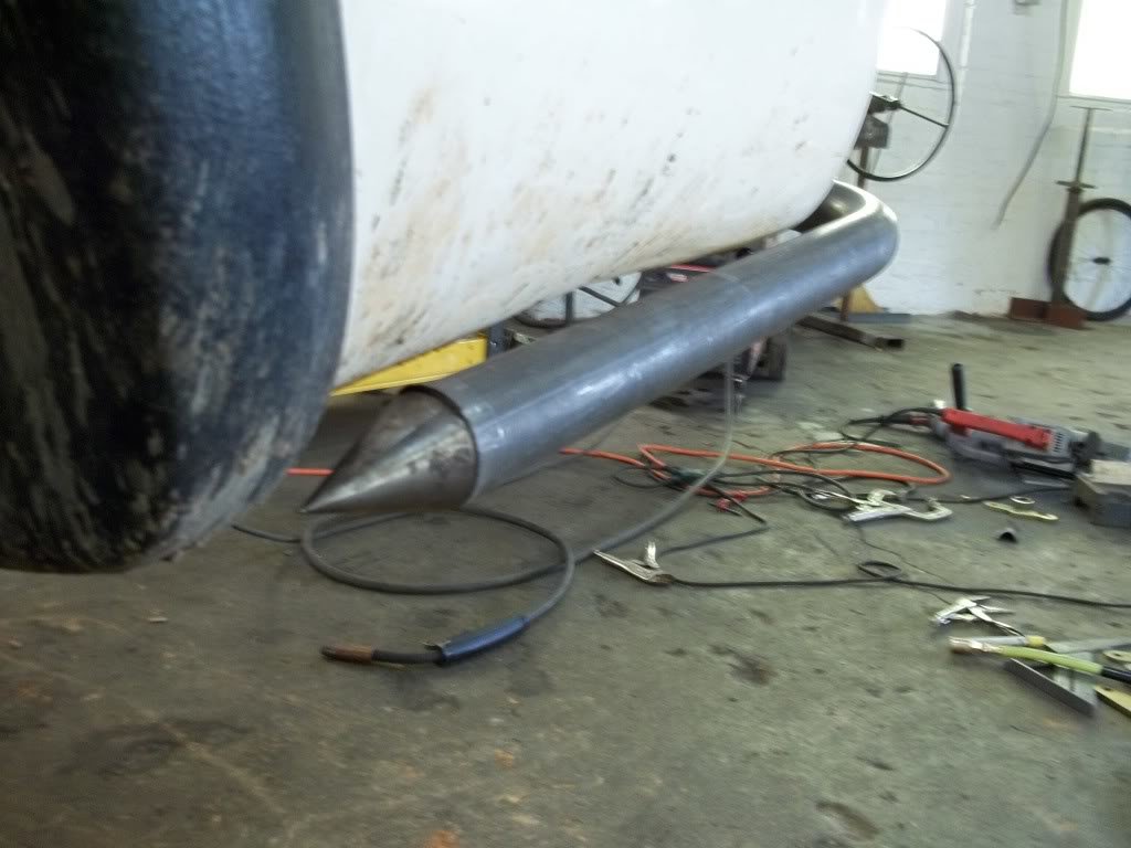

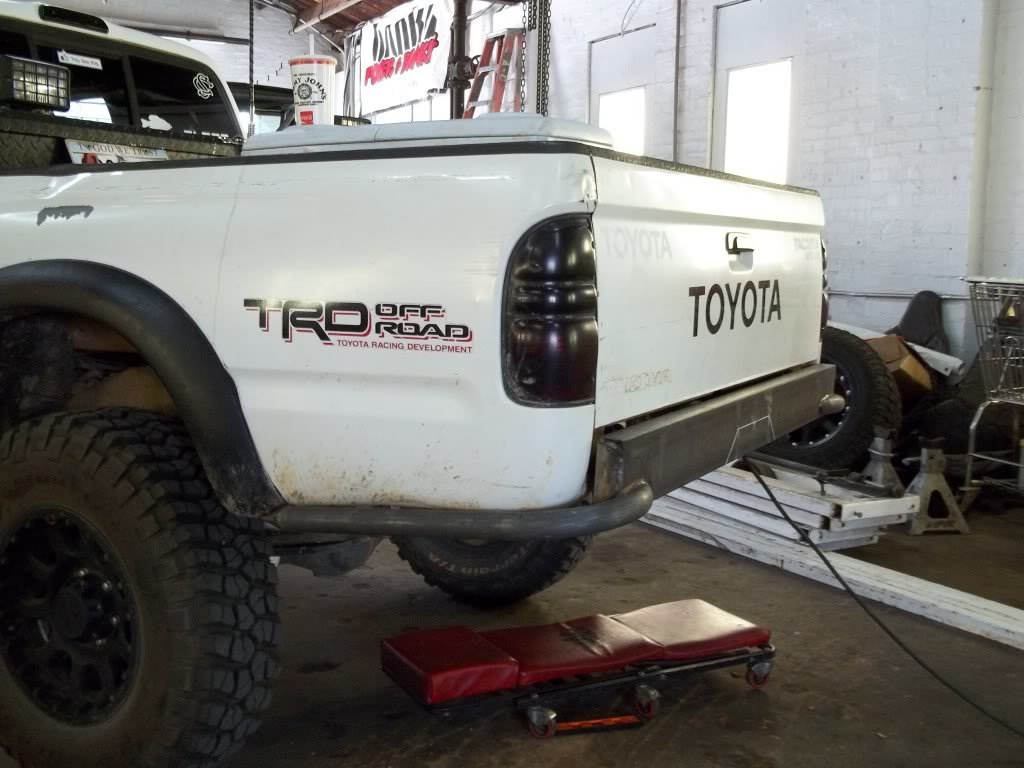

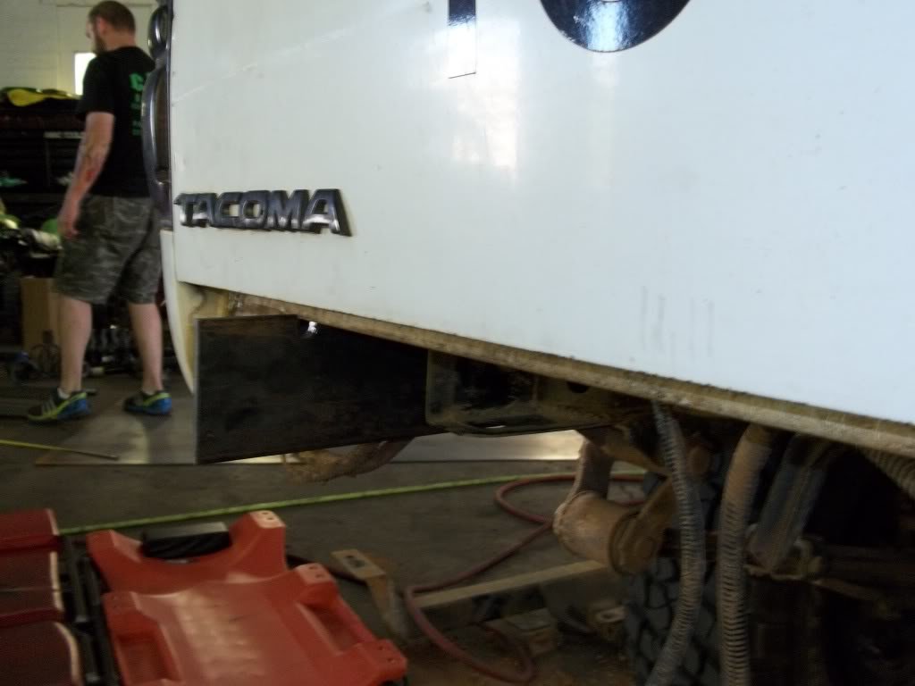

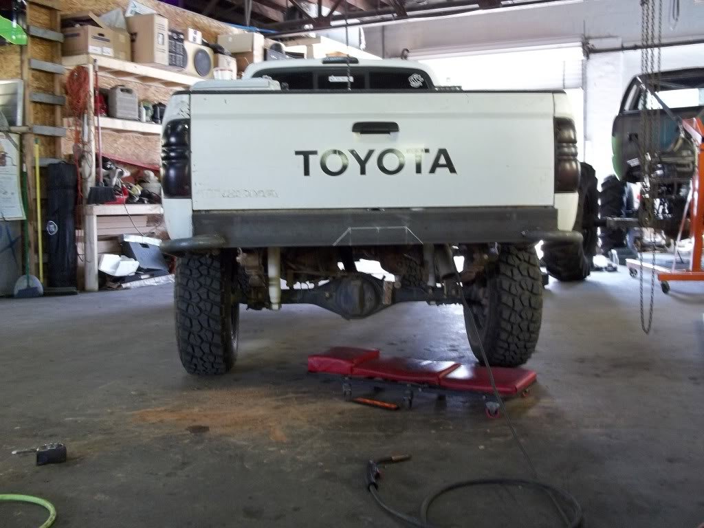

    Yea got started kinda late and just got the main mounts from fram and rectangle tube mounted and tacked to the frame mounts the first day then came back and caped the ends and got the main bottom tube on, going back tomorrow for the upper tubes that will come off the bottom, got them bunt and coped just got to make the passenger side one and weld it u then put the hitch reciever in and the D-Shackles and it will be done.
    Helluva lot more high clearence than stock with the hitch under it...all in all i gained around 6" extra clearence.. it looks a lot higher now too
    :D
    PICS:
    Naked ass:cool:
    1/4" mounts, this was just the beginning, we also ran another piece on the bottom of the frame thats welded to this piece and its all bolted up to the stock bolt holes using 4 bolts per side
    Got this far first day:
    Capped ends and downtube:
    Kinda an idea i found laying around the shop, thought it looked kind of cool on there but still undecided if i want these or just to cap it off... thoughts??
    And for shits and giggles... stinger anyone :D
    Should have some more pics tomorrow, all in all there is only around 2.5/hrs into it so not to bad, just been slow working on it and working around it to do other customers gay body lifts:eek:

    looks great. id leave the caps flat

    Hows about those pointed end caps, i torn between those or just a rounded one on both sides
    Tacomarotto: I think im going to do the rounded ones instead of it just being flat like everyone elses ya know

    Looks great! Reminds me of Box Rocket's bumper. The caps don't look too bad but personally I'd pass.
