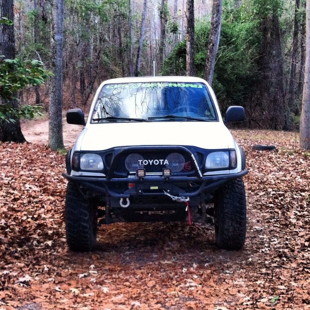

    Another pic of the temp mounted square led lights.

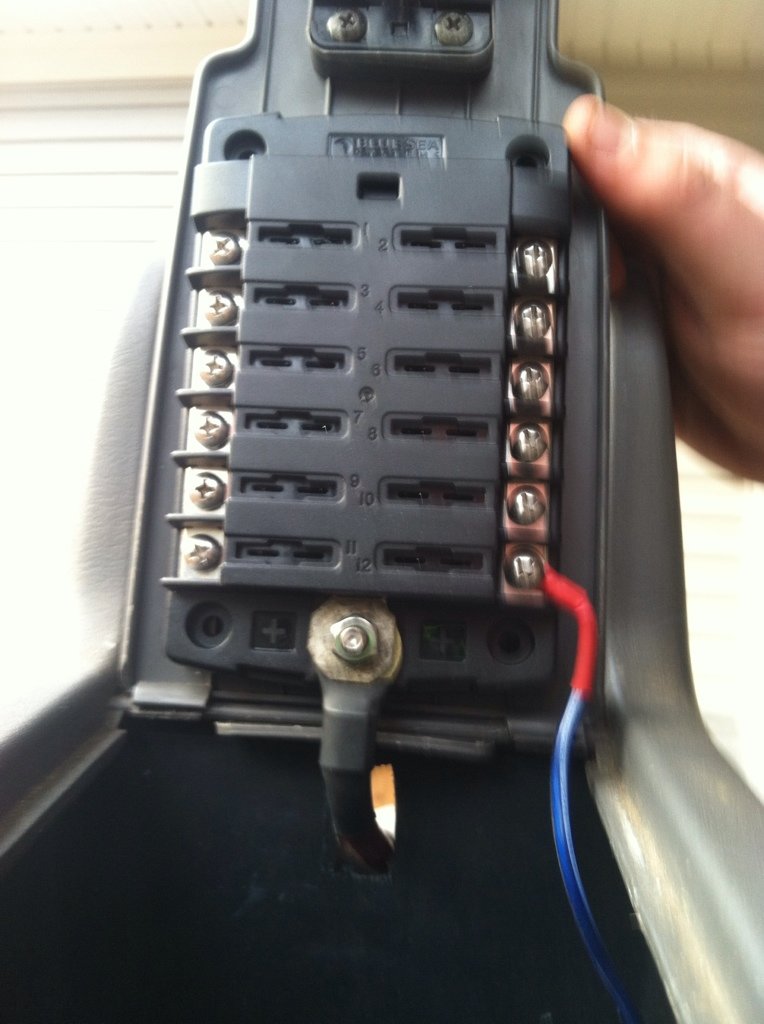

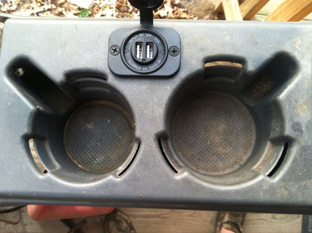

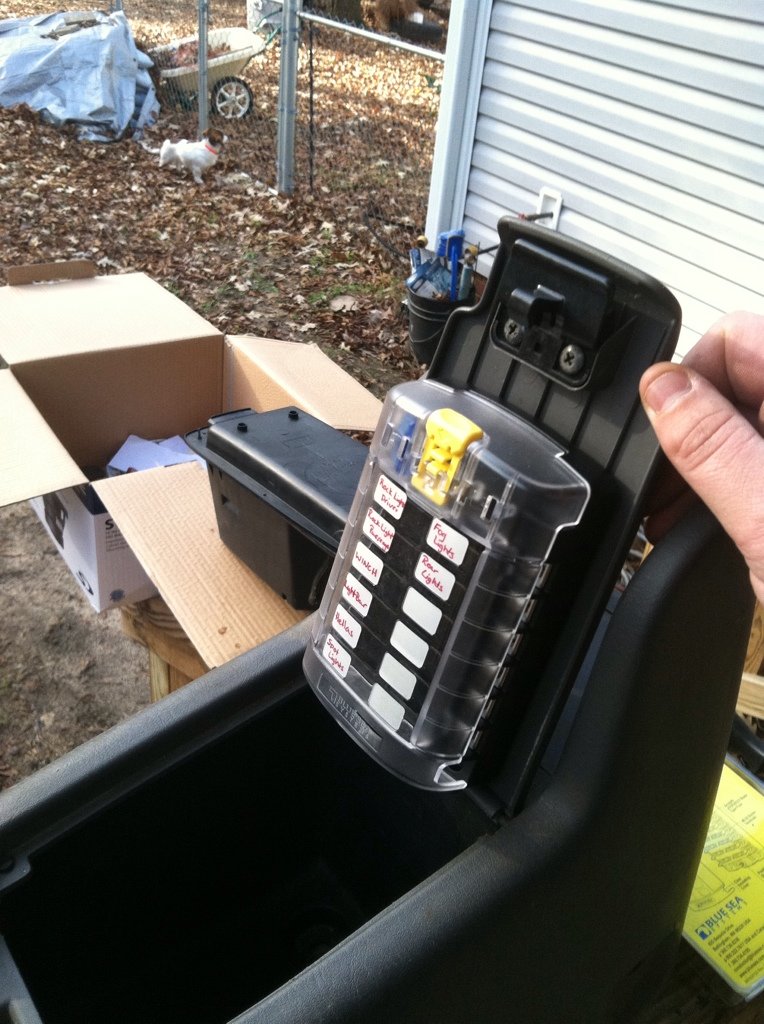

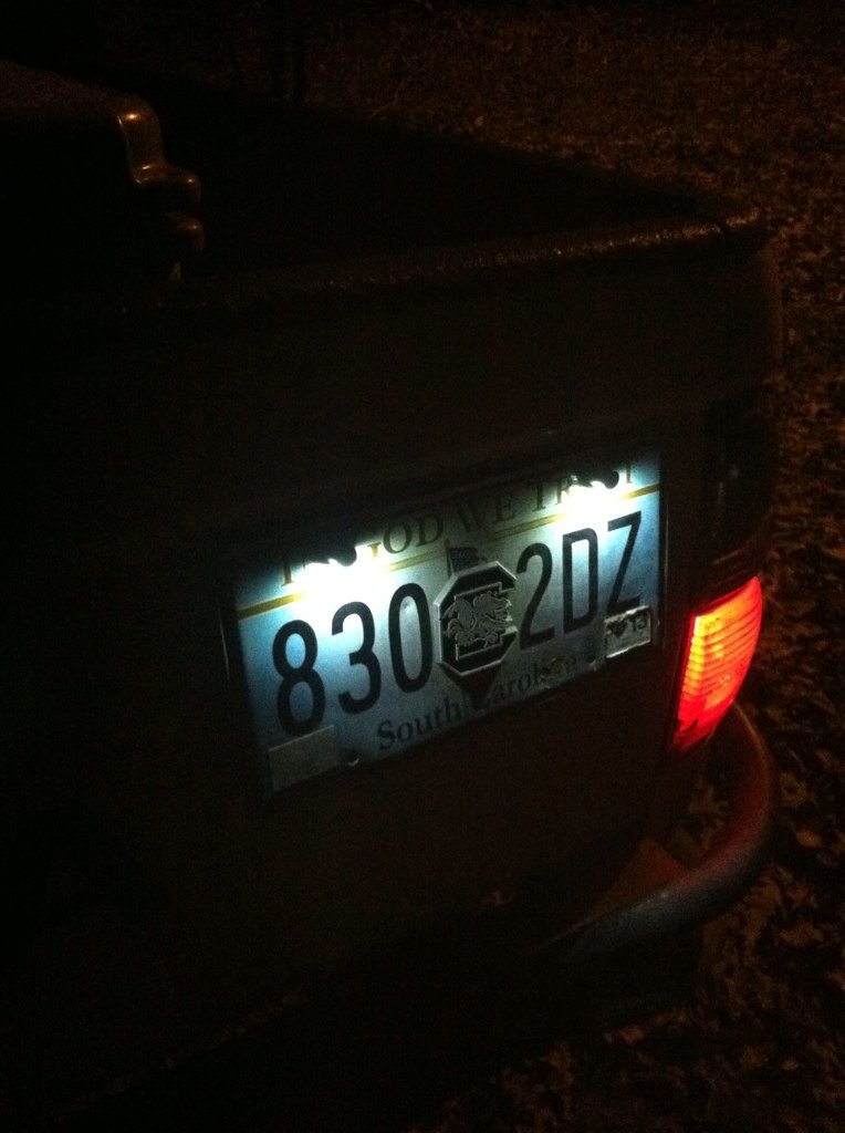

    Blue seas fuse block/USB power port & new un ghetto tag light/mounts.

    Man im jelly of your USB charger and tag lights!

    Gaha thanks man! Getcha one off Amazon, $10! Still gotta wire it and many many other things up before you come down.

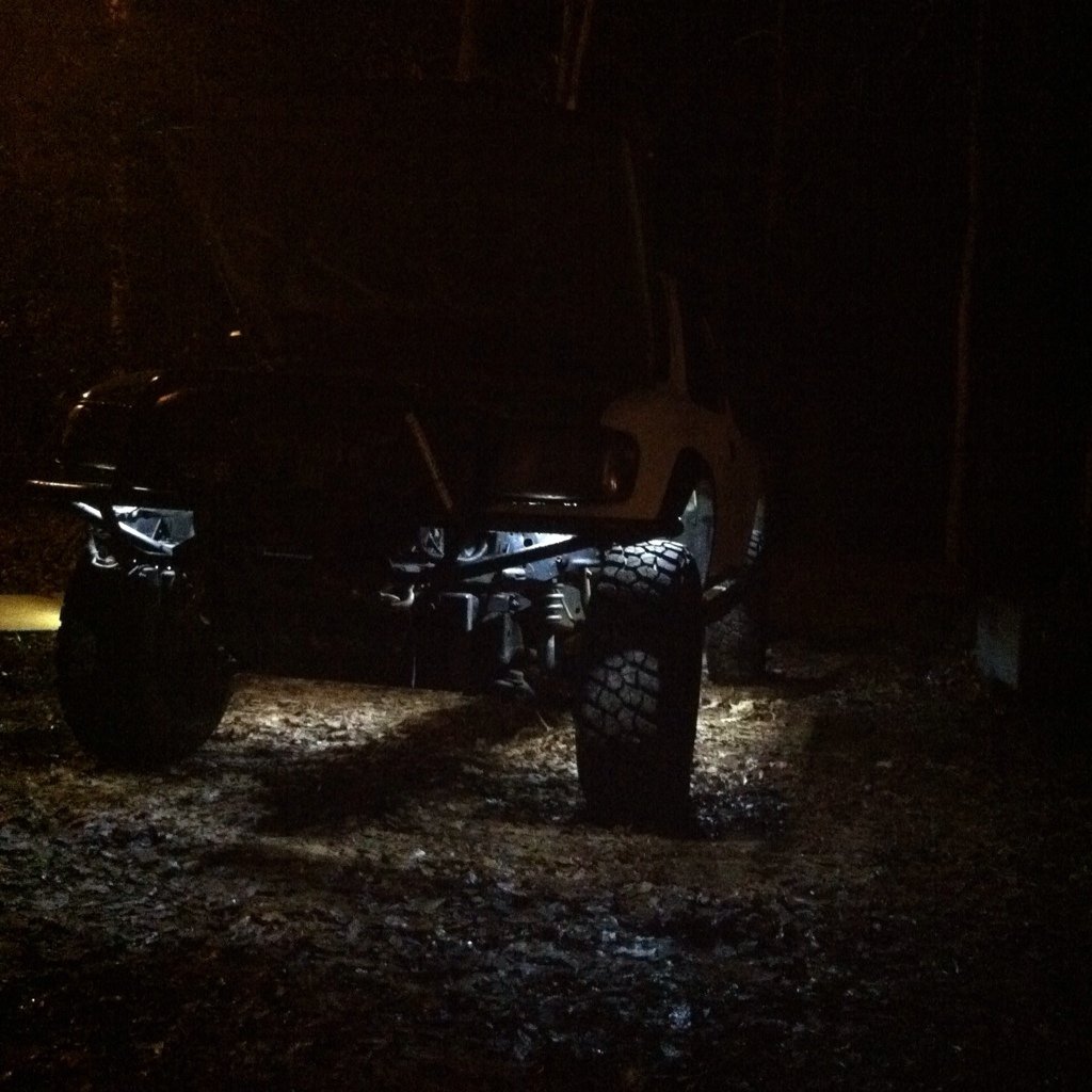

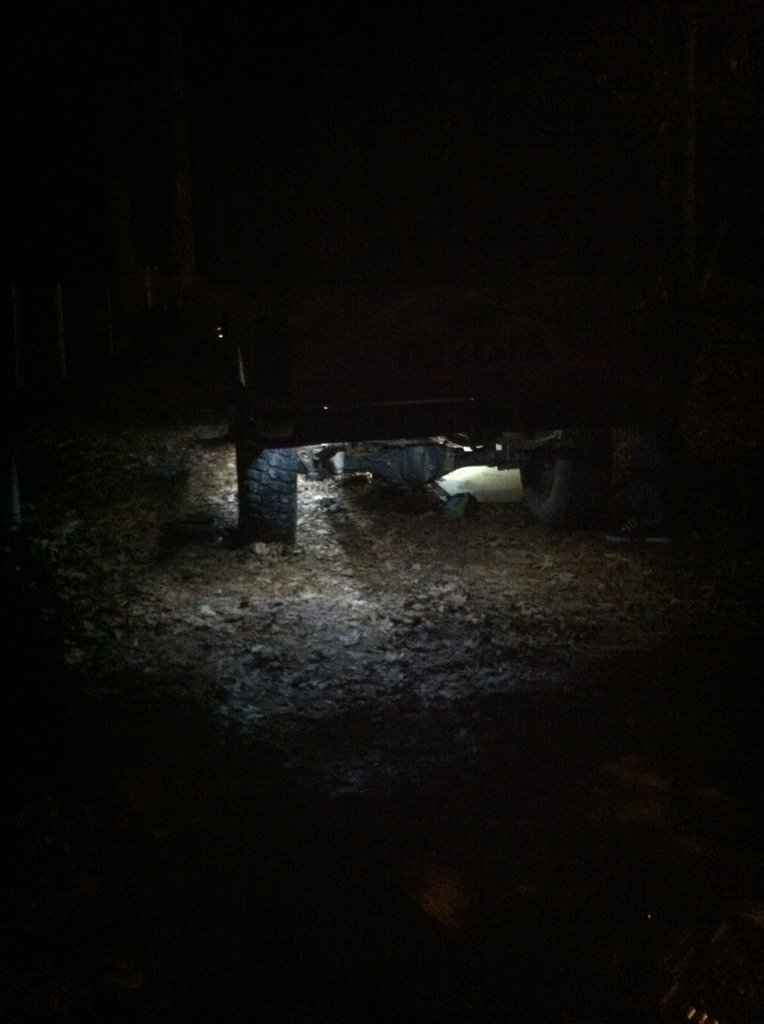

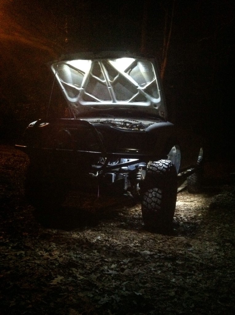

    Some rock lights finally getting somewhere...
    6CC88FF6-164F-4503-A2D9-3552B703AB93-378_97c3c3e7f97f6246c95d65c97a15283fff2e720d.jpg
    D6EA05BD-9A3A-4E8E-AE55-7E6870F49CFF-378_b019b798f1144801f2e420b0a0d009500c566952.jpg
    EB7E295C-D0C4-4E86-BFC6-E412100287C2-378_d914928154456c804f9492dc1aa2b5f6dd99f650.jpg
    Still got about 5 to go on the passenger side and I can finally call it done!

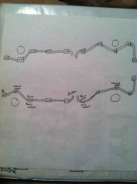

    What configuration do you have em in and what type of lights?
  18. Jan 2, 2013 at 12:28 AM
    #1138
    01Tac0ma
    01Tac0ma [OP] Bash Fabriction & Off-Road
    Jun 11, 2010
    #38782
    6,304
    Chad
    West Columbia, SC
    SAS 01 TRD 4x4
    Look at build!
    They are from Horsepowerjuice.com
    And I have driver side on one switch and passenger on another. Used 3 separate grounds.. Basically power from switch to first light midway on the cab which is grounded then strung together towards the front with another ground on the light nearest the headlight. Then another strand from the next spot back from mid way towards the bed 8 know that first one is located inwards directly in front of the rear most cab mount then run up into fender in front of rear tire, then to inner fender, then to behind rear tire and then one 3 rows in towards the center of bed but as close to tailgate as possible... Hopeully that makes sense.. I you want I can draw out a pic of placement or go take pics
  19. Jan 2, 2013 at 12:46 AM
    #1139
    01Tac0ma
    Jun 11, 2010
    #38782
    6,304
    Chad
    West Columbia, SC
    SAS 01 TRD 4x4
    Look at build!
    Obviously not proportional but you get the idea. This is only 20 as well, the other 2 I'm debating will be in the center of the bed and another up front somewhere if I can find a spot to get rid of that dark space down the middle of the truck. & I'm sure once the passenger side is completely finishe it will look much better and complete plus being on top of leaves doesn't help the brightness much either cause believe me, they are bright! I actually just left them on while I was working and was able to use the light they gave of to finish the rest!
