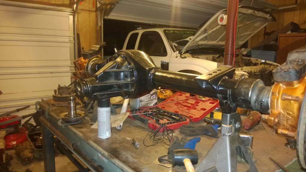

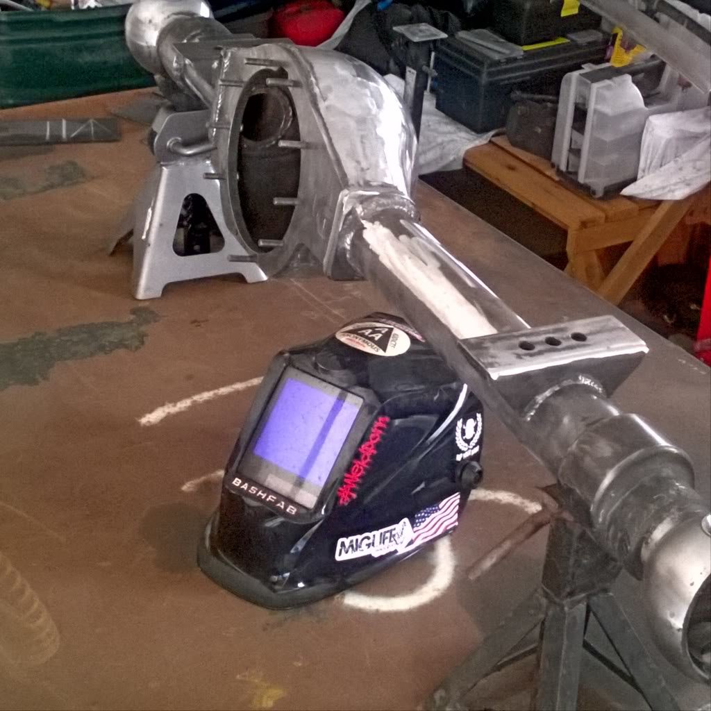

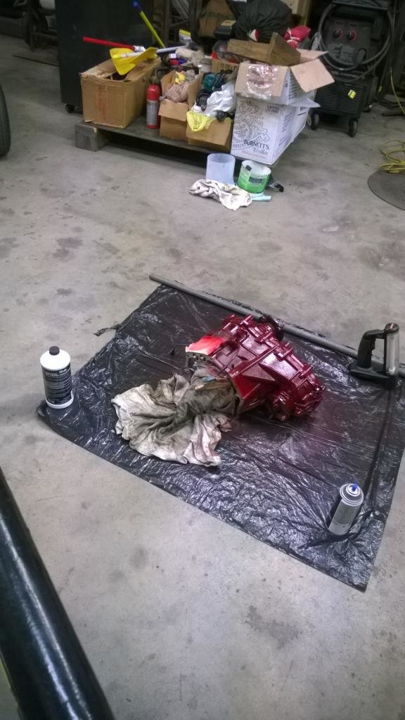

    Well I finally have a few updates.

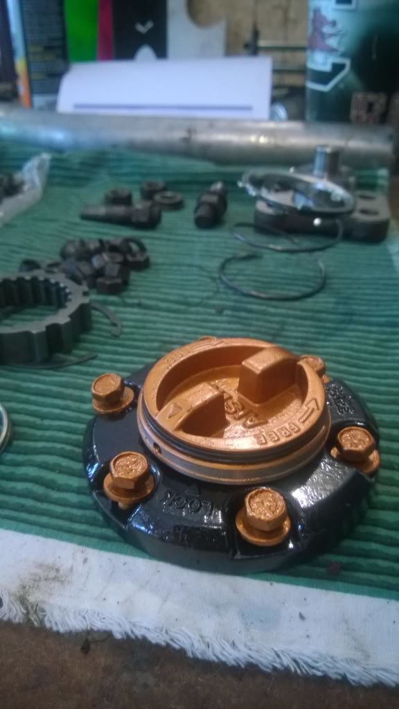

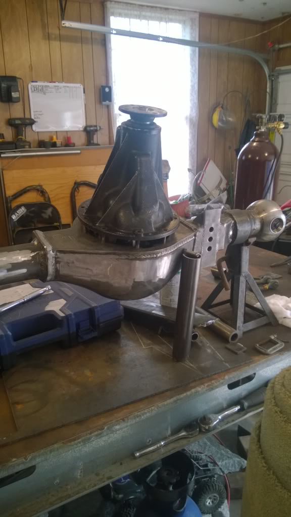

    Got around to some slow time and pulled the axle apart to find some unwanted news.. fluids had been drained (no big deal) but the guy who had it before me had it stored outside apparently and first clue I found was some rust splotches on the axle shafts as well as water beads so I got the 3rd out and its rusted up pretty solid..
    So.... I got the housing all shined up and clean, cut the old TG truss that was crooked as hell on the axle off an found a new 3rd with already installed 4:88's for $250 from Rustys R&P. Picked it up and finished cleaning the knuckles and birfs and found all the kings and seals, felts, tie rod ends, ubolt flip, spare brake lines etc locally as an overstock so going to pick all that up soon as well and hopefully get a new sheet of plate to get a new truss built.
    Still planning to be leaf sprung for now and will likely run glass front shaft for a little while as I wait on the taco box to get here ( no point I doing shafts twice )... but hopefully wont be too far down the road.
    As of now only things I need to start cutting are the pwr steering hose conversion, steering shaft, rear 4:88 R&P, most likely new pwr steering pump but not needed right away.
    anyway heres a few pics

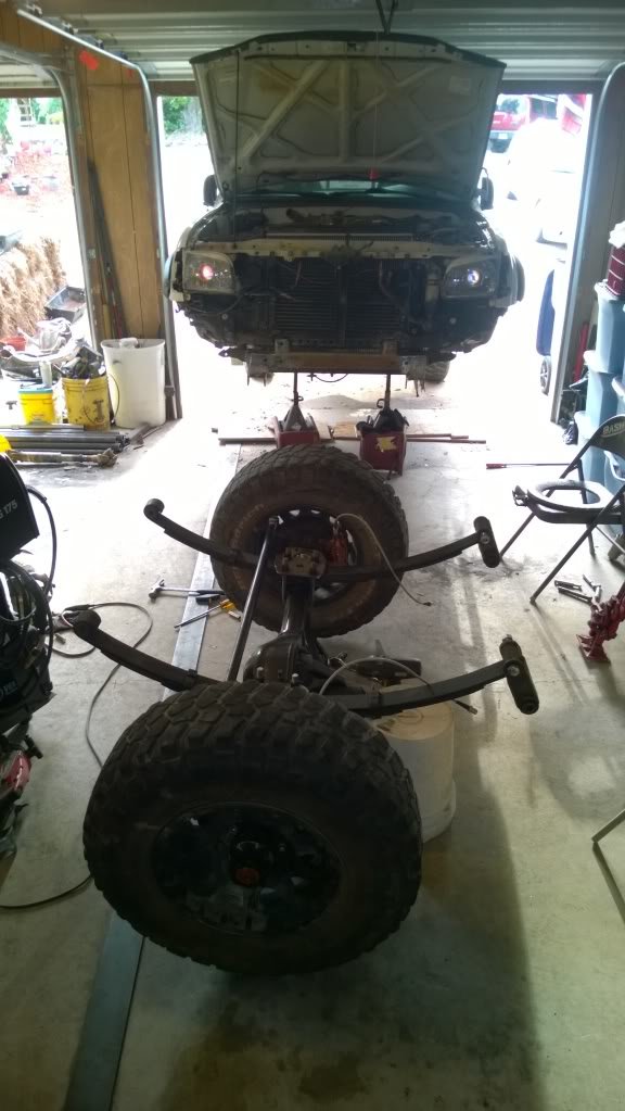

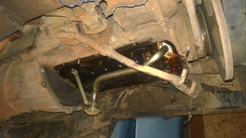

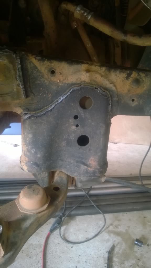

    Well I finally took the plunge and started cutting.
    Plan was to start Monday but unbolting IFS components Friday led to another and well the ifs fell off this afternoon after my plasma decided to take a shit so I had to use cutoff wheels :mad:
    Anyway, All ifs components and brackets have been removed along with the radiator. Swapped oil pans and pickup tubes and got the axle 2/3 the way assembled. Grinding day is tomorrow and will hopefully get all the excess junk off the frame and cleaned up and start tacking hangers up and into place.
    Few pics

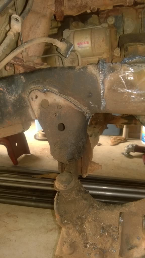

    Got the passenger frame rail cleaned, body mount cut and jig in place, front crossmember and frame notched for the front hangers around 1" into the frame and most of the passenger frame rail clean.. No plasma so cutting the coil bucket is taking its toll with a cutoff wheel but once that sides done it should be pretty smooth sailing.. I hope.

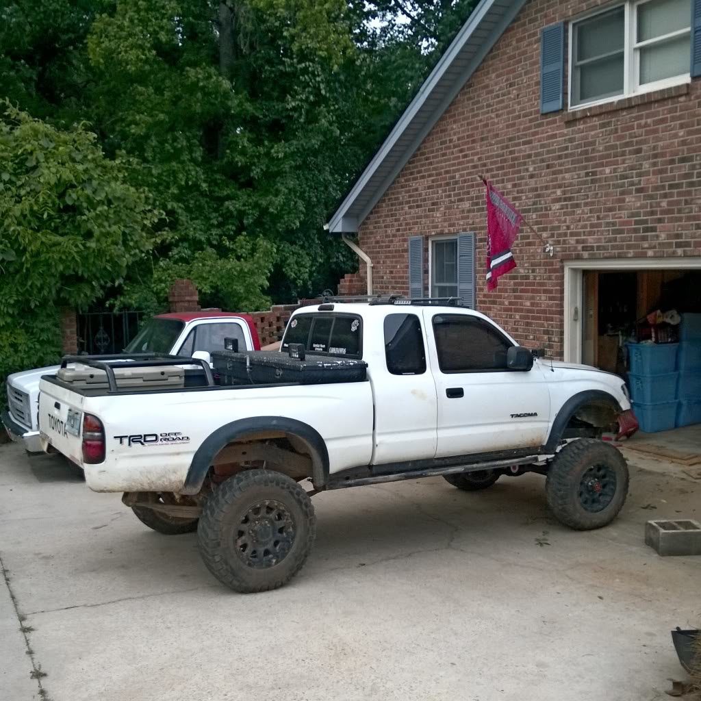

  17. Aug 17, 2014 at 7:58 PM
    #37
    01Tac0ma
    01Tac0ma [OP] Bash Fabriction & Off-Road
    Jun 11, 2010
    #38782
    6,304
    Chad
    West Columbia, SC
    SAS 01 TRD 4x4
    Look at build!

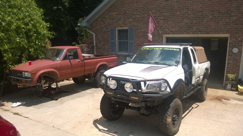

    Guess its about time I update this poor left out like an abused dog of a thread... Looks like I left everyone hanging mid grinding day... woops :eek:
    Well I don't have very many pics from grinding and setting everything up etc but ill dig up what I have.
    Heres the closest I have.. basically everything is in place at this point.

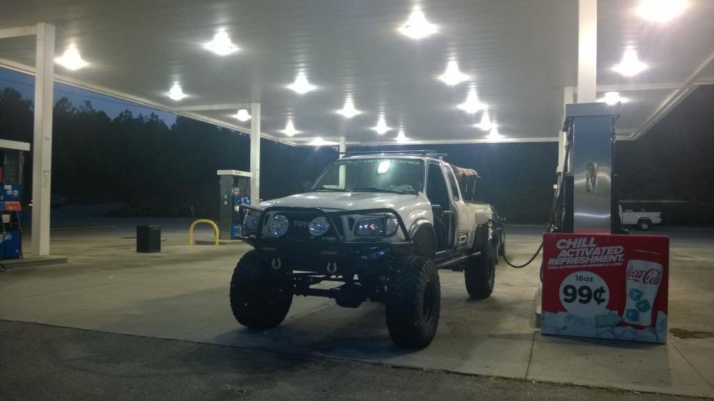

    I ended up not using the front TG hangers and instead went to the plasma table and cut some new hangers out that moved the leafs forward about an inch as well as up as far as possible to go along with the hangers being frenched into the frame about an inch. I already had the addicted offroad front bumper which uses a crossmember that welds over both frame rails so I cut it off and started notching it for the new front hangers.
    First time under its own weight
    The new radiator that's supposed to work for SAS didn't sit down far enough due to the front hangers being pushed up into the frame so I got my hands on a smaller 22re radiator and made some custom mounts for it and went for a test drive.. sure enough worked perfect and never got any hotter than before with the stock radiator.. so I let it ride for now and its been goo upto now! (So if anyone needs a brand new radiator I have one as well as my old one that has a very small slow leak)

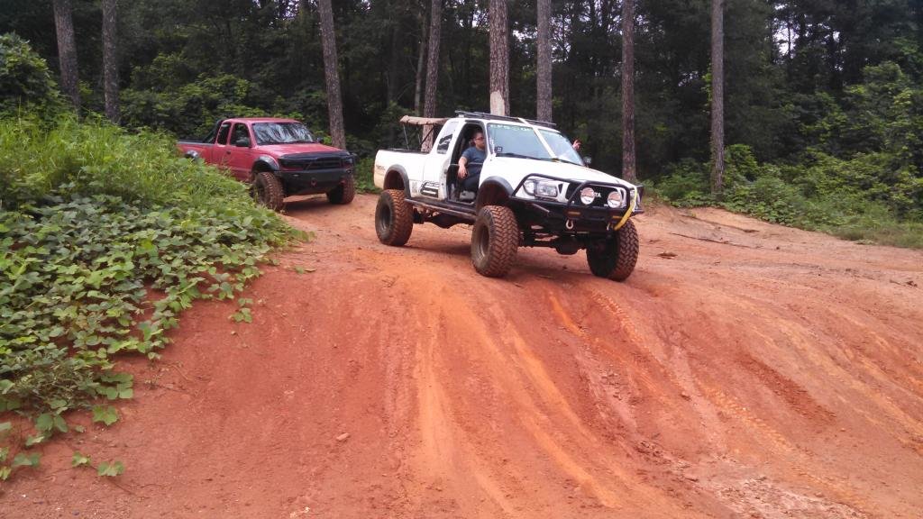

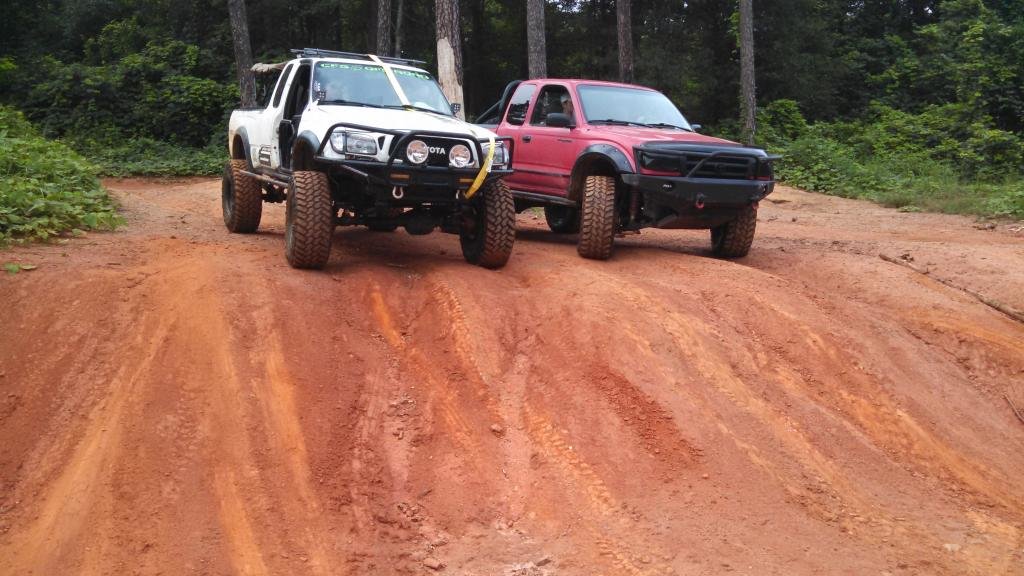

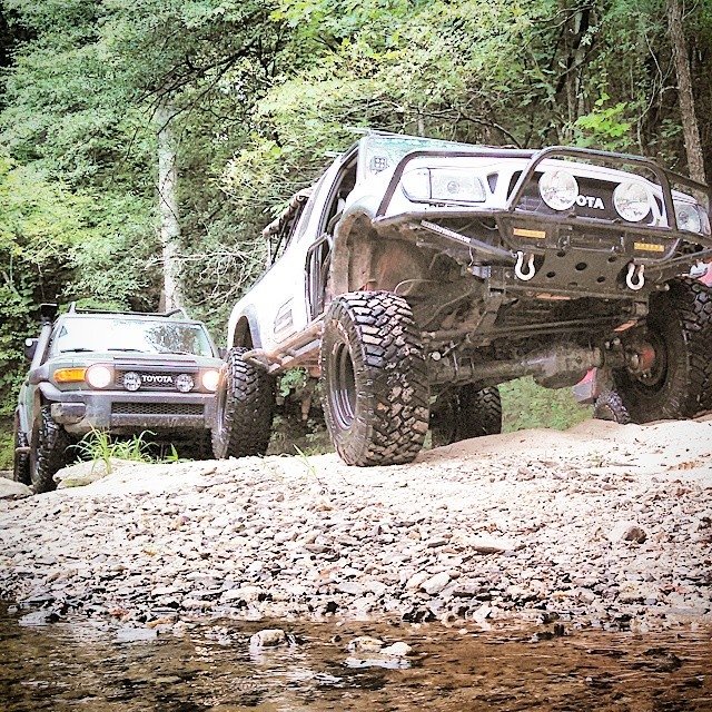

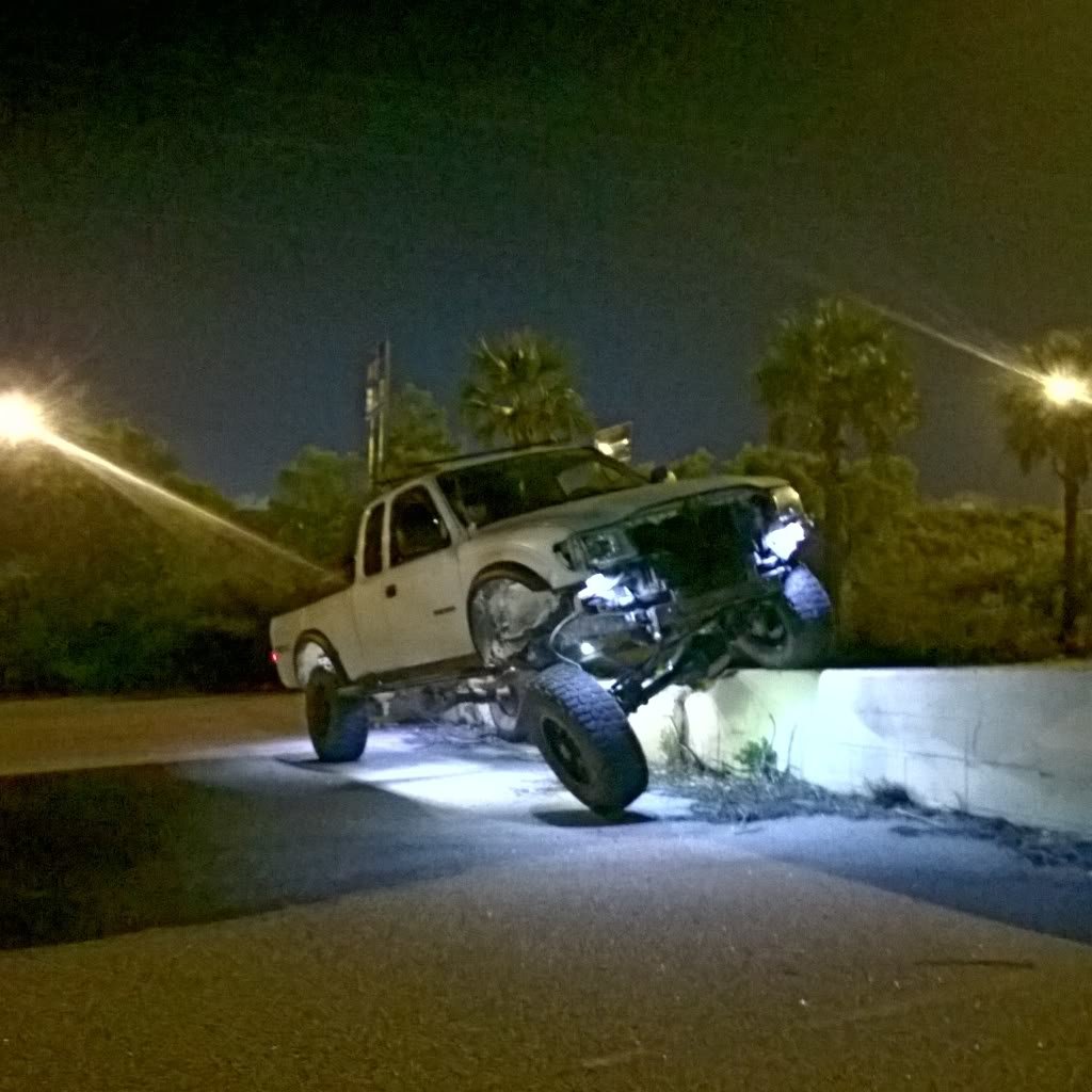

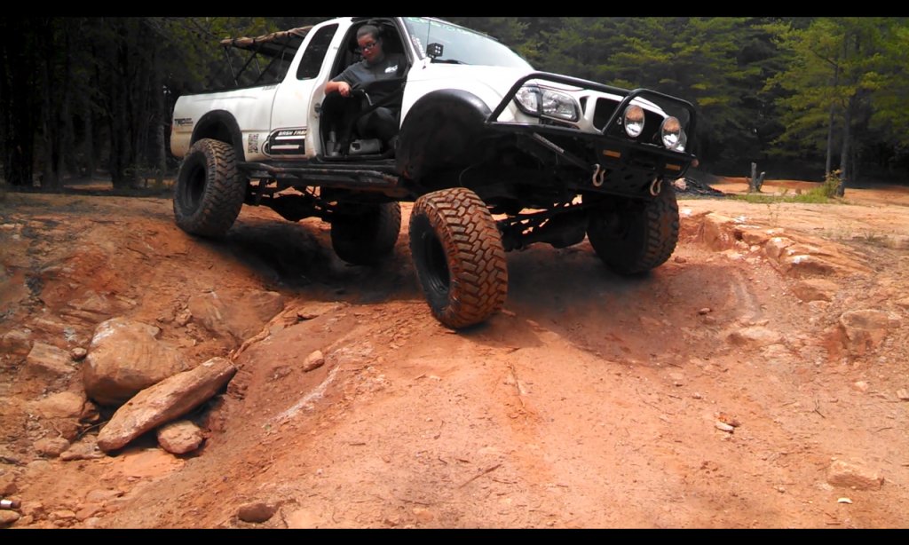

    first flex pics

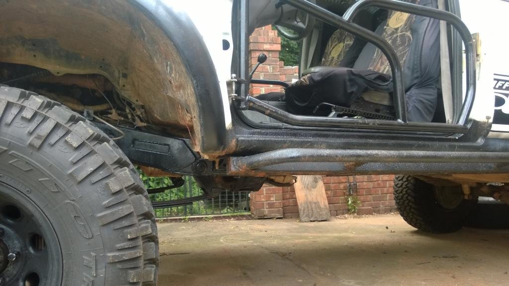

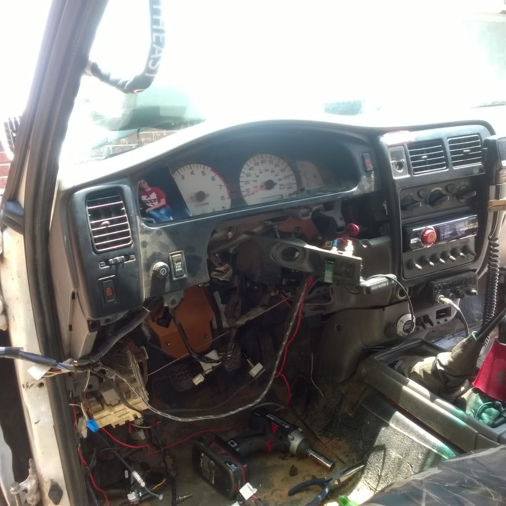

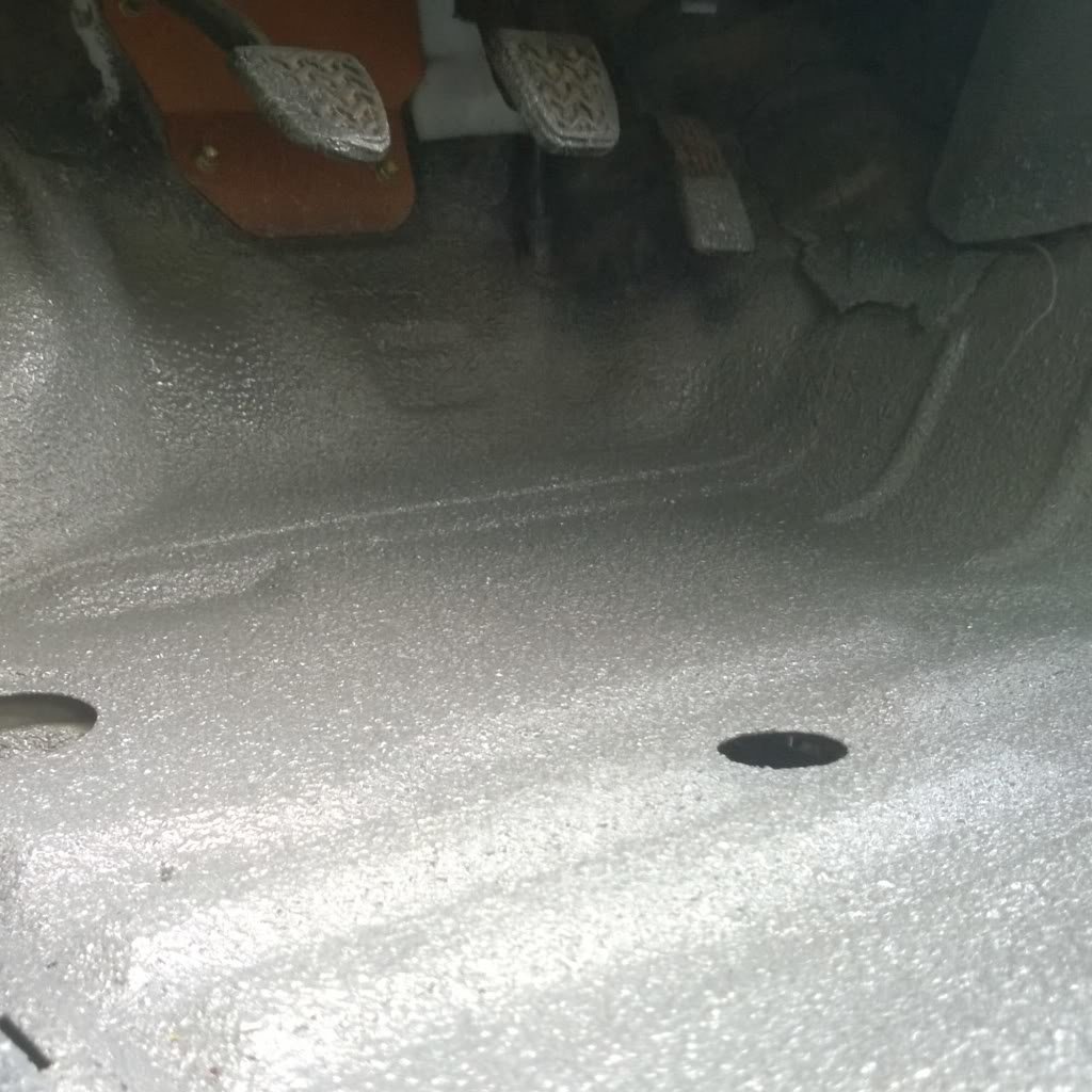

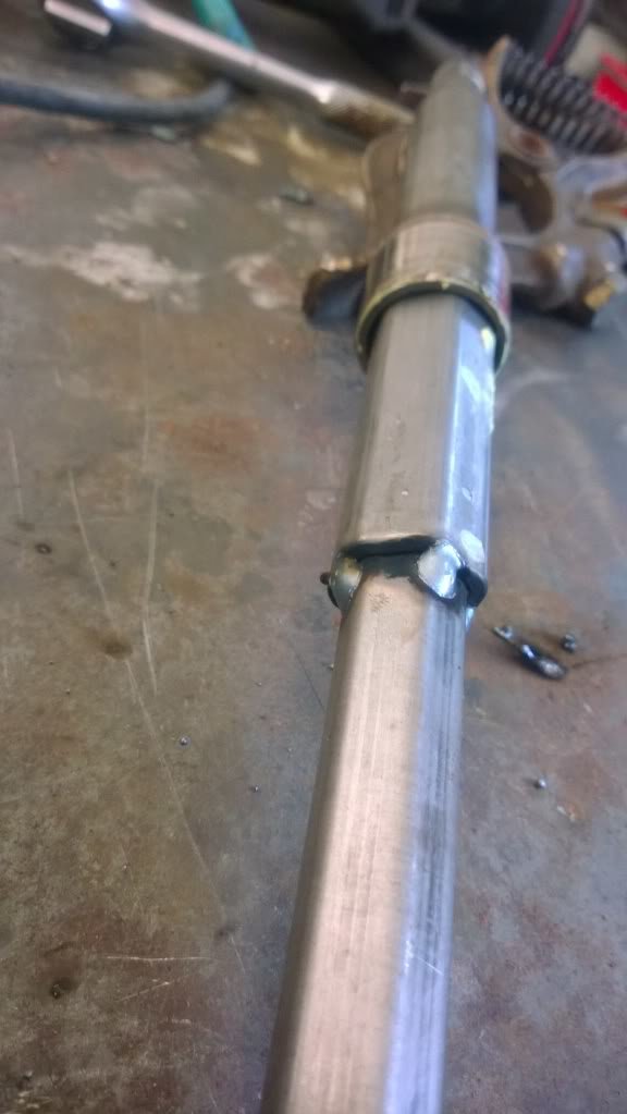

    Still had slop in the steering wheel and the annoying steering wheel clank when going over bumps so I pulled the steering column and took it apart to tack the slide together in the middle of the column

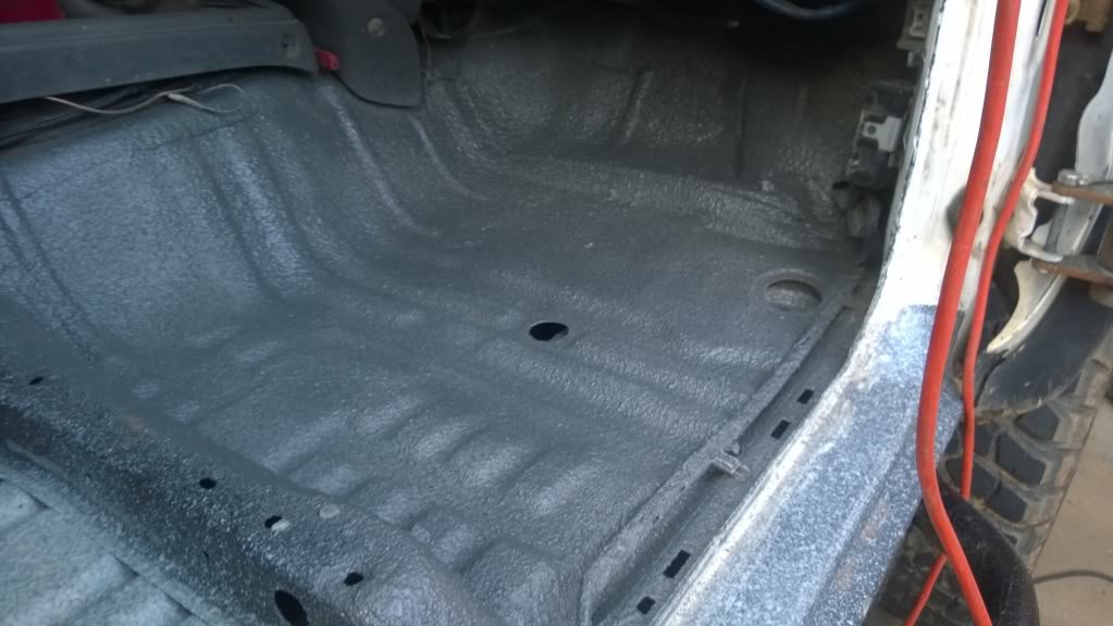

    Also cleaned up the spaghetti mess of wires under the dash and re bedlined my floors for good this time

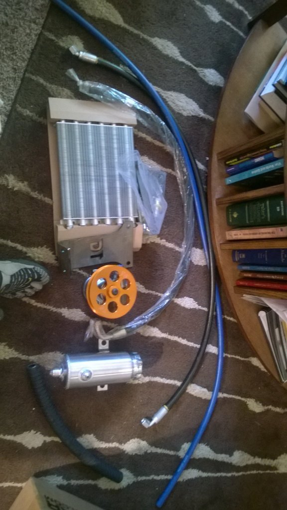

    at this point everything sort of came to a stand still since my stock power steering pump had finally bit the shit after whining for a year or so now so I parked it while I waited on the TG PS pump to arrive.

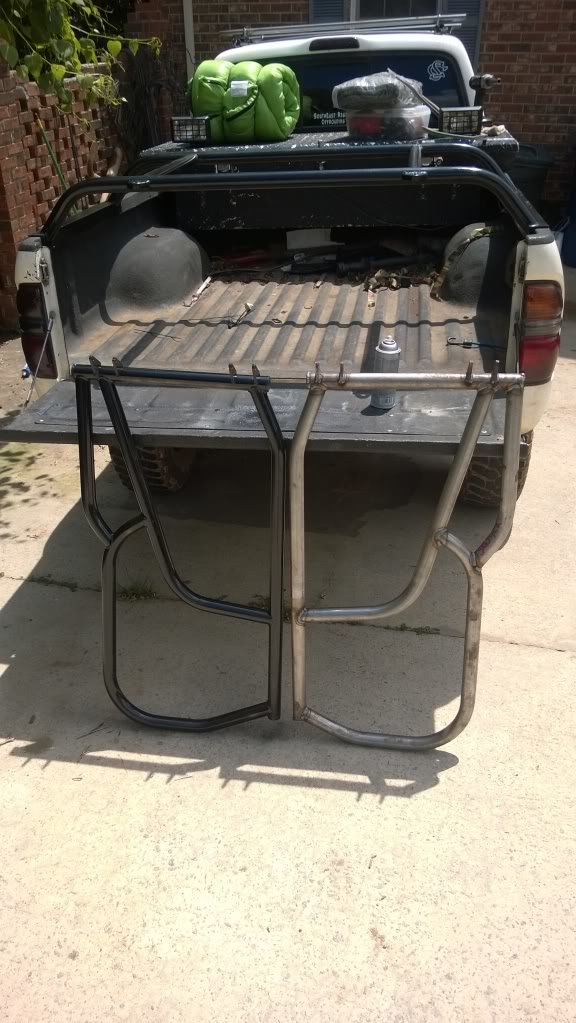

    Made some tube doors while I waited
    Pump showed up and its like turning air! so smooth now!
    Sold my toolbox and went to pick up a softopper from a fellow member. Bed bob will come in time to match the 5' softop.
    Finally got around to ordering gears for the rear and am currently awaiting install... but currently got a set of 33's to ride on for a little
    while.
    & heres a pic of the shackle angle
    Pirhett likes this.

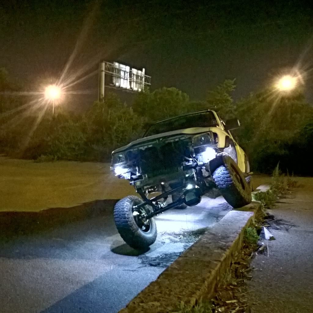

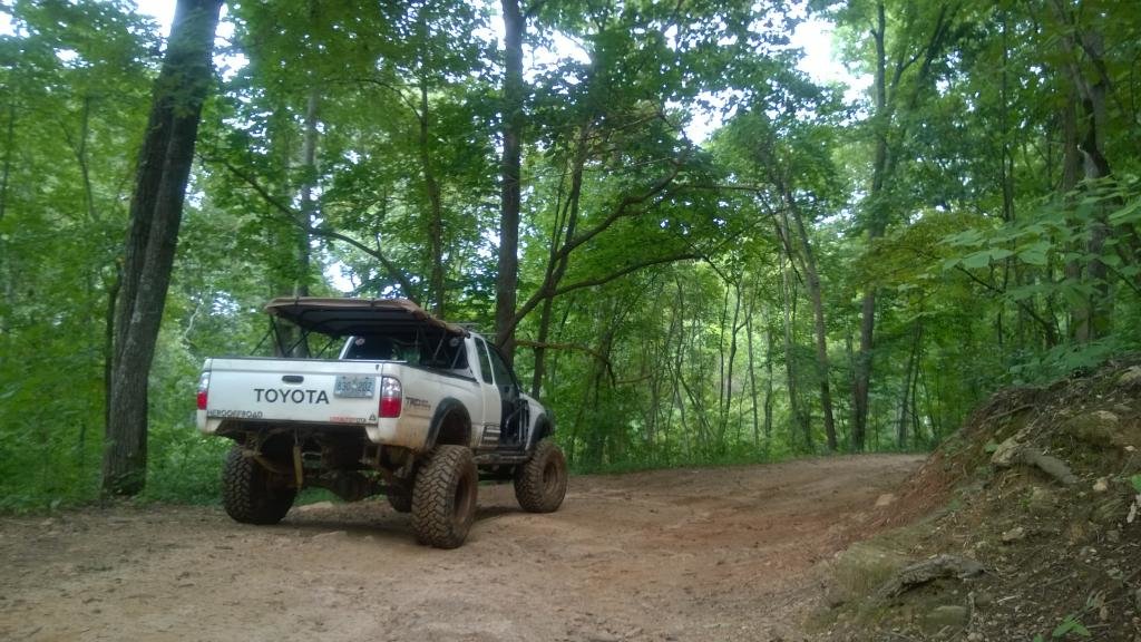

    Picked up some twin sticks and had a week alone out of town so spent the week putting them in, Football season is near and in the heart of South Carolina we bleed garnet so it was only fitting..
    Still need to get the shock hoops in place but that's all that's currently missing.. Was wanting to wait and see how much it'd settle before I put them in. hoops are bent just got to cut tabs to bolt the shocks up!
    So naturally even being 2wd I had to go test them but took it rather easy as im basically learning a new vehicle, but im super stoked and happy with everything! even being a prerunner she pretty much went wherever I pointed & on road I have absolutely no complaints!! now to the pics!
    Idea of ride height next to bilsteins and eibachs.
    Im around 5" over stock if I had to guess. 23.5" frame to ground
    2Lo walking the truck
