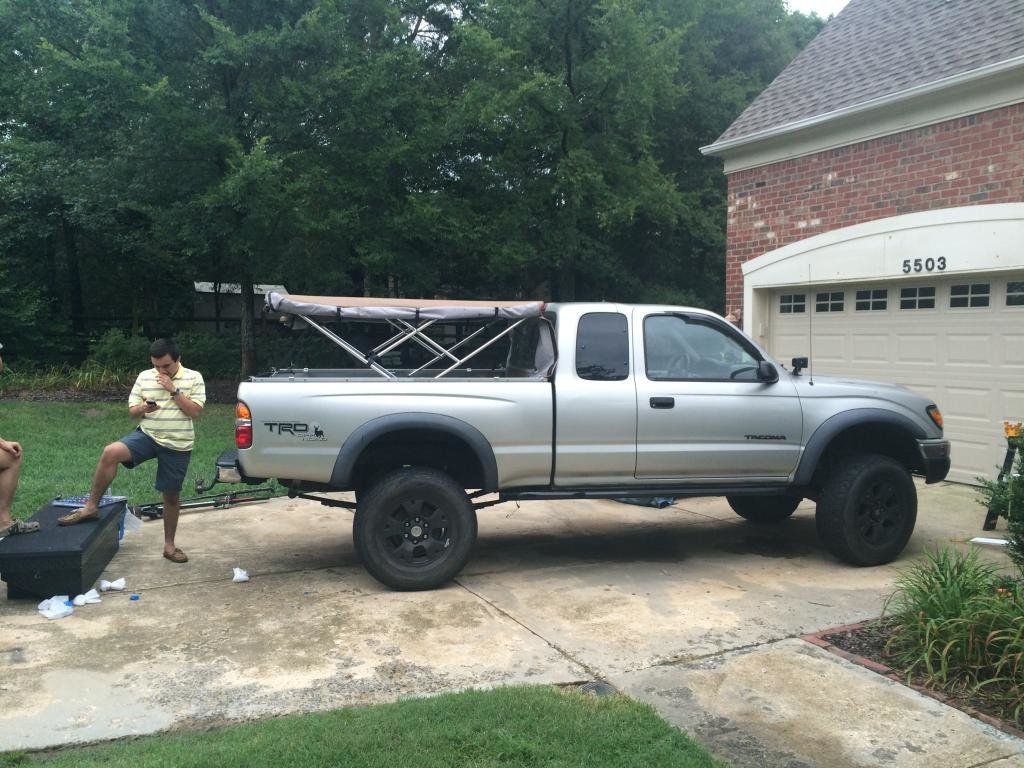

    Got BASH Fab sliders welded on last weekend and put a bastard leaf lift on it

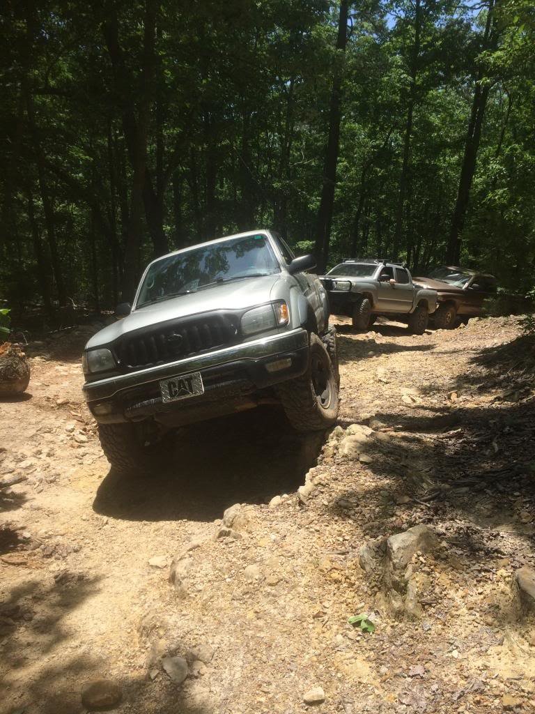

    Went to URE this weekend, the 4wd did great!

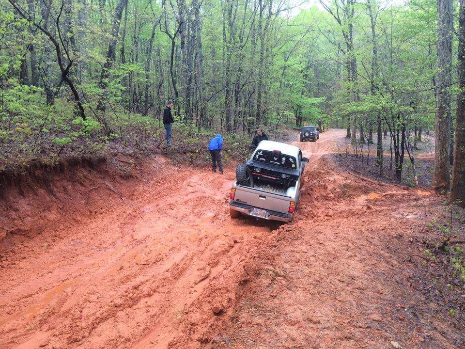

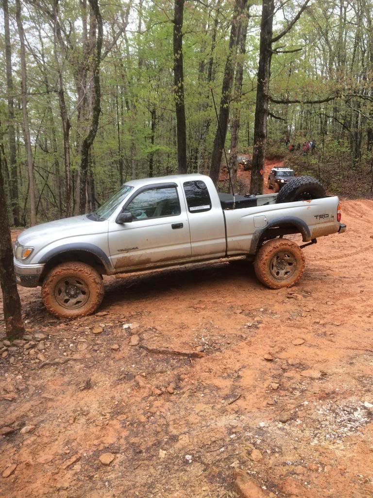

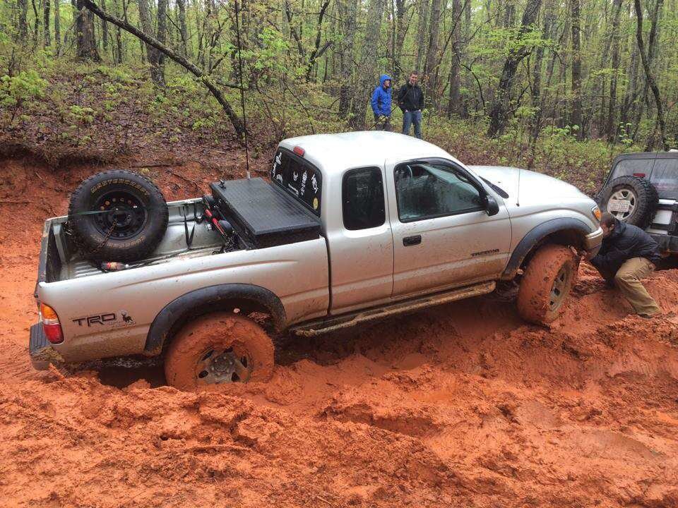

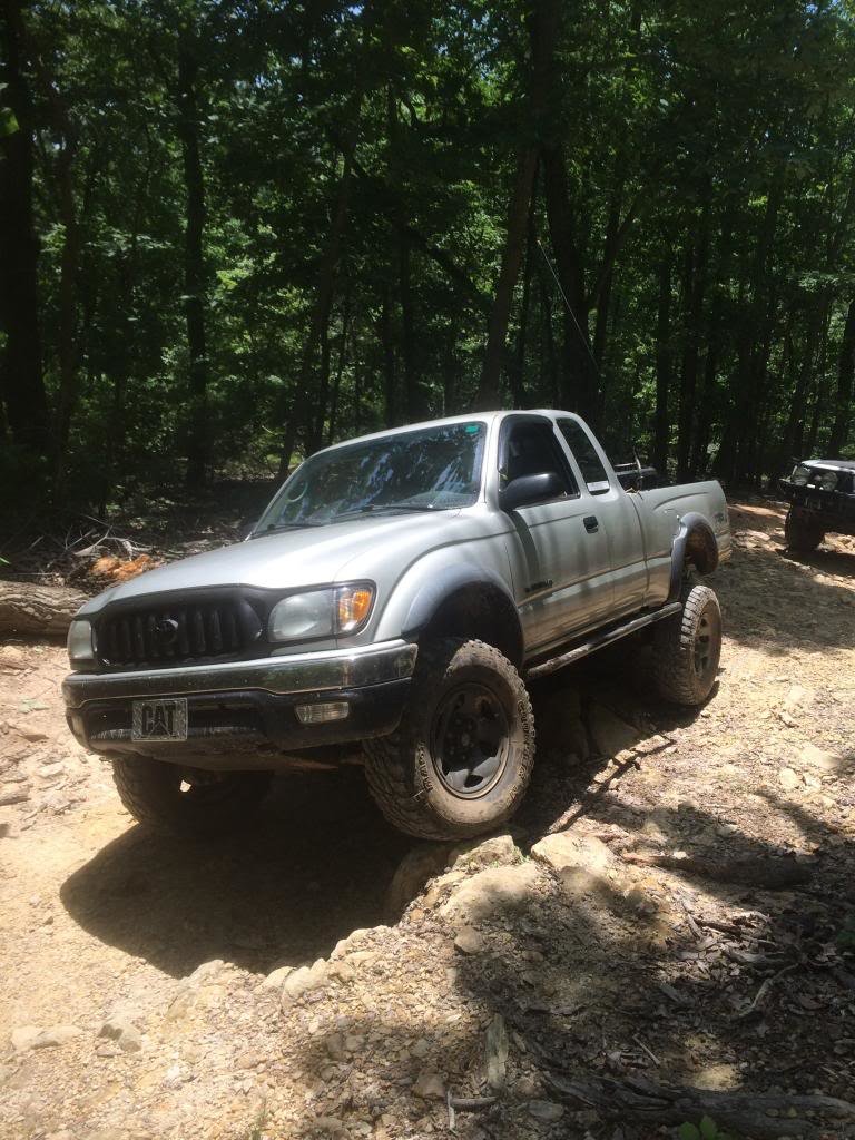

    This was where I got stuck and had to be pulled down the hill by a jeep! This was really slick!

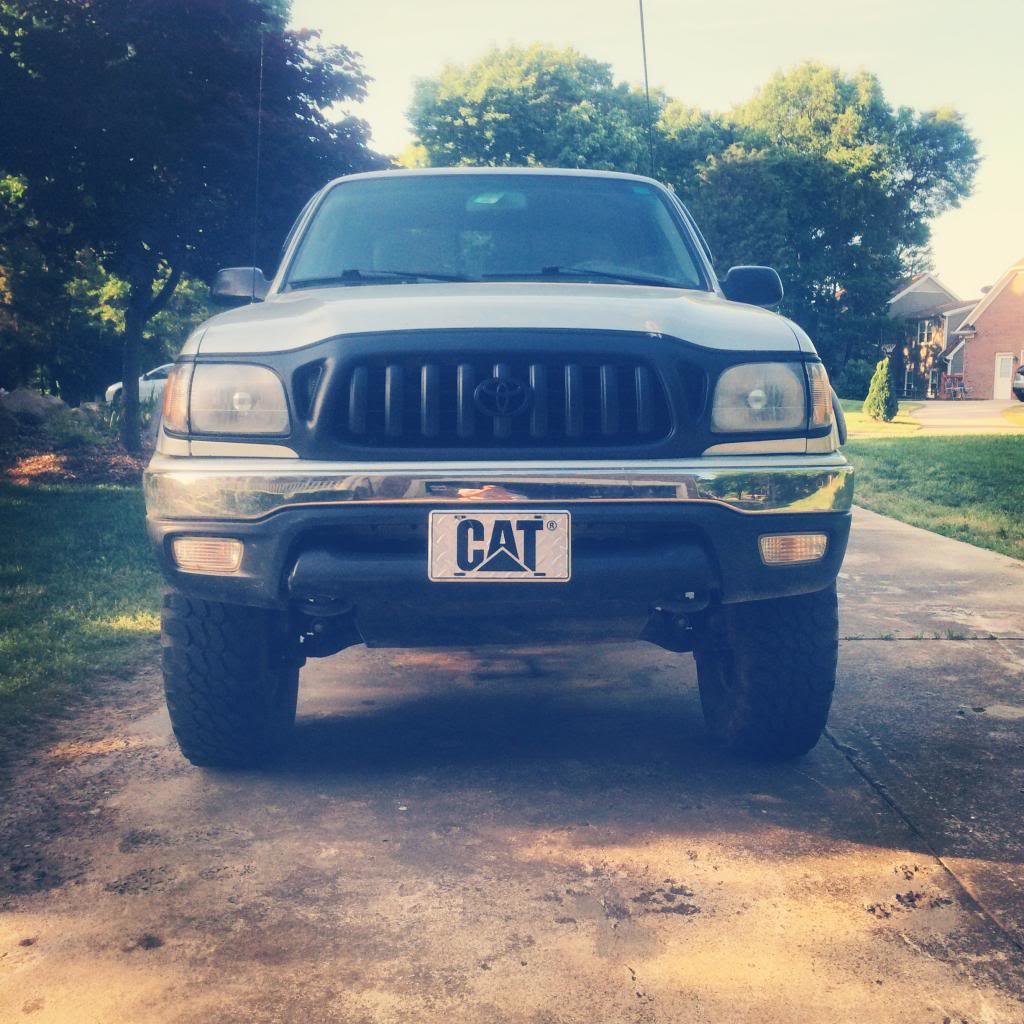

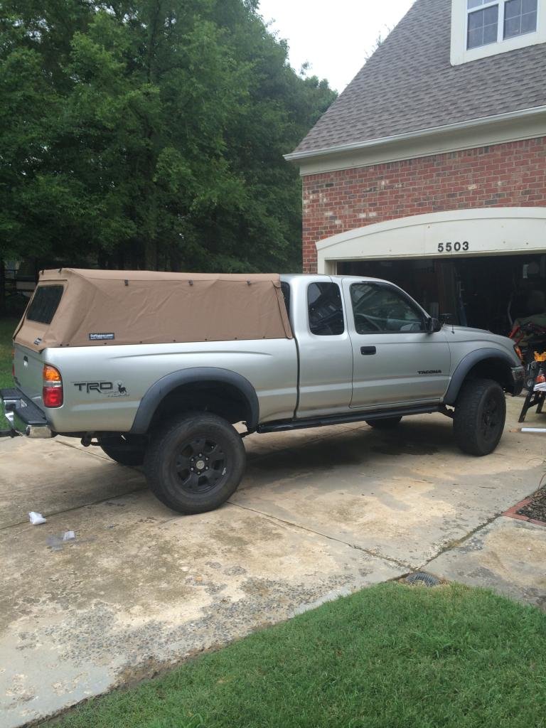

    Update
    Plastidipped my grill

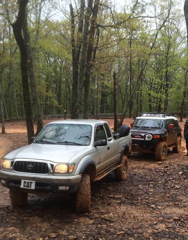

    Went to URE, a while back:

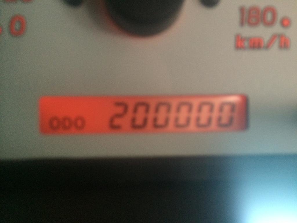

    Hit 200k:
    Got a Softtopper:
    Matic likes this.

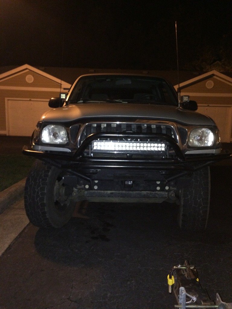

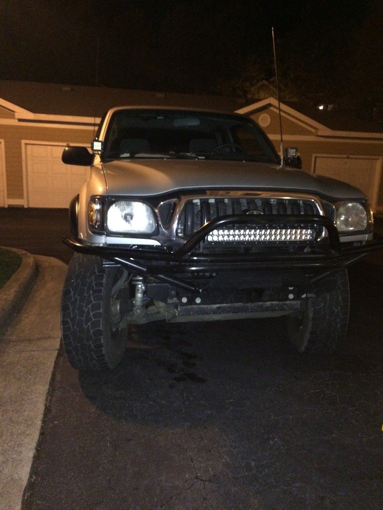

    Update
    Trailgear Low Profile Bumper and Lightbar, also moved my turn signals to the corner lights
    Patch Collection

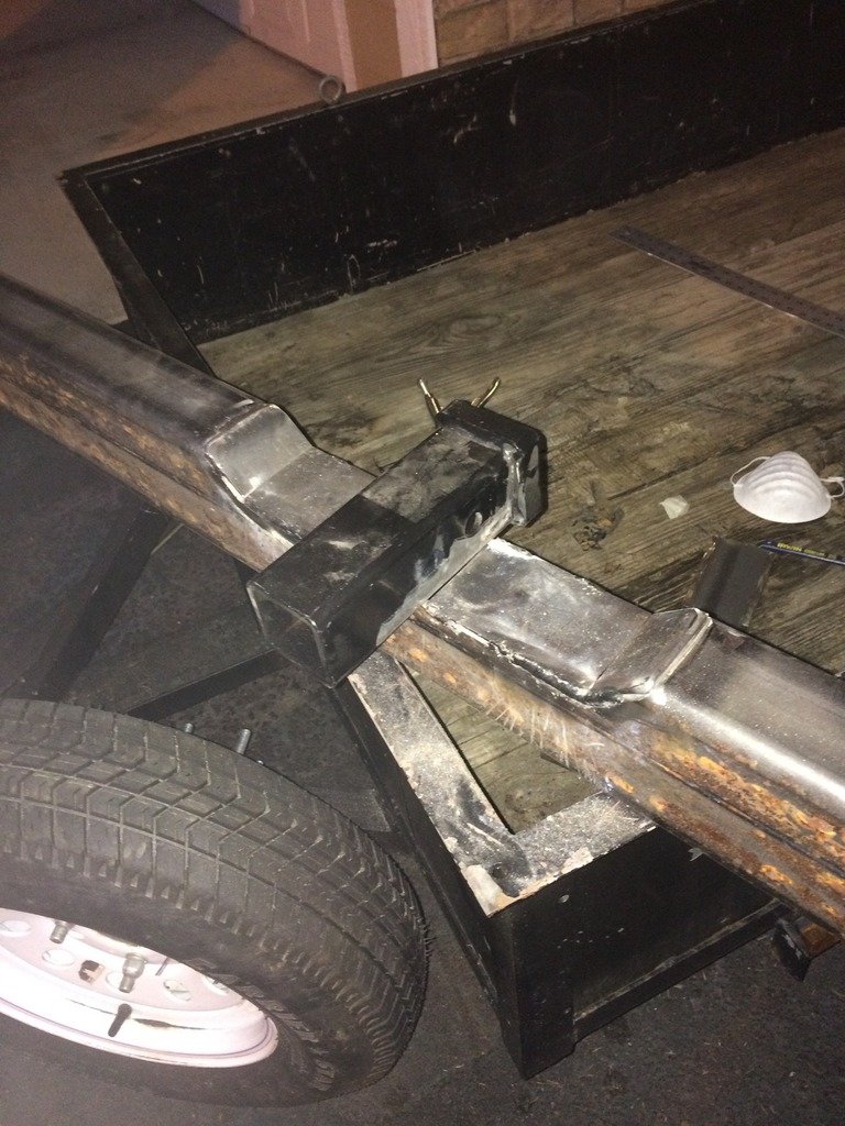

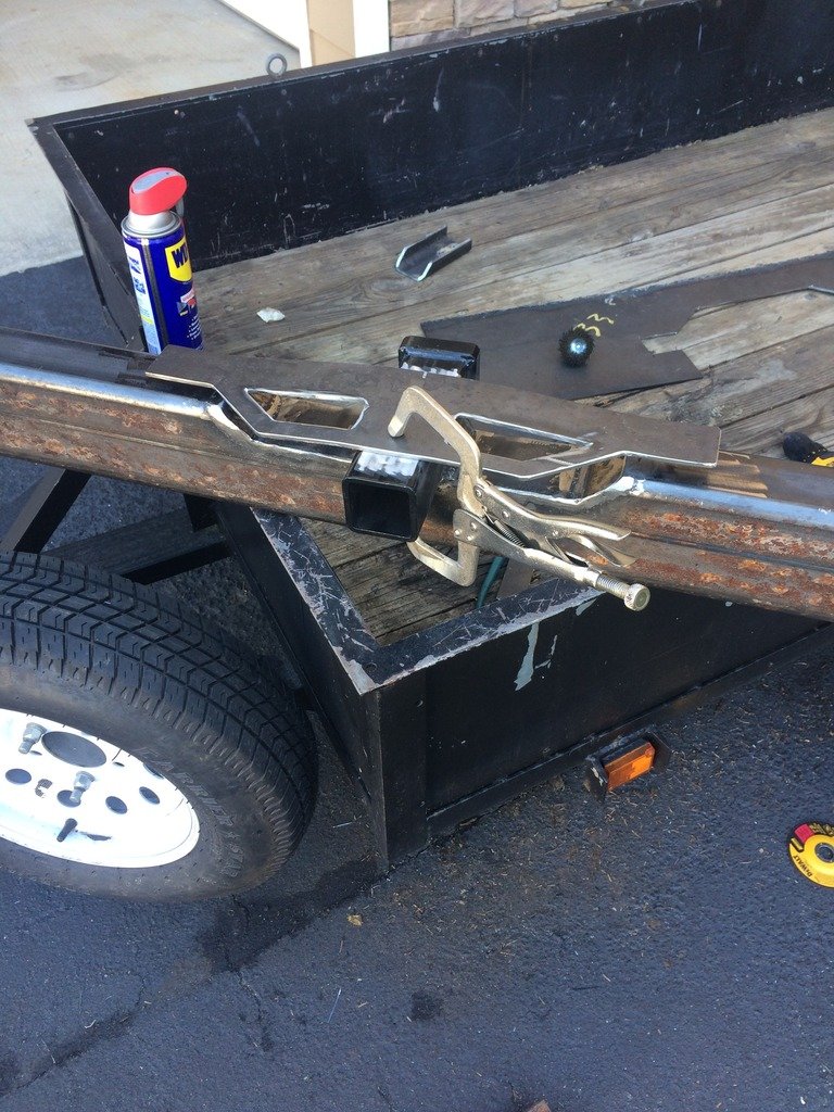

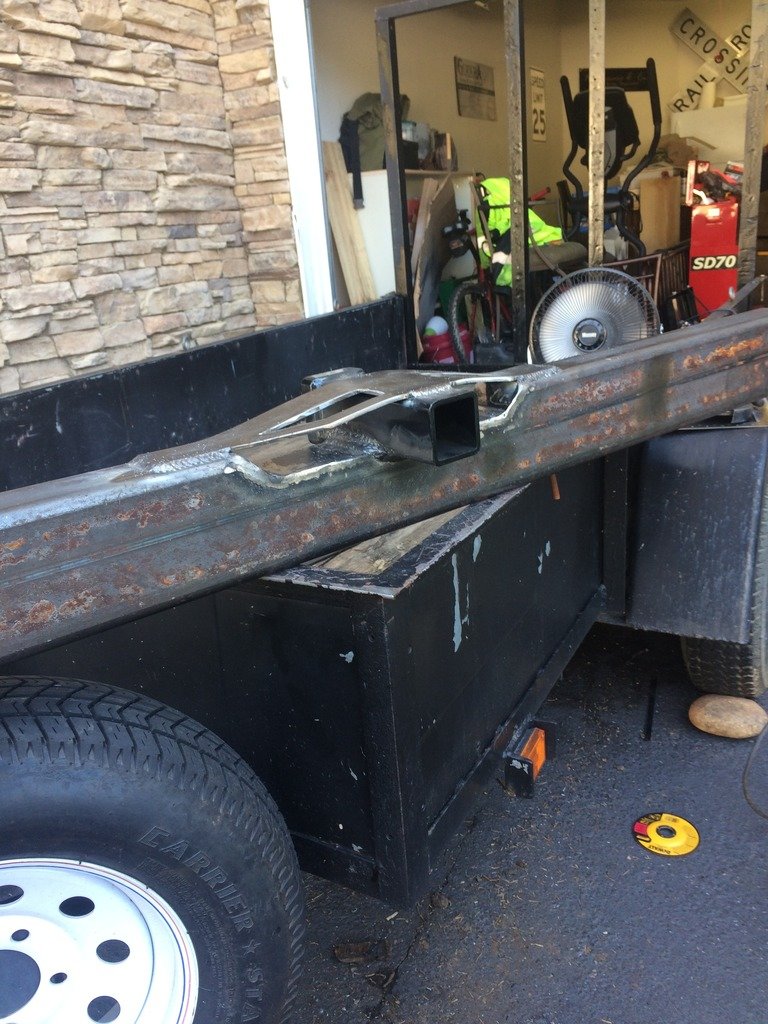

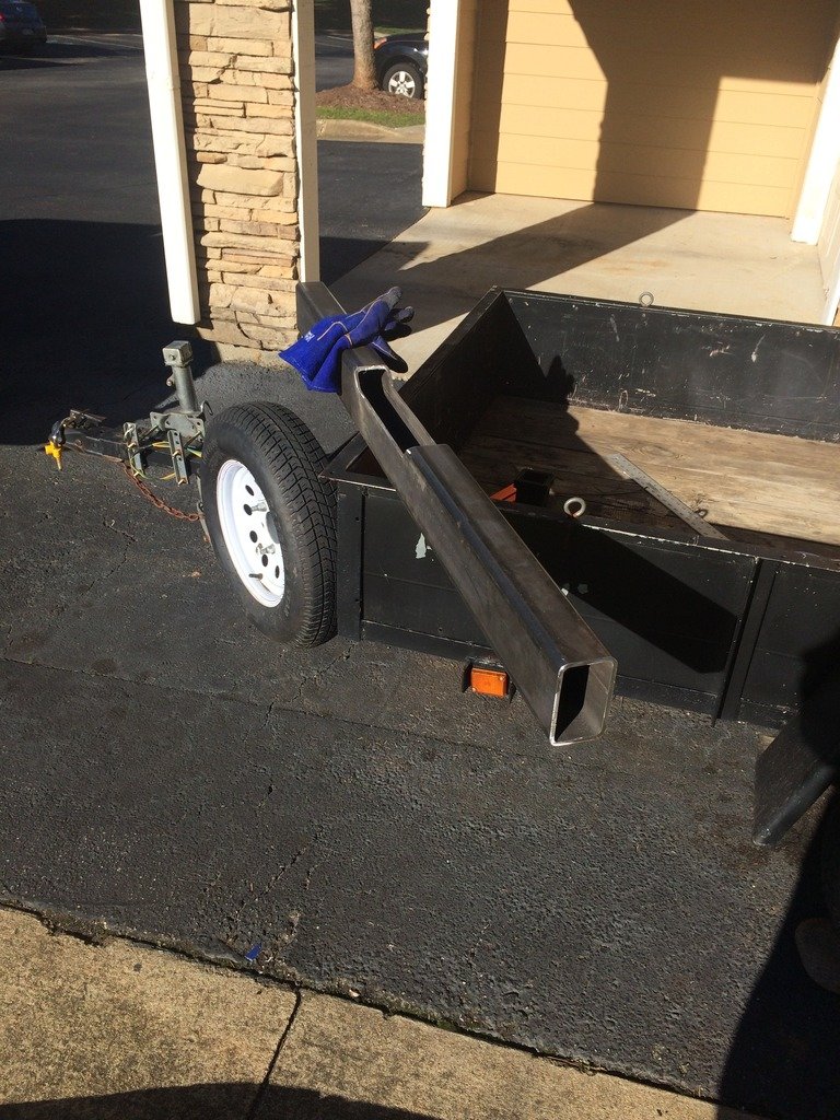

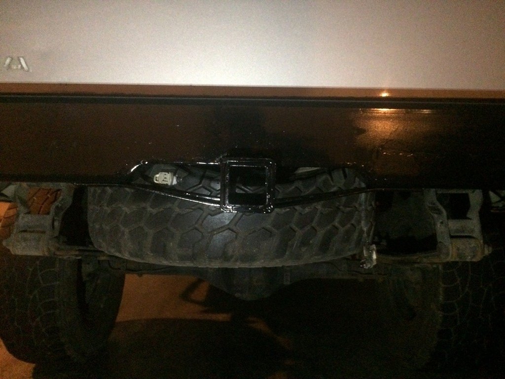

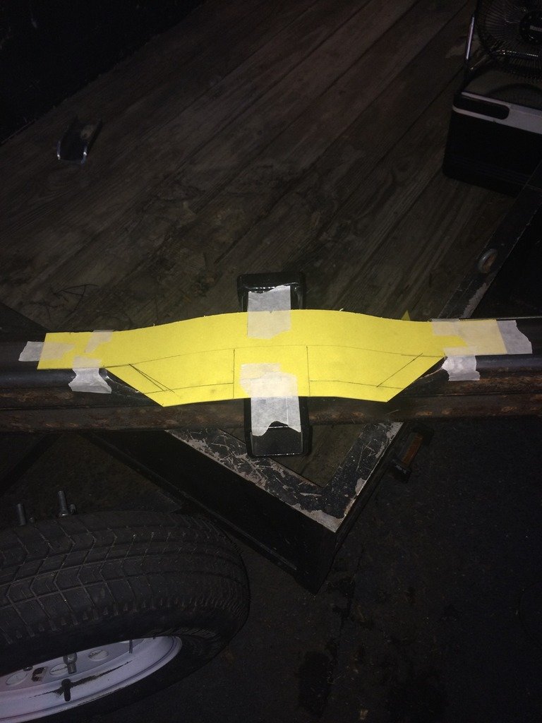

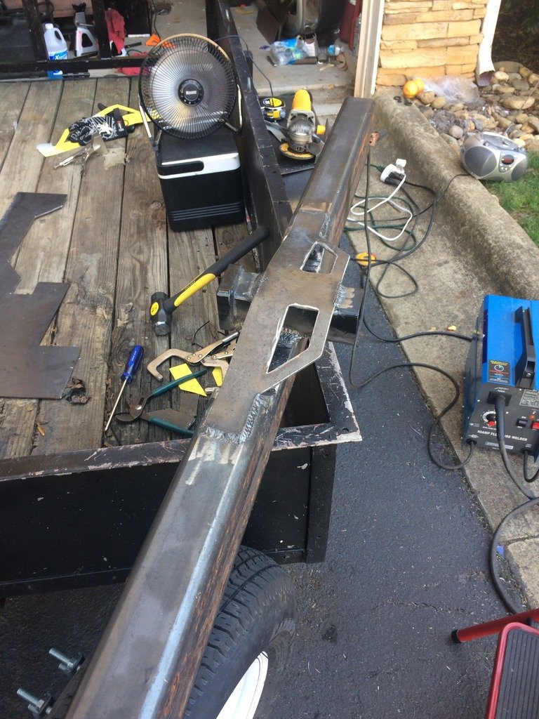

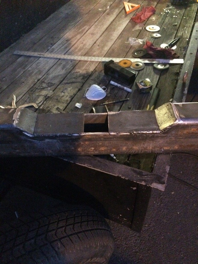

    Started working on a rear bumper build today, I am doing a bumper similar to BoxRocket's Tacoma bumper:
    Started with a 5"x3"x 1/4" wall tubing cut to length, then cut out where I am going to install my hitch:
    Started plating the cutout back:
    Mocked up with the hitch:
    That's as far as i got today. The plan is to use 1/4" Plate to create the brackets then weld them to the tubing, along with another support tube for the hitch. I also plan to run a plate under the hitch and connect back into the bumper beyond the bevels. I am also going to add side protection and a rear swingout, but that will be part 2 of my bumper build.

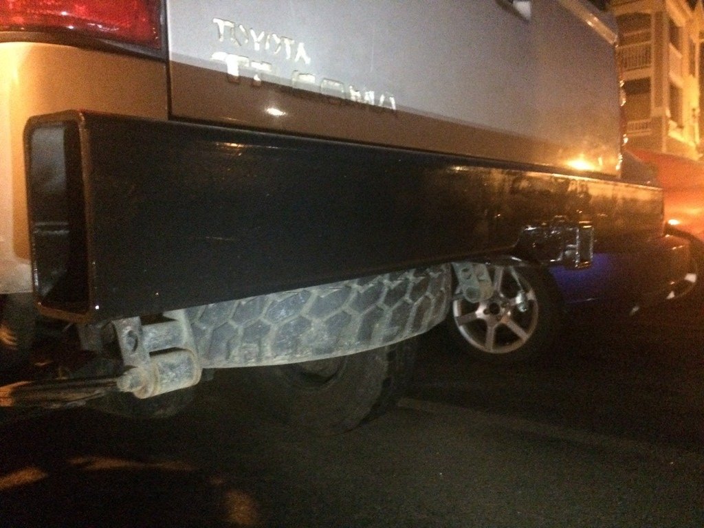

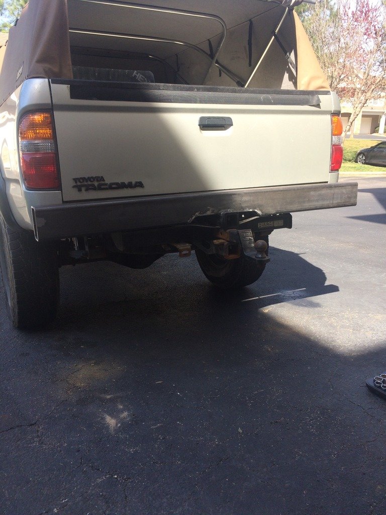

    Safety Chain Hookup Layout
    Mounting it up, I used my old hitch to hold it in place
    Finished Product:
