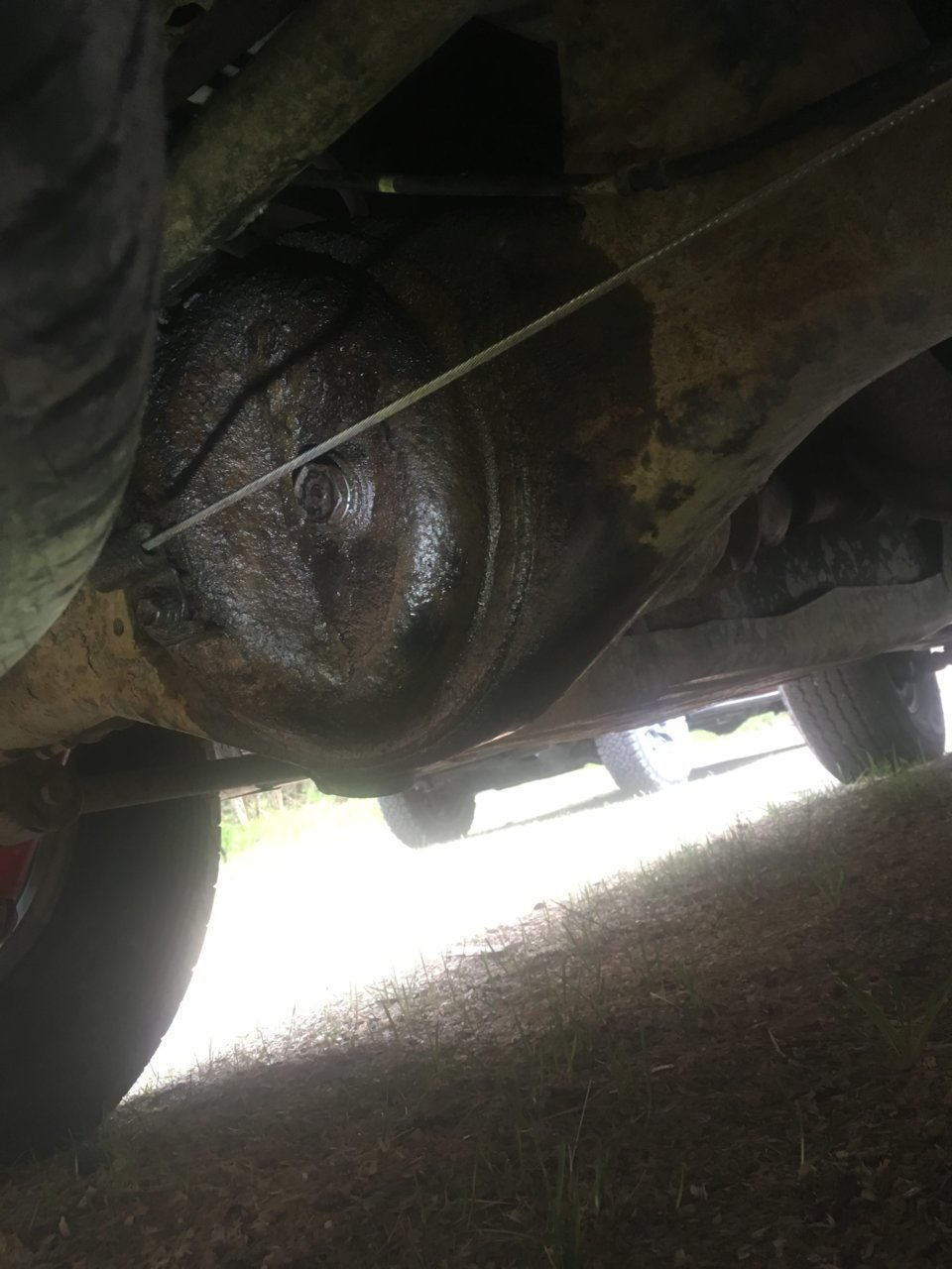

    looked under my 4runnr yesterday and saw oil seeing al over my rear diff. Crawled under to see what was up. Def a lot of rust there but really didn’t think it was at all possible to rot through. I thought for sure it had to be coming from somewhere else but there are not any deals back there. I can’t believe it. Have no idea what to do. Rest of the vehicle is in good shape. New t. Belt a year ago. 175000 miles. My 89 yota pickup has 210000 and has hardly any rust

    Maybe the seals are just leaky? Clean it up really good and check it again in a few days, see where it’s coming from, as well as check the fluid level. You can always take a wire brush to clean up the rust, use some rust reformer, then spray paint to protect from more rust. If it’s rusted through you should be able to spot the problem area pretty quickly.

    Thanks. Super frustrating. I will try and clean it up more. Just not sure what deal would be leaking as the entire front of diff is clean. Checked level and it was only down 1/4 q. My rear backer plates are rotting out too. Trying to figure out what would be more cost effective. I don’t think I can find a good used rear axle up here in AK.

    Do you have any pics?

    3rd Gen 4runners rust like crazy, even if taken care of, very normal.
    Check the diff breather to make sure it spins.

    I will try to get a pick.

    I put por15 on my sliders. I’m going to wire wheel my diff housing tomorrow and see if I can tell where it’s leaking. How do I know if my breather valve is working?

    Well. I spent half the day under the runner today going at it with a scraper and a wire wheel. Got the whole thing cleaned up real nice... absolutely no leaks! My guess is that maybe the fill plug crush washer was bad or leaking and was being sucked up by all the rust? Pulled plug the other day and put 1/4 qt. Oil in with new crush washer. It was still weepy after this but was before I had cleaned it all up so I’m guessing the first time I washed it down it still had oil soaked up in the chunks of rust. I really don’t know any other explanation to this as my diff is now very clean and bone dry. I am taking this as a good learning lesson in rust and prevention. I will now be very meticulous in the future. Especially with my new Taco.
