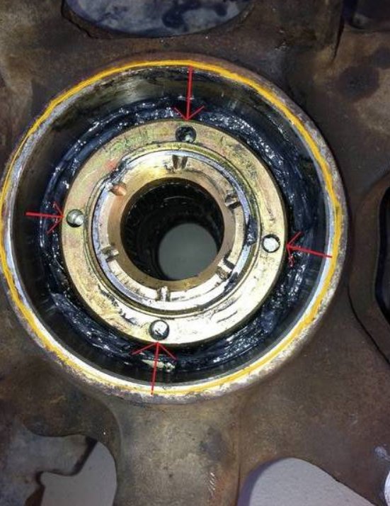

    OME and worth every penny.
    And I could be mistaken. It may be to hold on a PreRunner hub.
    Mine is held in by the CV axle.

    1999 Tacoma PreRunner TRD
    Everything but the driveshaft. B03A - 410
    Locking hub 4x4s have it also.
    Its required for "free wheeling" hubs on 4x4 with locking hubs and PreRunners ONLY. Not used on ADD style axles.
