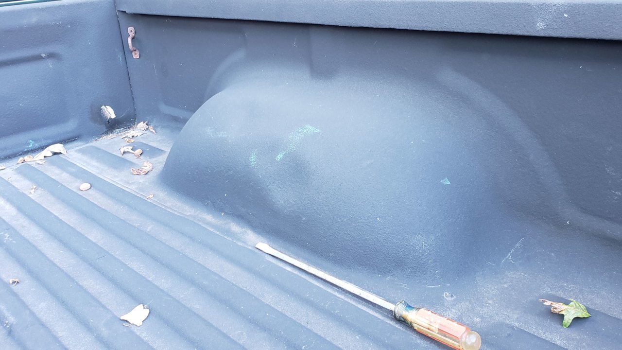

    And here's where that spot is inside the bed - the screwdriver head is pointing right at it.

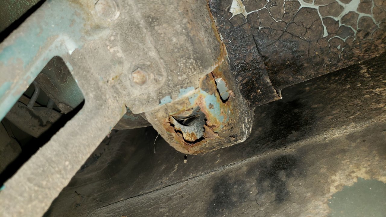

    Here's the second spot: We're looking straight up in front of the driver's side wheelwell at the brace that provides rigidity to the front corner of the bed. This one all opened up when I poked with the screwdriver as well.

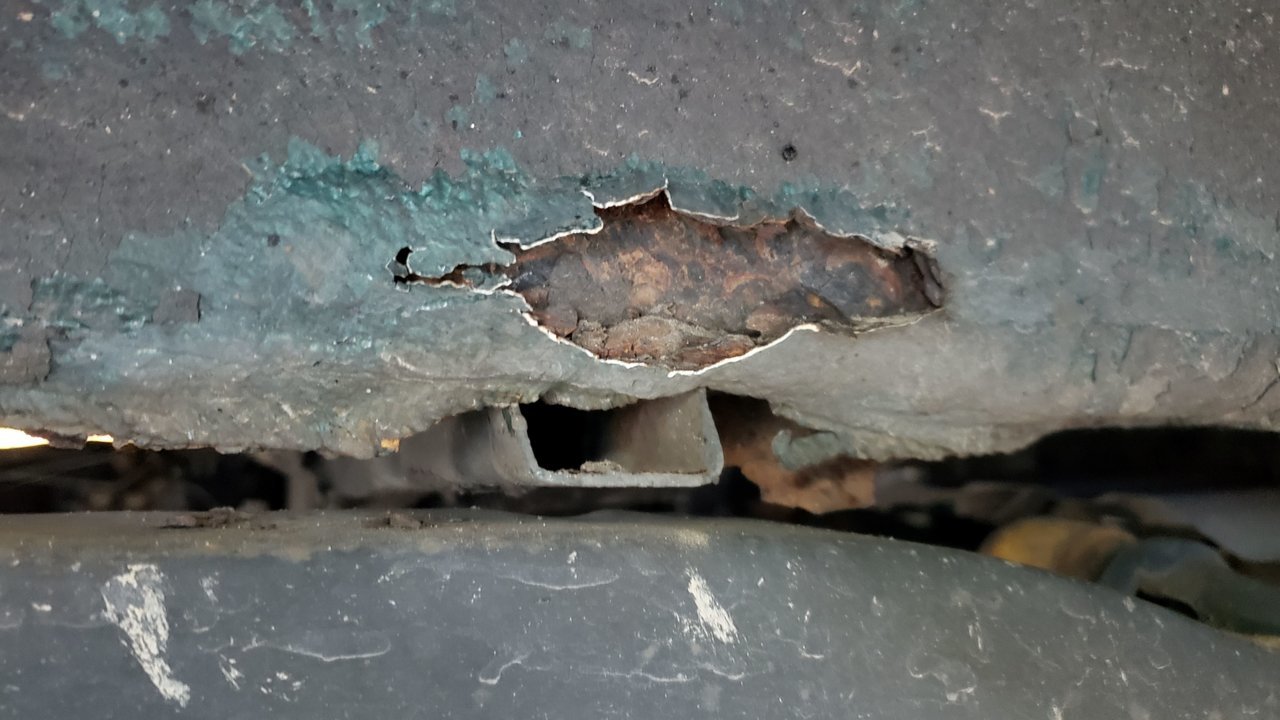

    And here's a close-up of that area.
