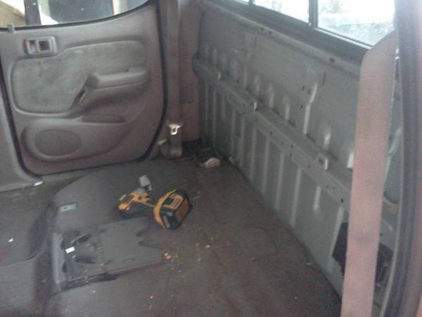

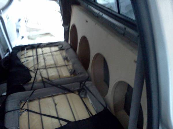

    Of course it cant be done, 4 12" mtx subs in the back of the back seats in a 2002 4x4 double cab 1st gen.........just wait for the 4000 watt amp, where is that going? Check out my gallery for photos

    Welcome to the forum brother. Anything is possible with enough time, money, and know how. What's the specs on those subs, box, amp? Inquiring mind's want to know! Bet it bumps! How's the rest of your system look, mid's/high's etc? I'd suggest you keep that child restraint bar I've had dealers and other people tell me that it would drop the value of the truck by a grand or so if it isn't in there, I did the same thing but bought a new one so that I could weld it back on if I ever decide to get rid of it. FYI if you click the link under your pictures in you gallery and copy it then past it in the text field they will show in the post, like so. :thumbsup:

    Your C pillar's. :eek:

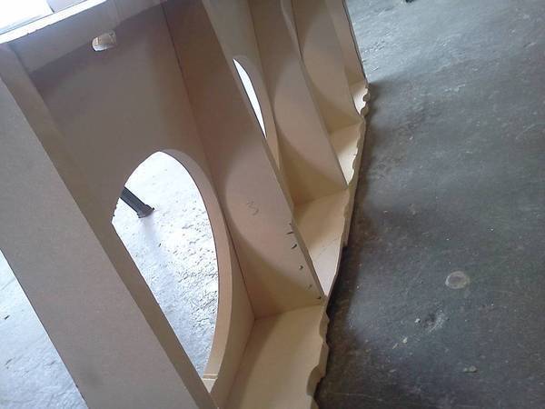

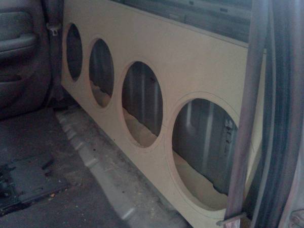

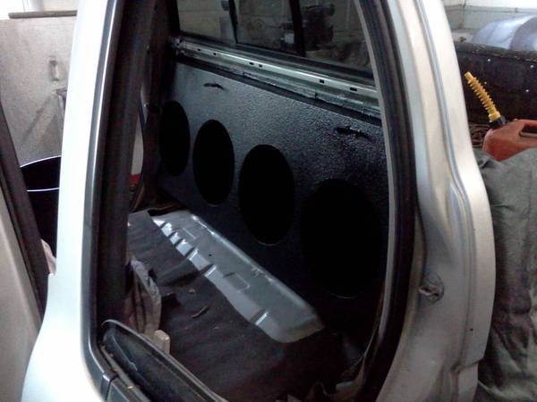

    Thank you for the help with the pictures and the welcome. as of October 16th I've been working on it for the last 3 days and almost done with the Box I will post more pictures as I build the system over the next week or 2.

    Honestly I think that is going to sound like sh!t. Why are you not sealing it properly?

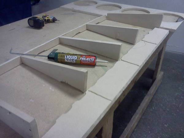

    It seems like he's trying, hence the liquid nail. ;)

    I hope for his sake that he did seal it up. Also, some sound deadener wouldn't hurt. I built my enclosure off the rear wall, too. The area of the rear wall that I used was about 1/4 of the size of what the OP's enclosure will occupy. It took a few tubes of silicon and about 3 sheets of dynamat until I was satisfied with the integrity of the seal.

    I am using the bed lining as my sealing agent. I had the bed lining company put in a quarter of an inch on the back wall. I have done this before and the bed liner makes a great sound deadining against the metal

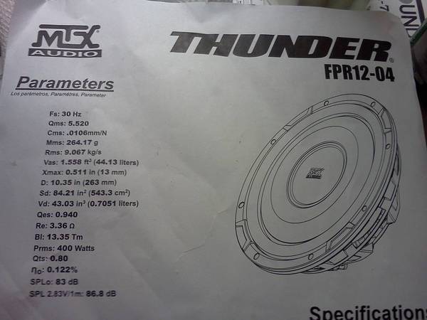

    Here is the specs on the 4 - 12" sub that I chose for this project. Mainly for the 400 rms 1000 peak but you should never go by he peak.

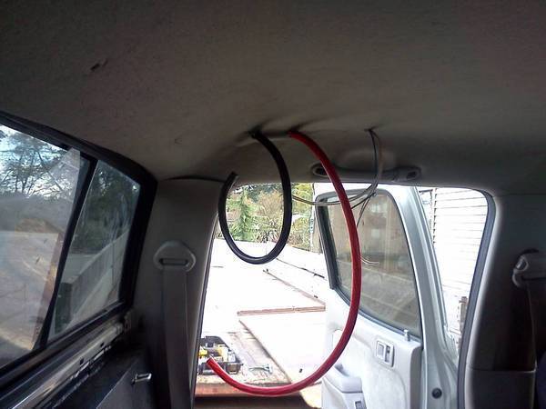

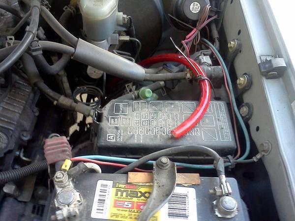

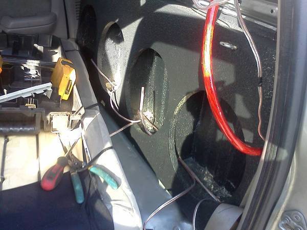

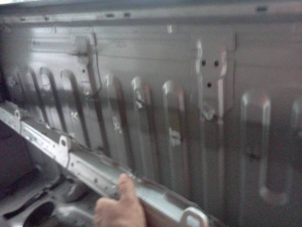

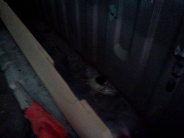

    Got some more done today starting with installing the 0 gauge wire from the batt to the ceiling in the backwhere the amp goes

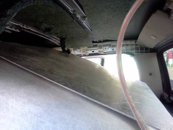

    Now for installing an aluminum plate under the roof liner having somthing to mount the amp, capacitor, signal processor to.
