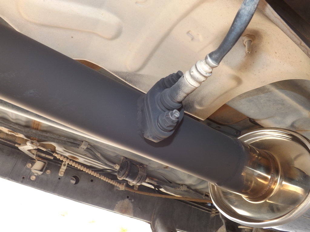

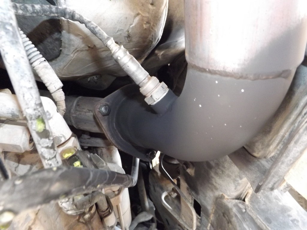

    So I've been looking at 02 sensors.. Basically what I'm wondering is, if the upstream sensor I have, will work with one of the cheaper ones on rockauto. Because the ones with the 'plate' with two bolt holes are cheaper. The types w/o the plate like my current upstream one is way more expensive. So are those plates required? Or can I use the cheaper version and thread into that pipe w/o the plate?
    (Ignore my coolant leak, that's another issue I'm dealing with;))
    Upstream:
    Here is a list on Rock auto. The one listed above is the cheapest, which is the one listed at the top in pic below. But it has the plate on it.Then they go up in price for the ones w/o that 'plate' and are not Denso.. From what I've read Denso is the best for our trucks.. (Found on Amazon for $90 for denso)
    ***So can I use the denso w/o that plate or is it not removable and have to get a different brand for my upstream?***

    I just got the cheaper, upstream 02 sensor from Rock Auto. They. An be used both ways. They come with a plate that you can screw the sensor into or not use the plate and screw it into the hung on the pipe.

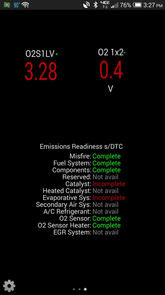

    Here's a screenshot from my torque app.
    Not sure about the emissions test. After I drive it a few more miles to make sure the code doesn't pop, I'll reset and see if the cat and emissions test will complete.

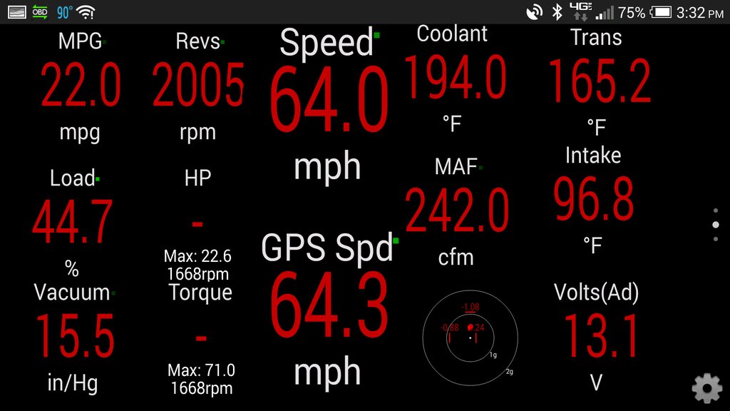

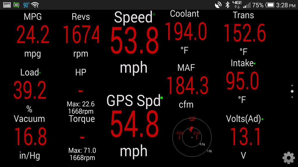

    And a couple more of all the different sensors I'm running, at different rpms. Lemme know if anything looks out of the ordinary.
    Not sure if the mileage is accurate. Most likely not. But it is higher than it was before I did the new exhaust. As I believe my cats were clogged. But she still feels gutless...
    As if the maf or 02 sensor isn't working properly. Still 'feels' the same like I didn't even do anything to the exhaust even though I'm sure it's much higher flow now.

    Any input on the upstream voltage of over 3 volts? Everything I read up on says it's supposed to be between .1 to .9 volts. And the rear is where it should be around .5...

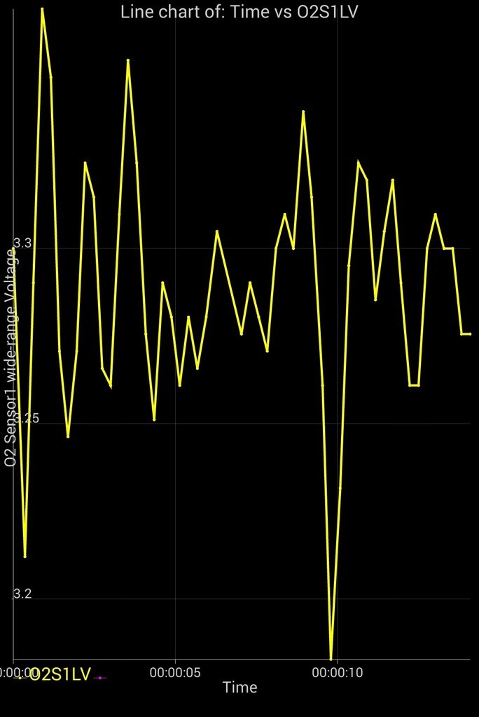

    An update with some thoughts of mine regarding the issue I'm having...
    So my air filter, is a Donaldson Powercore Filter. It is possible that it isnt supplying enough cfm. May be why my performance/power loss at higher speeds suffers more than when at idle. As if it isnt getting enough flow. Plus a combination of 33x12.5's and tons of light bars creating drag. I will see if I can get a bigger air filter to use and test. The Volant CAI calls for a cone oiled filter. I replaced that with the powercore filter with a (iirc) 4" flange on it and used a spacer to fill the gap for the 3.5" flange of the intake tube. I have since replaced it with the correct size flange (3.5) but the flange is shorter on this current filter and may be restrictive unlike the other 4" that had a slightly larger and longer flange. Idk I'm just throwing this out there as it's something I'm considering that may be contributing to my power loss. Again she runs really good. Just feels like I'm towing a trailer behind me when I'm going on the highways. If I punch it and get the rpms up, when she shifts, it bogs down for a second at the shift as if it's not getting enough fuel/air. Plus on hills/slopes she doesnt like to keep up and wants to downshift. Anyways.. Thats the story and symptoms.
    So I did a few tests.. Here are the results:
    Tested 02 volts front and back sensors:
    I read up on the front 02 sensor as showing the 'wide range voltage' being normal. And that it is divided by 5 or something like that.
    Front still reads ~3.28 volts and fluctuates.
    Rear still reads ~.5 volt and fluctuates.
    Created vacuum leak to watch for increased fluctuations:
    Front sensor shot up to ~4 volts.
    Rear sensor plummeted to .01 - 0.0 volts.

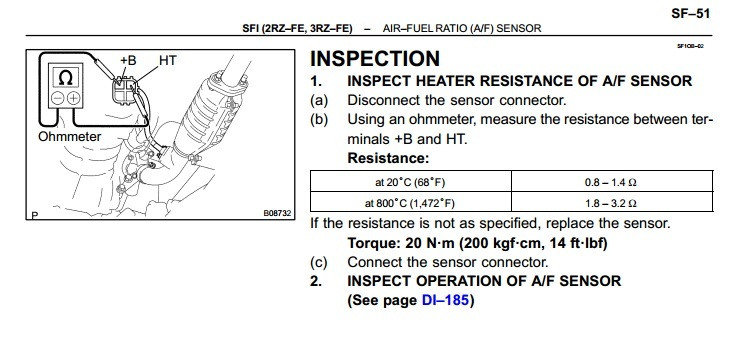

    So it APPEARS that they are working within spec. I tested the resistance as well. And iirc it showed the upstream as having about 2 ohms resistance. Haynes says it should be between 11-16 ohms... So I'm a little confused with this. It appears that it's working as it should but the ohm readings don't fall within spec...???
    EDIT: Forgot about this illustration posted above.. not sure why the book says 11-16 and the illustration here says otherwise:
    According to this its within spec..
    Also... MAF in haynes says grams/sec should be 4-7 at idle. Mine was showing 3 g/sec.. (this is why I'm thinking my filter is not big enough/restrictive.)
    But it does appear the MAF is working just as it should.
    Also figured out how to take some graphs on my torque app of the 02 sensors.
    1st pic is the upstream sensor wide range voltage over a few seconds at 2k RPM.
    2nd pics is the downstream sensor voltage

    Idk. I gave up trying to figure out how to read all the data. I just went ahead and purchased both new sensors. Doesn't seem to run any differently. The rear O2 Was throwing the efficiency code and went away after the new one. I did also change my air filter to a conical r2c filter. She breathes a little better now as I can feel the difference. But I still suspect that something else is keeping her from running like a top. Oh well. She runs good enough. Hell there might not be anything wrong except maybe a timing adjustment, or valve adjustment. Not sure how much that affects things. And not mechanically inclined enough to tackle that on my own. Maybe one day I'll get to it. Idk.
    Edit: oh and I did have to get a Bosch upstream sensor. The denso you cannot remove the plate. Not sure if this was done by the p.o. because from my understanding is that it calls for both sensors to be denso. Not sure if that's true or maybe an oem mid year change as it's an 01. But she's running just fine with a new Bosch up front and a new denso in the rear. Because in another thread there was some that hinted at it not liking anything but denso, or mismatched brands at that.
