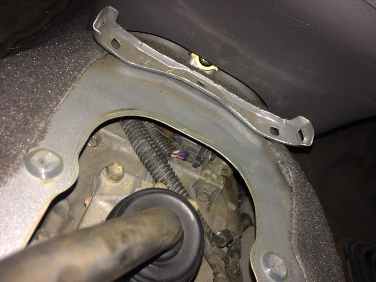

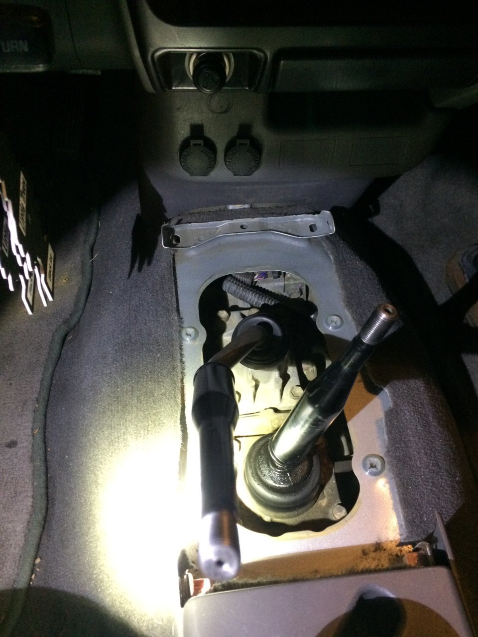

    So I just finished both 02 sensors and it was completely different than almost every video I’ve seen. The downstream wire runs up underneath passenger seat and I had to pull up carpet to get to it, and upstream was horrible. Above transmission and I had to remove the shifter boot to access the clip where it it’s connected. Why Is my Tacoma different from all the videos I have watched? Took me forever to figure out how to get it replaced7A71449A-5EC3-4586-B85F-03E1F9FA99DB.jpg310E475B-9AA5-42F0-875B-E2785B3811B4.jpg

    Well the upstream is worse because there is no room to to work. It took me multiple tries to finally get it. Just don’t know why some are easy and some are not

    I recently replaced both on my truck, v6 manual as well. I think it was @1997tacomav6 or @CS_AR who recommend using chicken wire to hook the wire and fish it up so you can connect it and be able to fish it when you repeatedly fumble the connector because no room. Worked for me.

    This procedure is normal for the 02 sensor removal with the 5 speed.
    Next time will be a breeze to do it
    I actually keep a roll of tie wire handy for fishing situations if needed like this.

    Ya next time won’t be bad, I think the hardest part was trying to figure out how to unclip it. But I’ve got 2 new ones so hopefully I wont be doing it for a while now!
