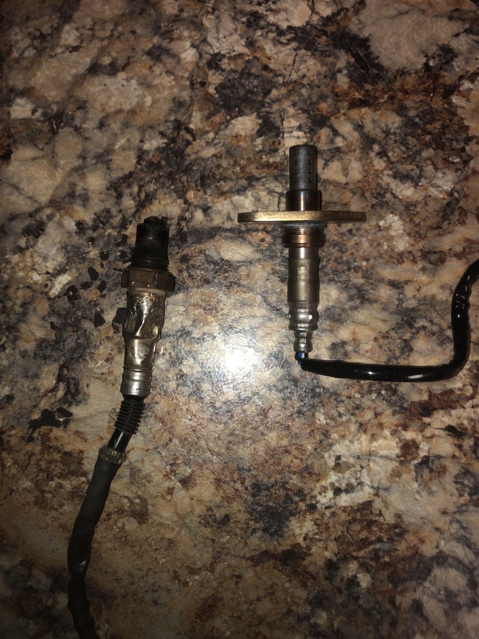

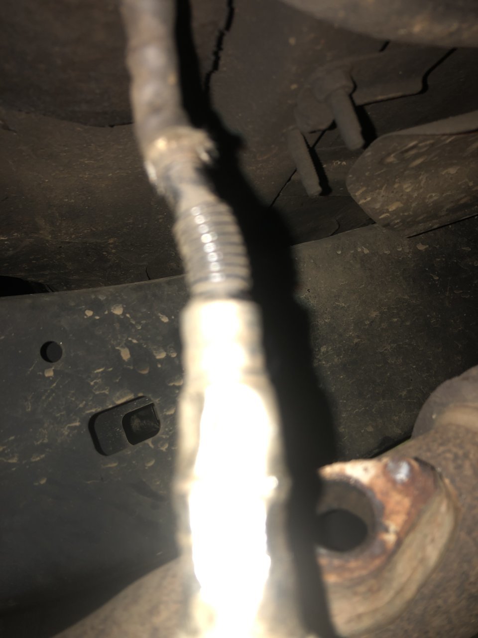

    Need to replace my 02 sensor to get mine to pass inspection. One side was a stud and one side was a bolt so apparently one side broke off on the p.o and he fixed it using a very low quality bolt. Which broke off flush.. what are my options here? Can’t remove the exhaust pipe due to the cat being welded in. Also some of the p.o’s craftsmanship. Any ideas? Can an exhaust shop cut that section out and weld me in a new flange with new studs and everything? I attached a very bad pic sorry best I could do

    Old and new. I do have the correct new sensor don’t I?

    Yeah you're new one is definitely the right style and very well is the one as long as that's the right part number. How the hell was that old one even secured to the bung? It has to be like your new one. Sensor is mounted to a flange and the flange secured to the bung. There should be two studs coming out of each end of the bung that flanged sensor slides over and then two nuts are used to secure the sensor down on those studs.

    the old one is an aftermarket Bosch sensor. New one is the corect OEM part.
    Some aftermarket o2 sensors have a screw-on flange but strange that it's missing, though. Sensor was probably replaced in the past but since a stud broke, they put it without the flange but I wonder how it was holding there... maybe they did thread the hole, or forcefully shoved it in there?
    As to repair the bung, you could ask around if muffler shops could weld in a new one, or else you will need a new exhaust pipe (available on rockauto). It's bolted to the cat with a flange so it shouldn't be too hard to replace

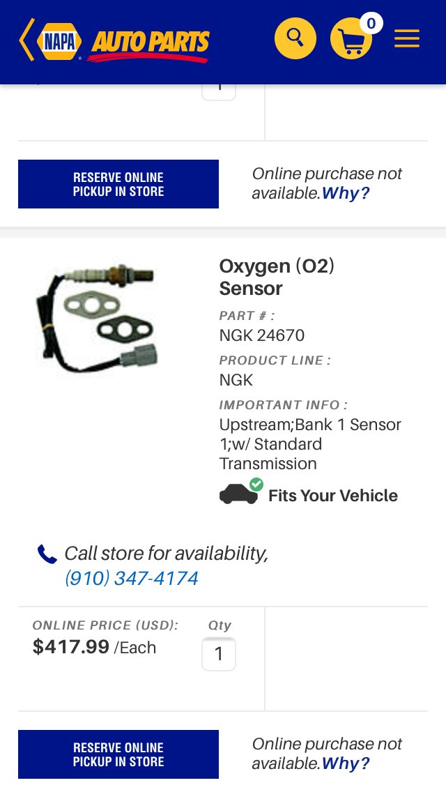

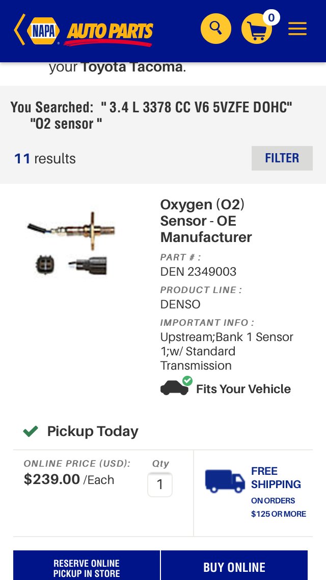

    Ngk sensors come like your old sensor. The screw in bung bolts down to the two studs, and the sensor screws out and is replaceable without the bung plate. If you still have the bung plate from your old sensor, the easiest way I see to fix it is to weld your old bung plate over the broken stud, and replace the o2 sensor with a ngk screw in type. It is available with or without the bung plate. The ngk kit with the bung is about twice the price as the factory denso replacement sensor, but in your case, it would be worth the extra cost. Not sure if these two examples are your correct part, but here’s the difference in what NAPA offers.9C7C9390-ECD5-4AE5-842E-B9F040FBF6EE.jpg07B47CCC-CEF5-4D94-947E-12723A17E081.jpg

    Yeah I would replace that section of exhaust if the flanges on the cat weren’t welded to the pipe between the manifold and cat. Just trying to pass inspection not looking to spend a whole lot. Talked to a local shop taking it at 12:00 for him to look at it and see if he can get the rest of the broken stud out and replace the stud. Worst case he also said Boshe offers a screw in style 02 and he could cut this section out and weld in a new one with a screw in style bung for 50$ or so. So we will see

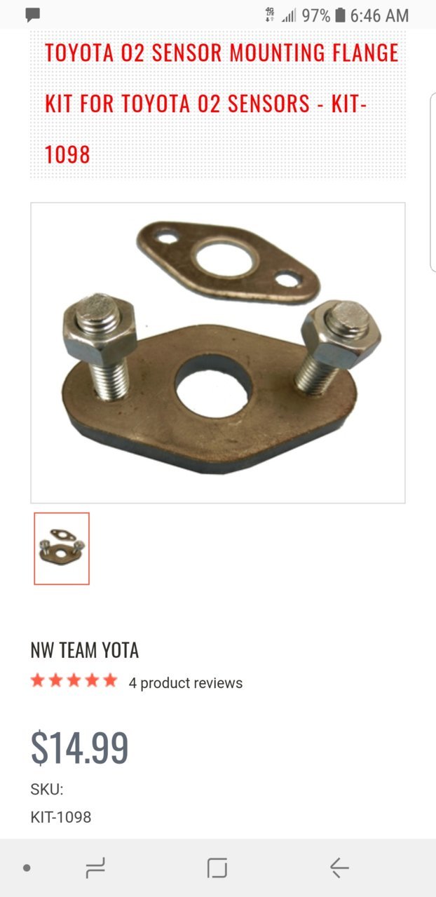

    Weld this over your existing one.

    Thought about that to. Gonna see what the exhaust shop says today. Might be my final option
