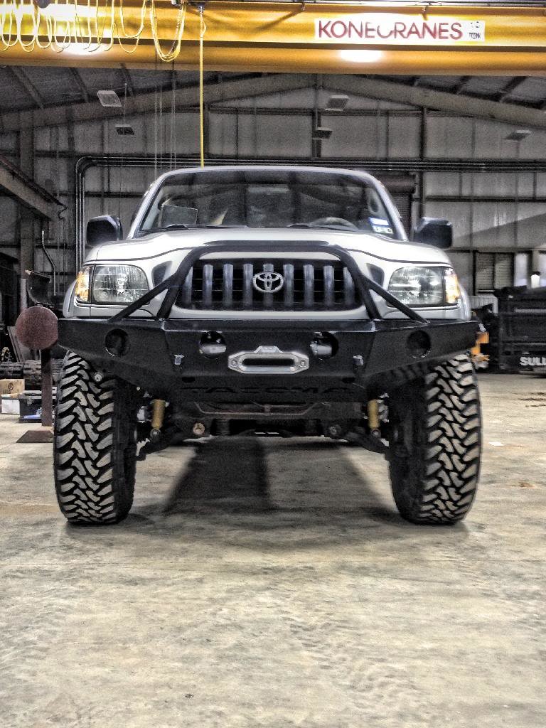

    Here we go!

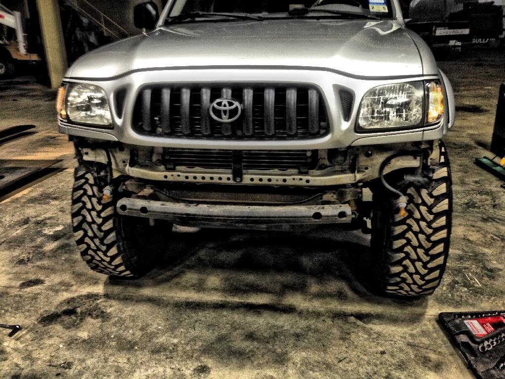

    Anddddddd the bumper is off!

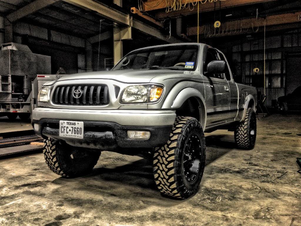

    It's not finished but here's a pic to help y'all get by.....

    All of your pics seems to have some color enhancements:notsure:, any plain pics?

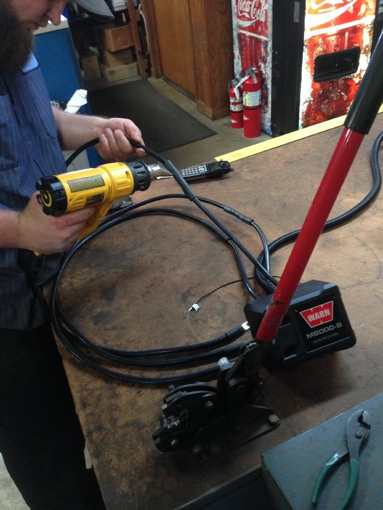

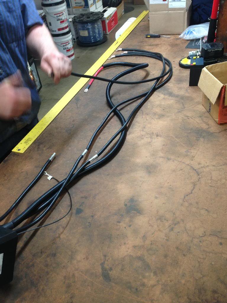

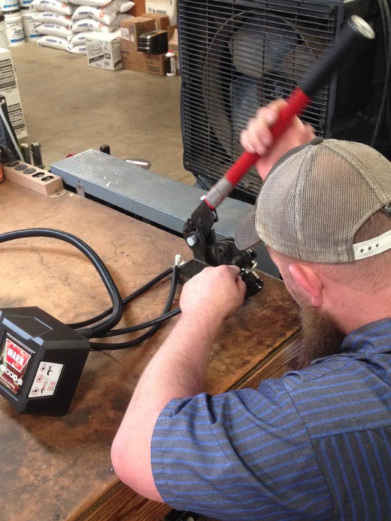

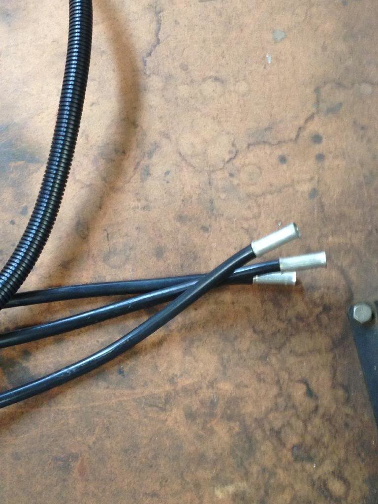

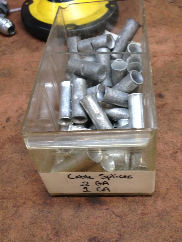

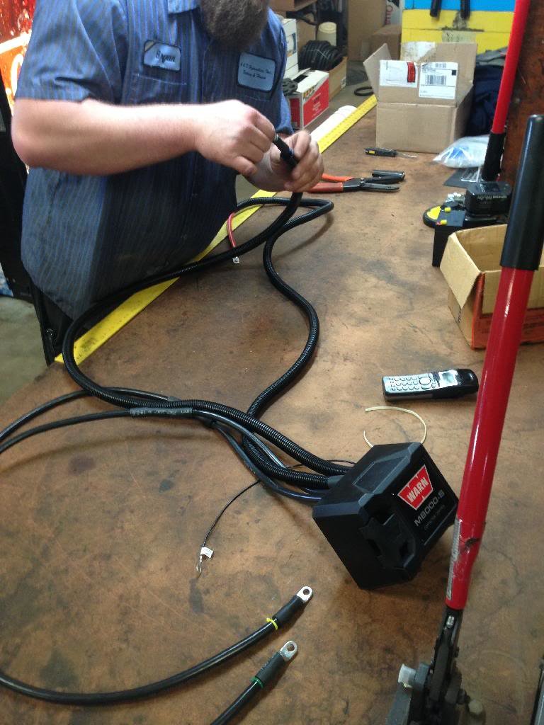

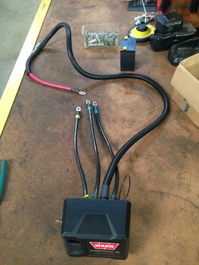

    I had to extend the factory cables by 4ft to accommodate where I'm going to place the solenoid under my hood. I had it cable spliced the proper way! Everything was heat shrunk and I had them put wire loom over all the lines....overall it turned out nice! Let's hope it mounts up lol

    Watch the resistance of that long power lead.
    I did the same thing (same gauge, appears to be same length, correctly spliced/lengthened) and had to change my lug from steel to brass because there was too much resistance on the longer power lead and it was causing heat issues at my winch motor. :eek:
    Changing to brass has helped, but the permanent fix for me is mounting my solenoid by my battery (custom battery tray) vs up where the ABS would normally be on our trucks (I'm non-ABS, so lots of room). My power lead extension goes from four feet down to two feet. Something to think about, or at least keep a close eye on!
    Edit: link showing what I'm doing (without the hose clamp, though):
