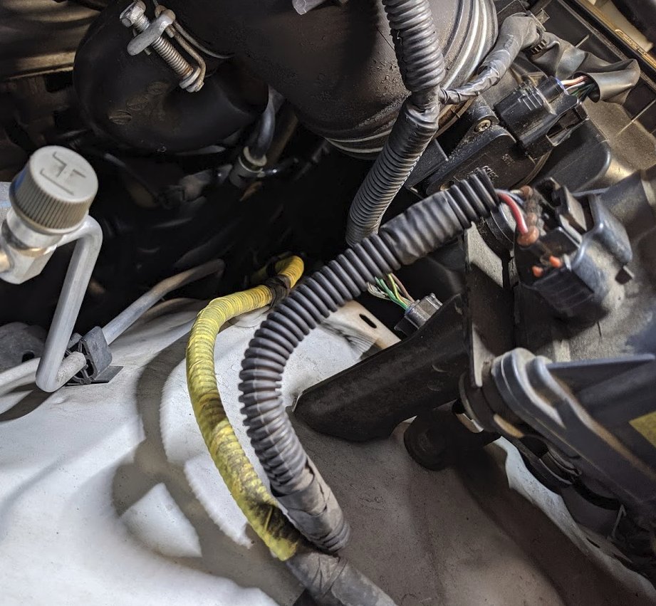

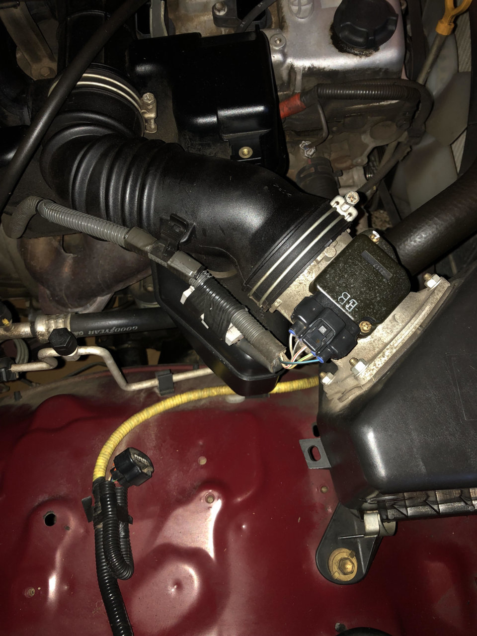

    That yellow cable should run to the under the air box to a airbag sensor. It’s factory. As for the not plugged in item it’s likely for cruise control

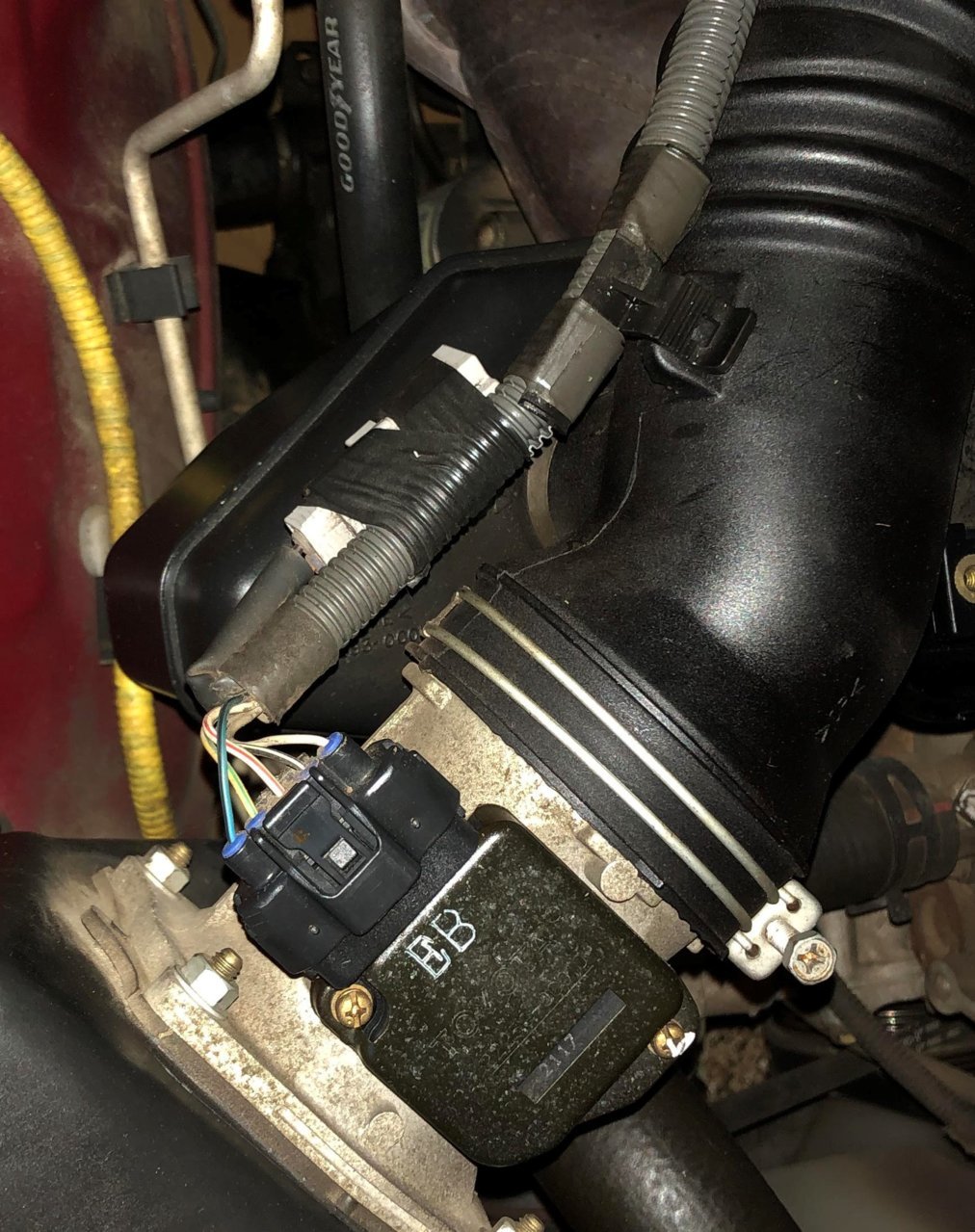

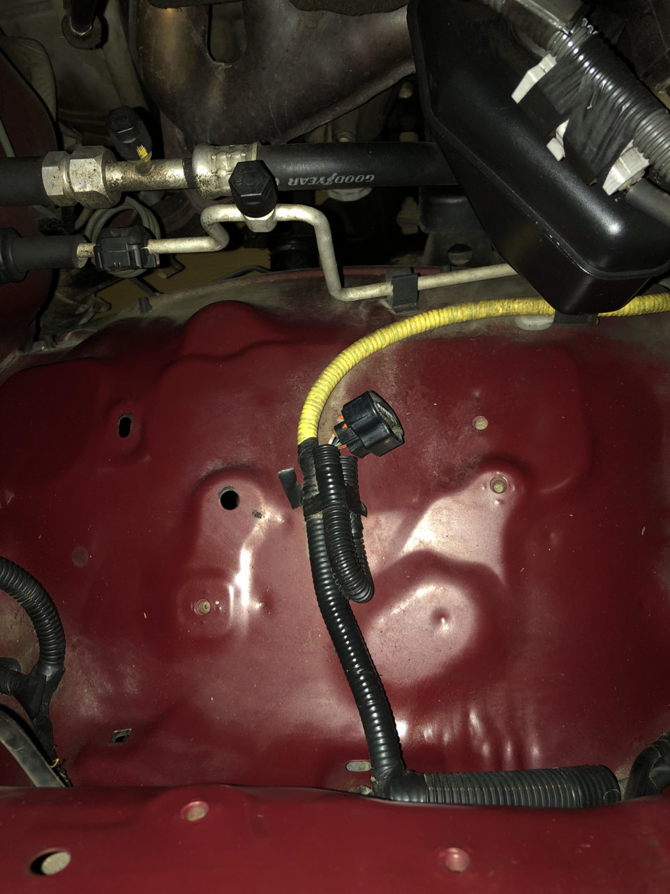

    yep, that plug taped up to his airbag lead is the plug for cruise control. Mine is in the same place. pic attached.
    As to that other plug (secured to the MAF plug), pfft - no clue. will keep researching.

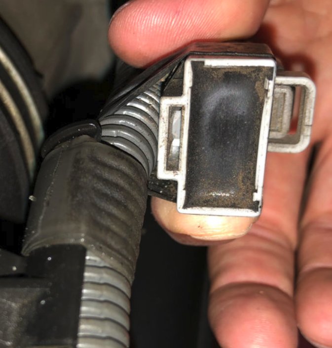

    So what is this
    Its secured right next to his MAF plug

    yeah I was wondering if maybe that had something to do with the P0110 code he's getting for the Air Intake Temp sensor...no idea if that's what its for or not though.

    the only plug I have coming off the MAF is to the igniter module and it looks nothing like that plug in his photo

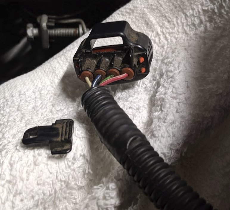

    oh lovely. the tab snapped off my cruise control connector when I went to unplug it to snap a pic of it. :censored::censored::censored:

    oh shit lol...does it still stay connected?

    yeah it plugs back in but its loose haha - zip tie time until I can track down a new connector. 17 year old plastic - right? lol

    @Area51Runner lmao let me know if you need to order some gorilla glue to reattach :spending:.
    I read on another thread that the fuse plugged in may be an ignition noise filter? Is that a possibility?

    Or maybe some electrical tape wrapped around it might keep it in place/connected, if it broke the way I'm thinking it did

    What color are the wires going to it. Probably a ground junction or a junction for power distribution

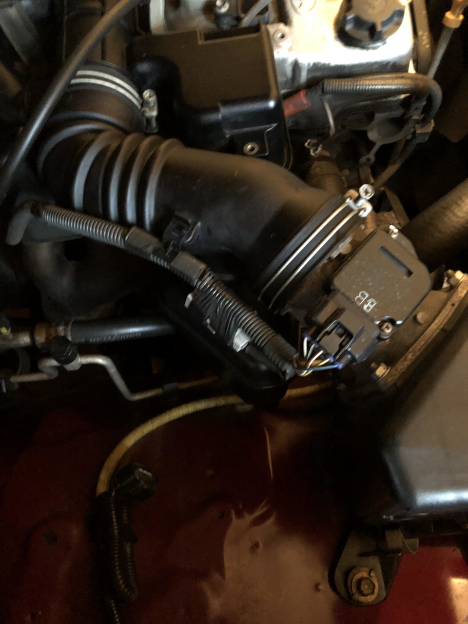

    Will snap another pic tomorrow but zoomed in showing the connector a bit better.

    Oh, you know what I think that’s a diode, it’s factory and should not be an issue

    yep but they're talking about a 97. whatever is plugged into it or however its sealed looks like it was done at the factory. Besides, trust me when I say - trust this dude here (I do).

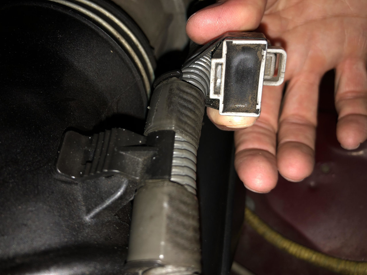

    hahaha look -
    I tried pushing it back through the open side of the connector - was just going to kind of see if it (the connector) would click into place, damn piece with the tab broke again. :bananadead::rofl: its toast. Default to ziptie. I'm sure I can find a connect for it somewhere.

    there should be a number on the connector somewhere. take that number to a toyota dealer and you can get a new connector for 5 bucks.. unpin the old, pin the new. done

    found it. e25 11150 - looks like PN 90980-11150
    Camelback wants $9 for it. He's working up an order for me now. Maybe just have him add it in. Will check locally also. Thanks bud.

    any connector starts with 90980 the number after that is the number you'll find on the connector
    fun fact, alot of the connectors also have the 1st and last pin of each row numbered!
