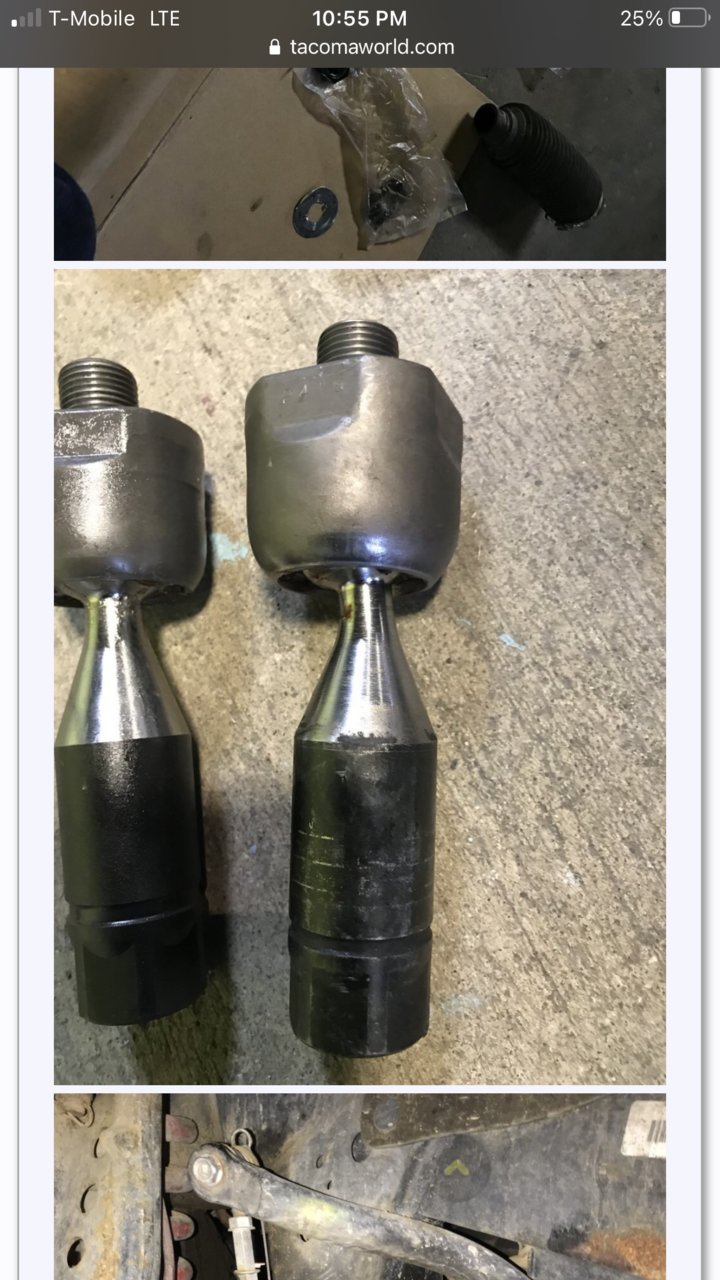

    Swapped out the outer tie rods and inner and that fixed the problem for me. Mine where bent up pretty good.
