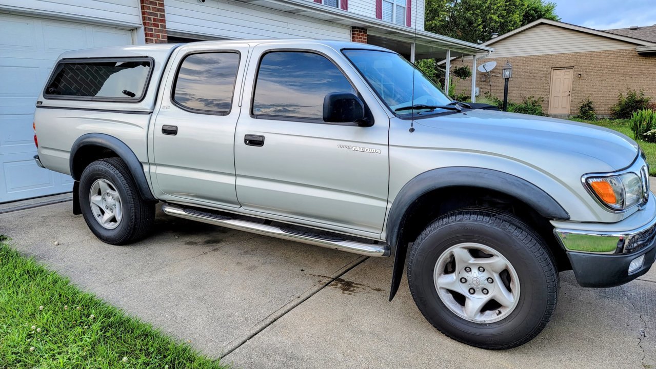

    Our 2002 Tacoma threw a rod this past weekend. California truck that we got from my father-in-law in December 2008 w/ 17k miles. Drove it from Orange County to Cincinnati. Never seen snow, rust free and trouble free until this weekend.

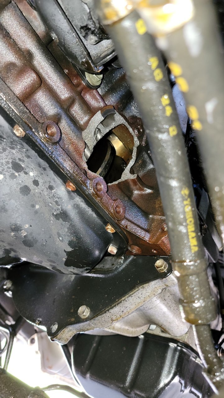

    We are now contemplating our options for either engine replacement or selling as-is. Truck is a stock 2002 Automatic 2wd Double Cab. We have put 65k miles Spring, Summer and Fall and park the car in the winter since it was a California truck as new and rust free. Block is shot so we are looking at:
    -Junkyard 5VZ-FE (cheapest/gamble) $1k?
    -JDM imported (mid range/gamble) $2500ish?
    -Rebuilt/remanufactured (most expensive) $4500-$6700
    Or Sell as-is, cut our losses and put that money into another truck.
    While I can turn a wrench I don't quite have the garage space to do a swap. So it would be in my driveway and I don't think I have the motivation to take this one on. So add$2k for install and any extras?
    Truck has been a 4th vehicle for us that we have used mostly for towing a motorcycle trailer as I play around with Motorcycles, scooters, etc and we have used it to travel to adjacent states to drag home the next project.
    Looking for opinions on what to do. Thoughts on what would be a fair value if we sold as-is for both buyer and seller.

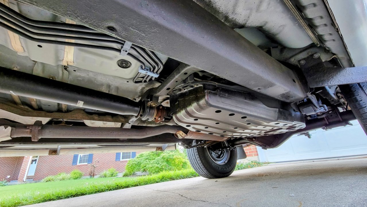

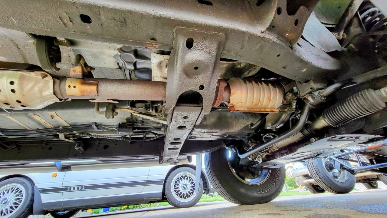

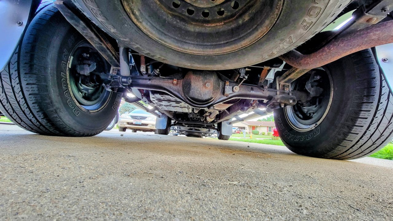

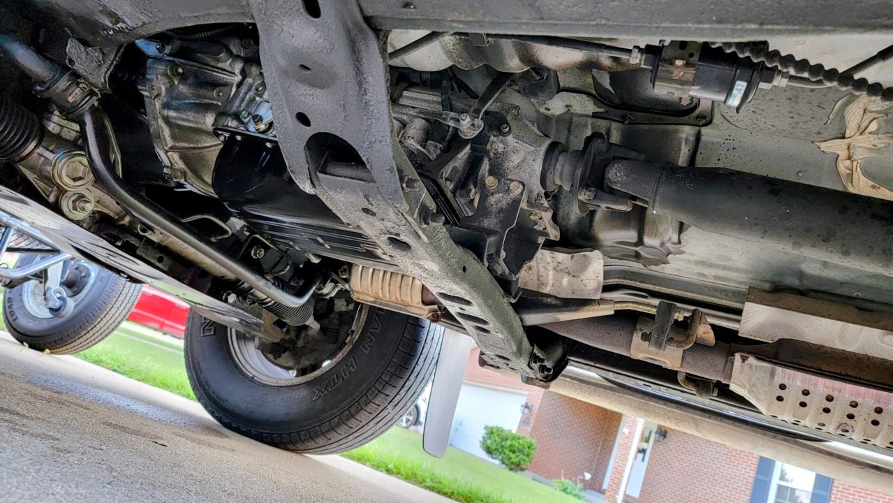

    Some additional photos of the truck and undercarriage.

    Yeah, pictures aren't really necessary here.
    The truck is worth being kept on the road. Just throw an engine in it.

    Any idea why it threw a rod? I think I've only seen or heard mention of that on 5VZ engines three times or so.

    Thrown Rod - as I understand it can happen under basically two conditions.
    -hydrolocked motor - water can't compress, something has to give. It's the rod.
    -Over revving - mass of the piston moving at X rpm puts too much stress and things let lose
    Guess a third could be caused by low/no oil and heating up of the rod bearing.
    So we were going to Lexington on I75, towing our 400 lb motorcycle trailer- had cruise on as we headed up I75 cut in the hill. Has a 5% grade. Slow moving semis in right lane. I used the cruise accell function to get back to 65 or so that the speed limit is there. I believe the truck had downshifted to 3rd and then unexpectantly to 2nd as we were climbing the hill. I heard what sounded like a rattle (timing chain slapping - I know it has a timing belt or nuts in a blender). I get the cruise to disengage and she upshifts. All seems ok - we go another 10 miles stop at McDonalds. No knocking, no check engine lights, no oil lights, etc.
    70 more miles we are outside Lexington, flat ground. As I accelerate briskly to pass a slow moving car merging she downshifts and that's all she wrote. I believe the damage was done coming up the hill when she downshifted into what I believe was 2nd and

    FWIW, people are selling 1st gen Double cab prerunners for $15-17k here on the west coast. Yours is low mileage and rust free. It’s worth fixing!
