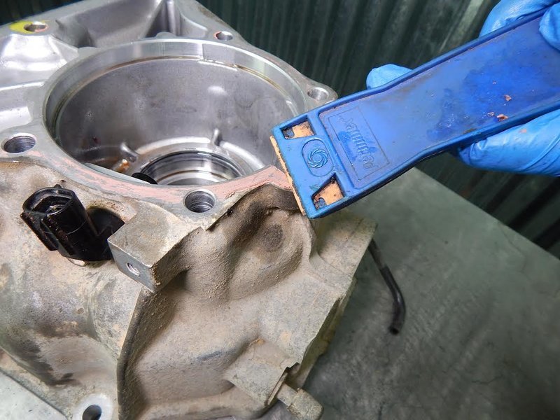

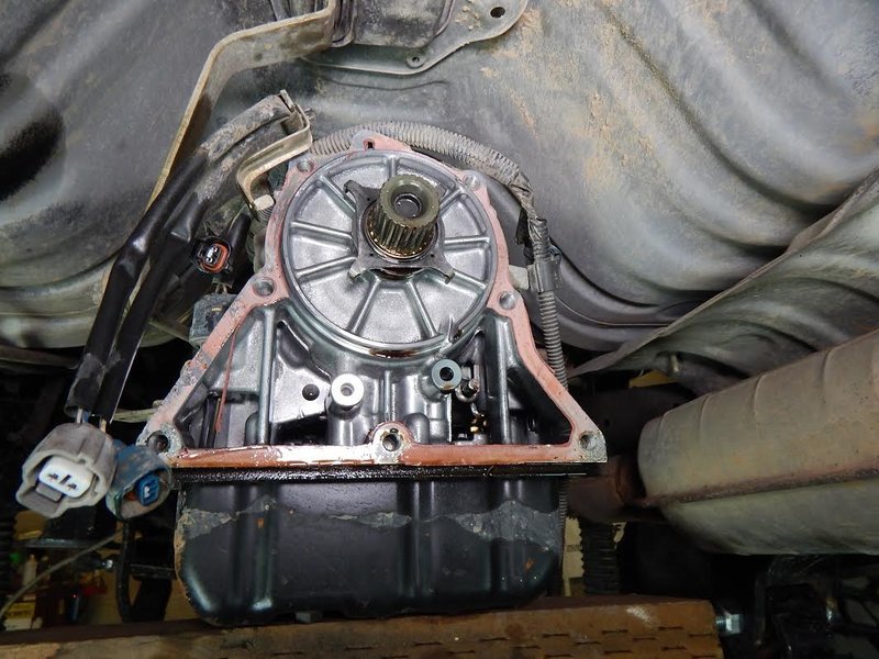

    Can't for the life of me get the tail-housing off the back of the transmission to remove that bearing for the coupler. I took the 3 bolts off the bottom and 4 from the inside. It does not even budge, I smacked it with a dead blow a few times. I think the FIPG is a big culprit of that.

    I know one time when I did it we took pics to update the instructions ( going to make new ones that are a more detailed than the current ones)
    The instruction/ photo guy who took them is at a doctors appointment right now.. If you wanta text me and remind me to check with him 8018859813..
    IIRC we had to get pretty aggressive with my rubber dead blow.

    So there shouldn't be anything holding it together if you removed the 7 bolts. Hopefully this helps. This is from the Low Range 2001 Double Cab.

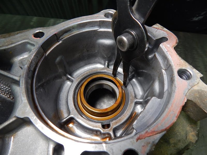

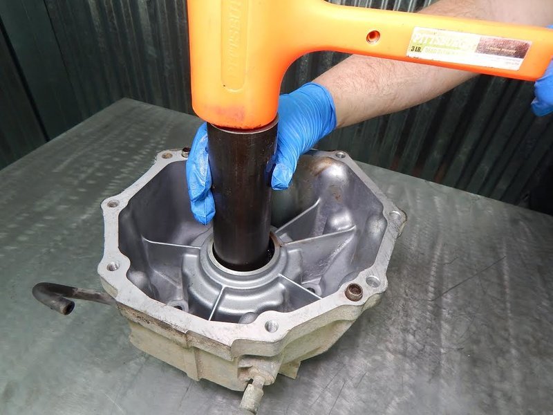

    Then pound the bearing out. Make sure you don't break the sensor (vss) we removed it then re installed it just to be safe.

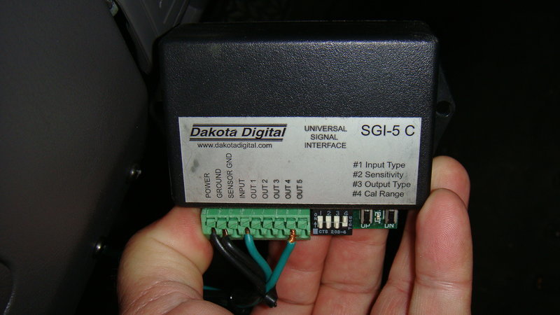

    If you need to purchase a new VSS, go with the Inch Worm product.
    I went with a Dakota Digital piece for the speedo correction. Works well.

    Got the tailhousing off. I let it sit for a day, trans fluid got in between the FIPG and the housing to make it easier to seperate. Couple wacks with the deadblow and it came right off. A good amount of trans fluid came out as well, even with the trans supported with a jack. Have a drain pan ready, I wasn't ready for that much fluid loss. Used a couple blocks of wood, a brass drift and the bearing came right out.
    @James at Lowrange do you see a problem reinstalling the orange oil guard. I took the bearing apart and I'm just using outer race to maintain proper spacing for the c-clip. The coupler fits through it with some daylight all around it.

    I guess it shouldn't hurt anything. Or you can just leave it all out.

    @James at Lowrange I just left it out it seemed like a good idea but might as well do it according to directions. It's all buttoned up and ready to accept the cases. I was talking about torque specs for the 7 tailhousing bolts with 14mm heads but I just tightened them up to feel. Tomorrow I'll bolt the cases up, then the shifter debacle shitstorm will ensue. Sorry for the repetitive posts but we all know how this shit works, one step forward 2 steps back :smash:.
