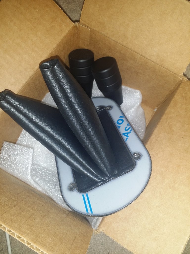

    Nice progress. Keeping an eye on this since I'm getting closer to installing my crawler.
    That shifter base looks very similar to this base I just picked up.

    @ToyRyd04 yeah that looks alot like my rad designs boot and retention plate. Must be nice for these shops to have a cnc plasma or a hydrojet. I think It came out really good considering the half-ass sharpie on paper drawing I gave him for dimensions.
