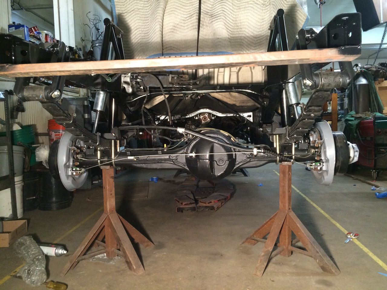

    @Rockbaron1 just got my 80 axle all put in, saw your post in the BS thread. Do have any details on your e-brake cable install. Pretty much have everything buttoned but the ebrake. You using a stock cruiser cable?

    I used the stock tacoma e-brake cable. On the fj80 housing I cut the little e-brake pivot arm off and welded it back on the other side of the diff. The e-brake cable on a stock 80 runs down the opposite side frame rail. I also pulled the middle of the cable along the back of the axle up higher to try and prevent it from getting hung up on stuff, i will try to find a pic. Its still a rock anchor though

    Heres a pic of the e-brake cable routing.

    @Rockbaron1 my rear parking brake setup looks different than yours. I had the non-elocker rear, my pivot point is on the drivers side. pretty sure I could make something work. Im just going to wait till we finish linking the front and get it rolling to deal with that. It's not my daily driver so having a working parking brake isn't super important.

    Yeah I had the stock elocker axle from the factory. Now that you mention it I think i remember the non-trd tacoma having the parking brake cable completely above the axle. You could probably find a way to make that work, or start looking for a new parking brake cable from an elocker axle. Hell i think even the fj80 cable could be made to work. I only used the stock one on my truck cause toyota replaced it when they did the frame and it was brand new

    Trds also had the brake cable routing above the axle, that's how mine was setup stock.

    My 03 trd off-road had the parking brake cable across the back of the axle under the leaf springs from the factory.

    That must be the year change then since mines an 02 and it was over.
