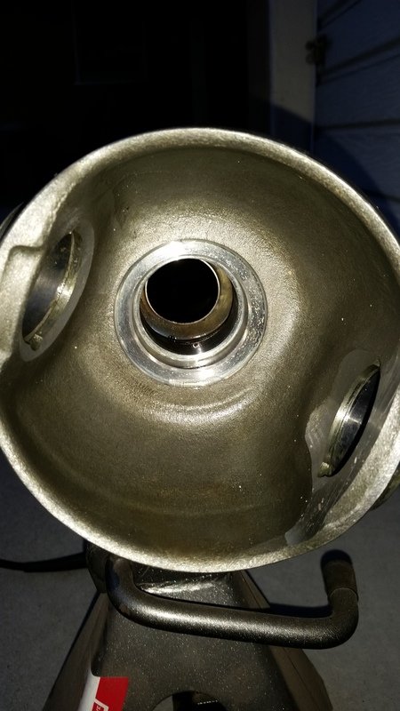

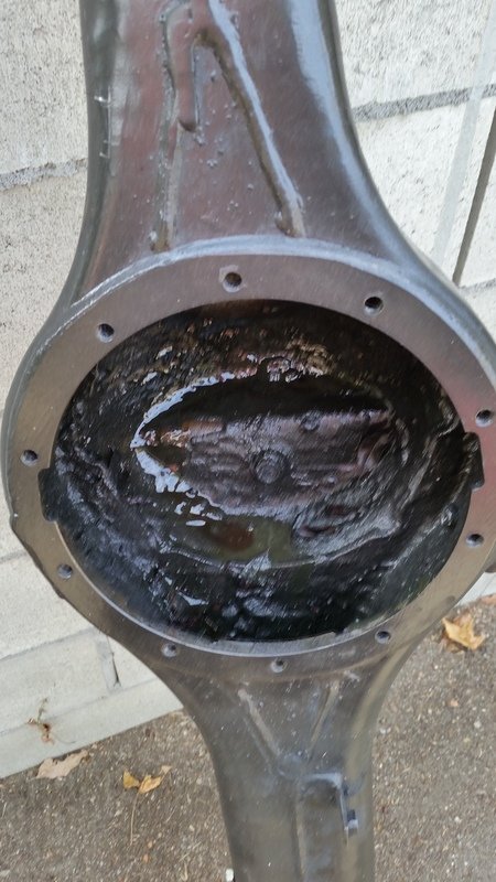

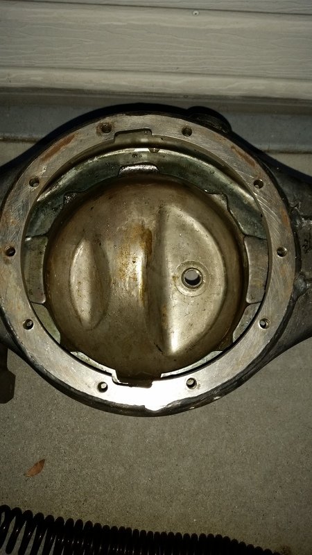

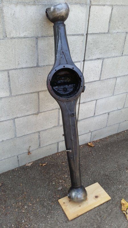

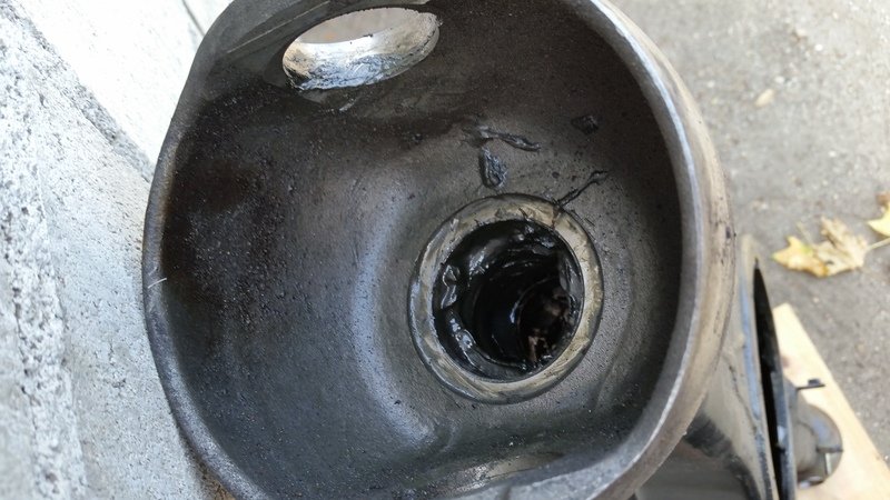

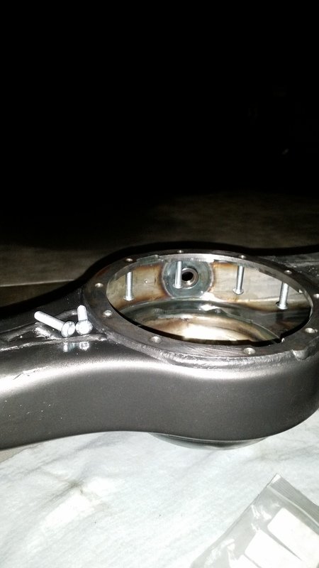

    Speaking of updates. Of course when I wanted to get some stuff done today on the truck, today had to be probably the one day it would rain all year in southern California. Actually I love the rain so it didn't slow me down too much, kinda helped me clean the housing. Going to pull the front diff and CV's today if the weather co-operates.
    Yesterday's progress - ready to do battle
    Letting gravity help me out
    Not so awesome
    Much better
    got it all clean then used my air compressor and heat gun to dry it out. Shot it with some wd-40 to keep it rust free.
    Got rid of the studs, putting grade 10.9 button head allen bolts in w blue locktite
    I also knocked out the old trunnion races
    DustStorm4x4, Pirhett and ChadsPride like this.

    That's one clean axle now.
