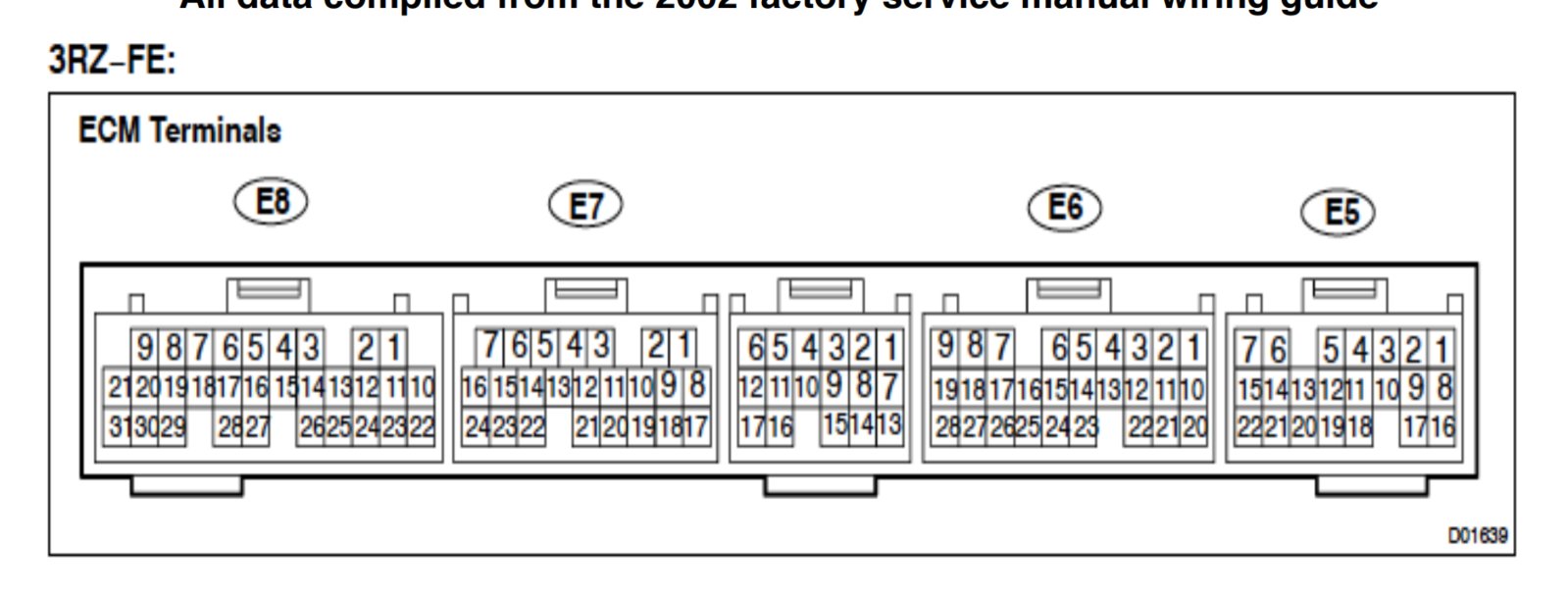

    You might jump the power at the Circuit Open relay and see if the truck stays running.
    But that really wont help diagnose anything.
    Check power on the connector to the following pins. Key On.
    E5- 16 -(White/Red)
    E5- 12 -(White)
    Ground on the following
    E7- 17 -(brown)
    E8- 5 -(White/Black)
    E8- 21 -(White/Black)
    E8- 31 -(White/Black)
  7. Apr 12, 2024 at 2:13 PM

    E5-16 and 12 both have power. E7-17 has ground and E8-5, E8-21, and E8-31 have ground.

    E8 - 6 -White/Black should be a ground as well.
    Other than that, I don't know why you have no CEL.
