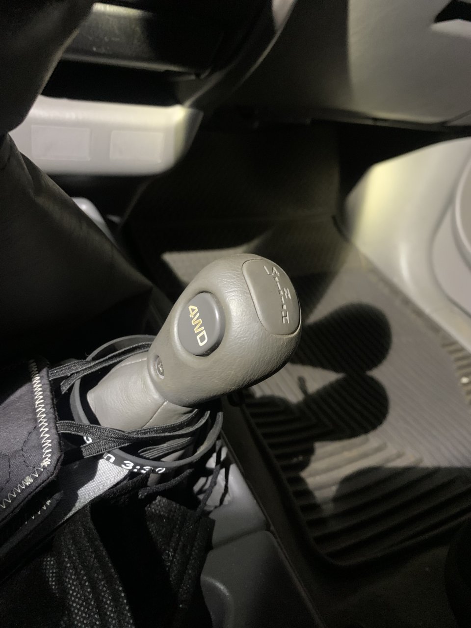

    I have a 02 Toyota Tacoma 4 high not working when pressing button any one had this problem before? Another thing I noticed is when shifting shifter to neutral light comes on and sounds like everything engages..

    Pictures?
    There shouldn't be a button for 4WD on the 1st gen Tacoma, it should be a J shift transfer case.

    Push button for for high

    Huh. o_O
    Never seen one of those in a Tacoma before, only in The 01'-02' Limited 4Runners.
    Bizarre didn't even know that was an option gor the 1st gen Tacoma.

    I have one on my '04 TRD OR.

    Push button 4hi is more common in the 2001-2004 than J shift. Only J shift 01+ I've seen have been a few on this forum

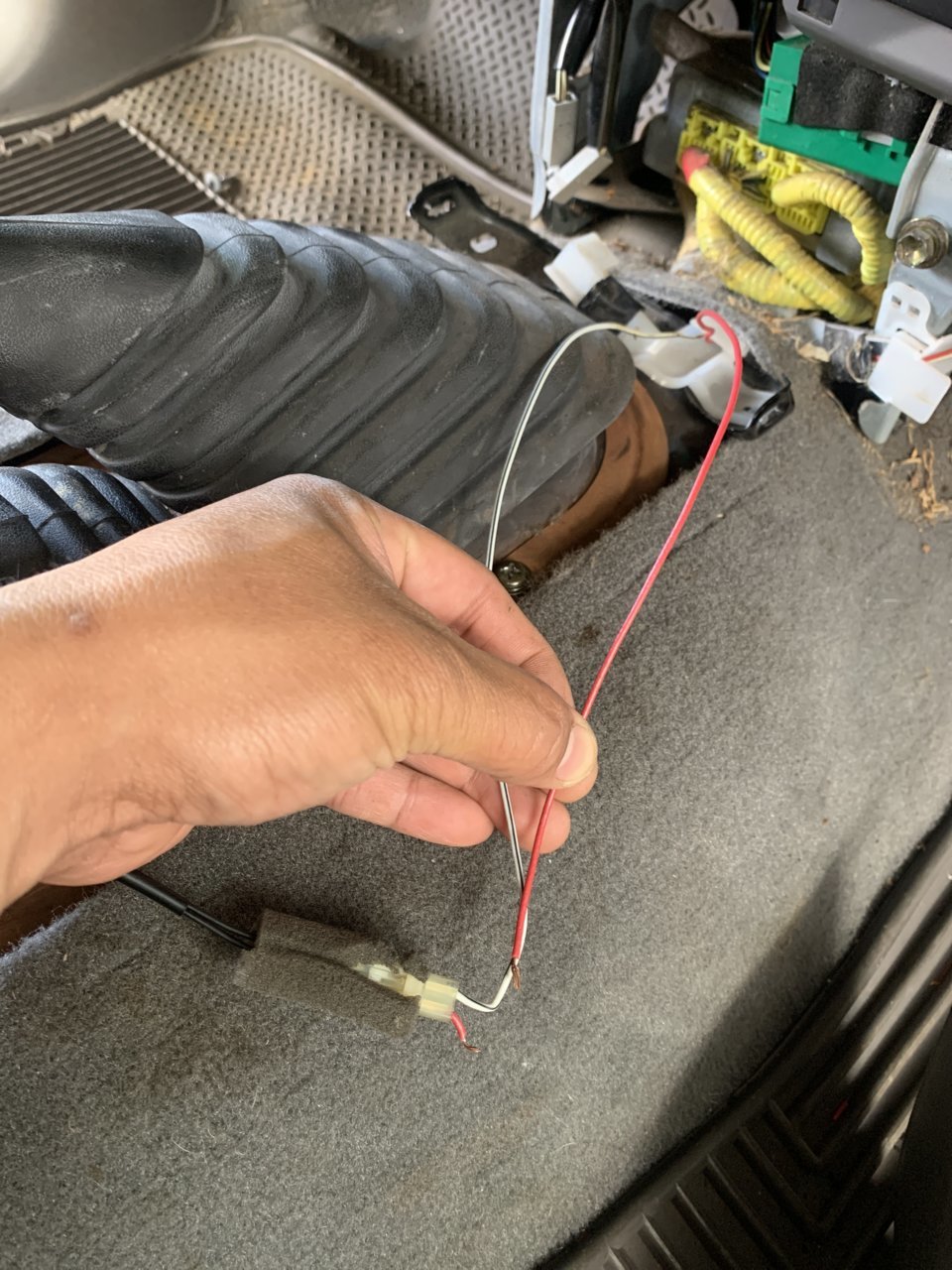

    Update on the problem I’m having.. found open circuit on 4wd 4high switch harness.. if any of you have this problem in the future check continuity between switch the 4wd module..
