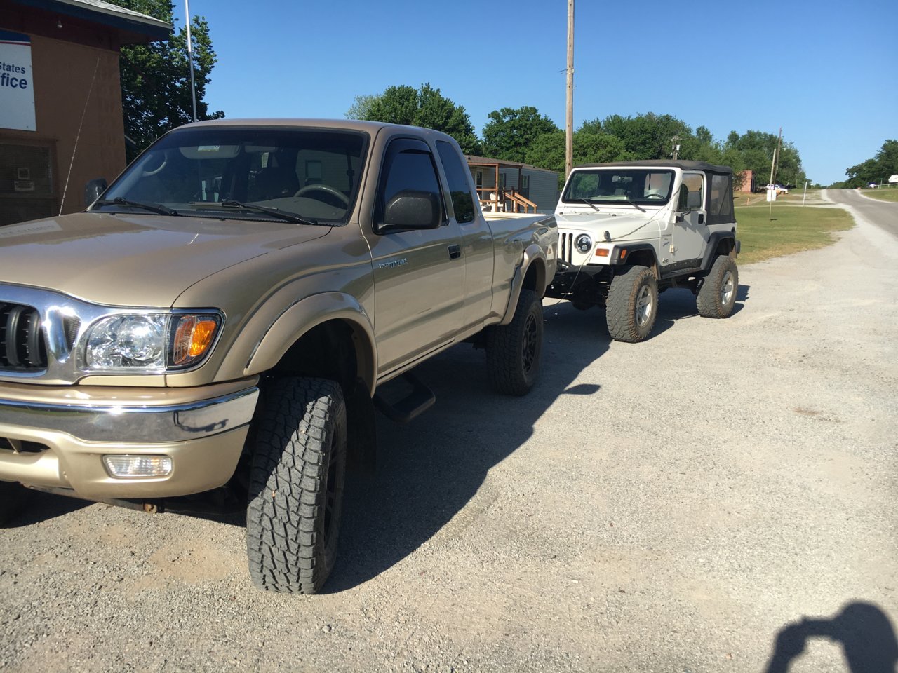

    I don’t know exactly how much these things weigh but it was pretty terrible trying to get it up the mountain.
    Down wasn’t Bad if you dropped it into second or low.
    Yes it’s on backwards, trying to get the weight as far forward.
    jbrandt likes this.

    I've flat towed my Jeep a handful of times about a 160 mile round trip. It doesn't love it, but I stay in the slow lane on the highway and don't get in a hurry. I do have to down shift to 4th and drop to about 50 going up slight grades. Taking the Jeep to CO next summer and for sure will not be towing it behind the Taco.

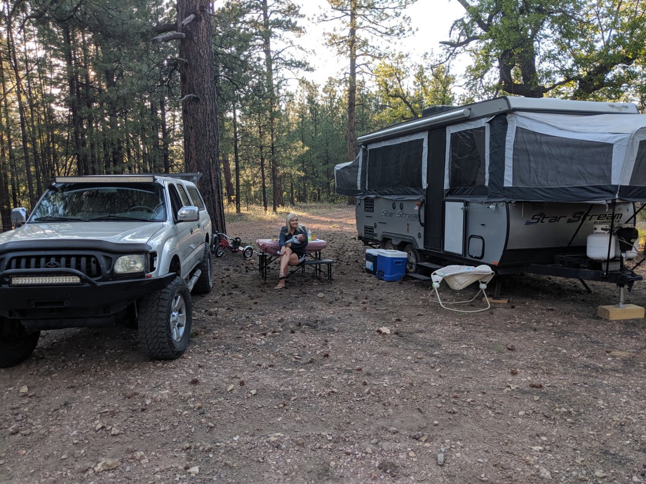

    Just kidding. I wouldn't tow more than 5k. I had my 04 taco maxed with my camper, gear, food, family and wood....the truck struggled but we made it..not very fast tho.
