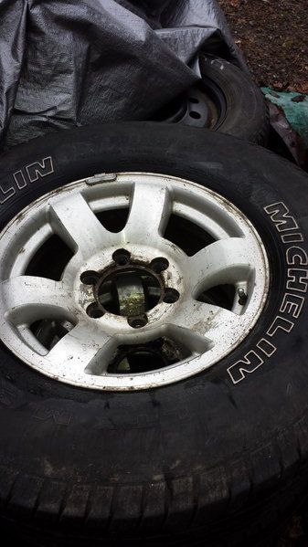

    Can I put these wheels on my Tacoma?
    Or do I have to look up the offset?
    I got them when this guy gave up his 02 Tundra, 4x I believe. I believed them to be stock, but I'm not sure.
    I had them on the 95 T100.
    Side note, the tires are Michelin MS 265 70 16.
    Thanks,
    Ken in NC

    Those ARE Tacoma wheels. They will work on your '13 just fine, but they will stick out about 1/2" more than stock.
