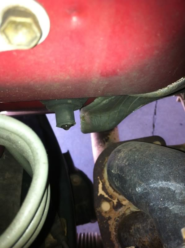

    Drain is in the passenger wheelwell/engine area right by the frame. Comes out of the blower box bottom, about a 1/4 black hose/line a couple of inches long. It can drip into your frame and cause rusting so many people lengthen it to get it past the frame opening. Daubers like to lay their eggs in it and seal it up.

    This is my 98. Same spot for 01-04s
    looking down on the passenger side firewall in the engine bay.
