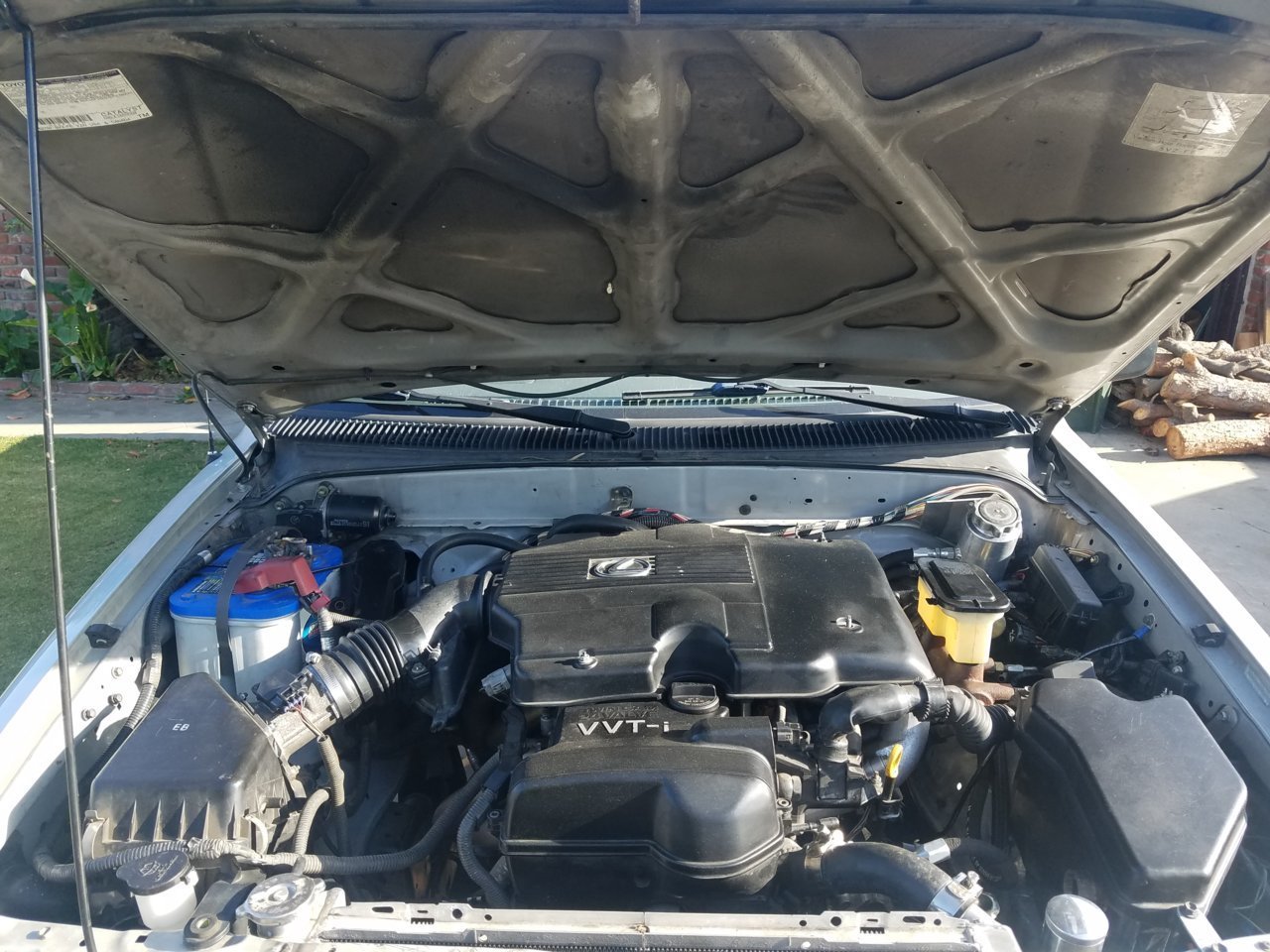

    Yeah man a 2JZ swap (or any engine swap for that matter) is NOT cheap, NOT easy, and will take a lot of time. That build thread I linked goes over the course of 2+ years. A 2JZ swap will require rewiring a majority, if not all of the truck, welding, fabricating, and mounting several new engine perches and cross members, it's just an immense amount of work.
    You are looking at at least a year of work, if not more and several thousand dollars in a donor 2JZ. Having the engine block is one thing, the wiring and mechanical systems used to run it is another.

    You are basically gutting the Tacoma, and putting the drivetrain of a Lexus sedan inside of it. The only original Tacoma mechanical components you'd retain is some of the HVAC system, and maybe the SRS system.
