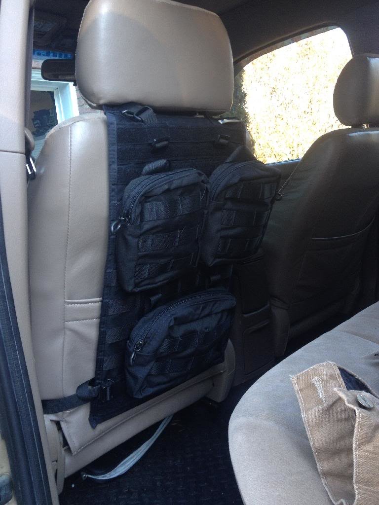

    i got a molle seat cover/storage for christmas and its great. i kept several things in a box in the bed and this now holds all of it and cleared up some bed space.

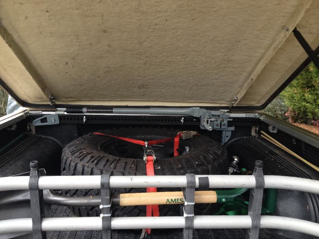

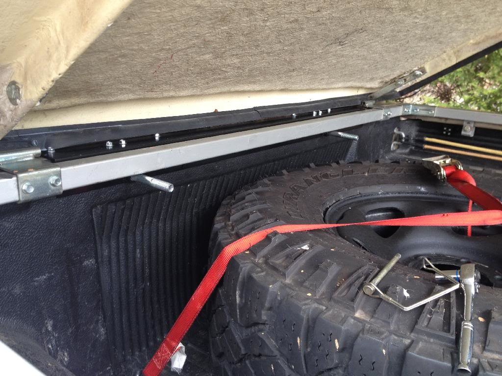

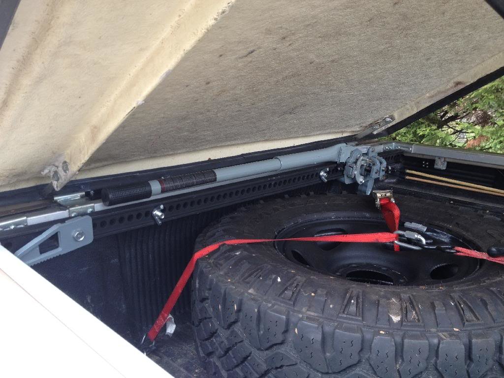

    Also got a smittybilt 54" hi jack. i wanted to mount it in the bed and still be able to use my tonneau cover. I came up with this design and so far it works good. 3' angle iron (2"x1/8") and two 1/2" bolts. unfortunately had to drill in the lip of the bed, but couldnt find a better alternative to this setup.

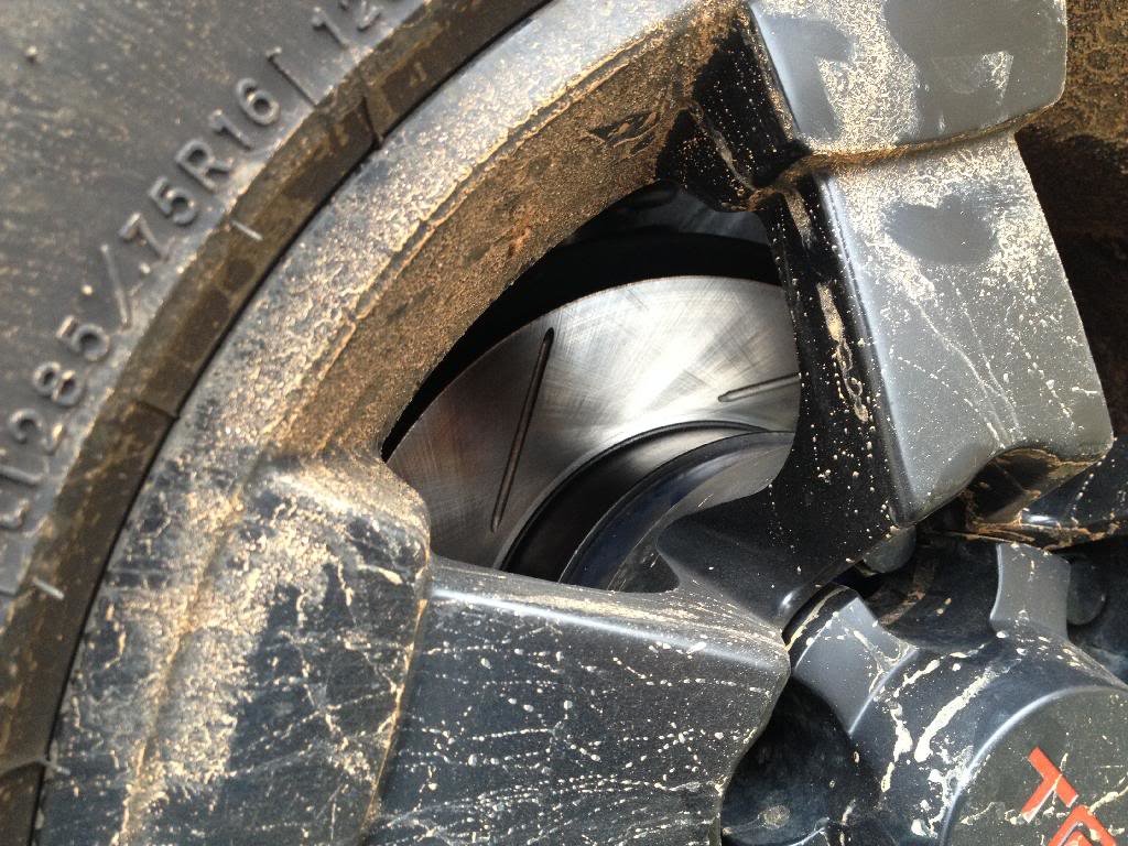

    And today finally replaced the brakes and lines. stoptech slotted rotors with hawk lts pads and 2" extended goodrich stainless lines. braking is much more responsive now and a huge improvement over the factory brakes.

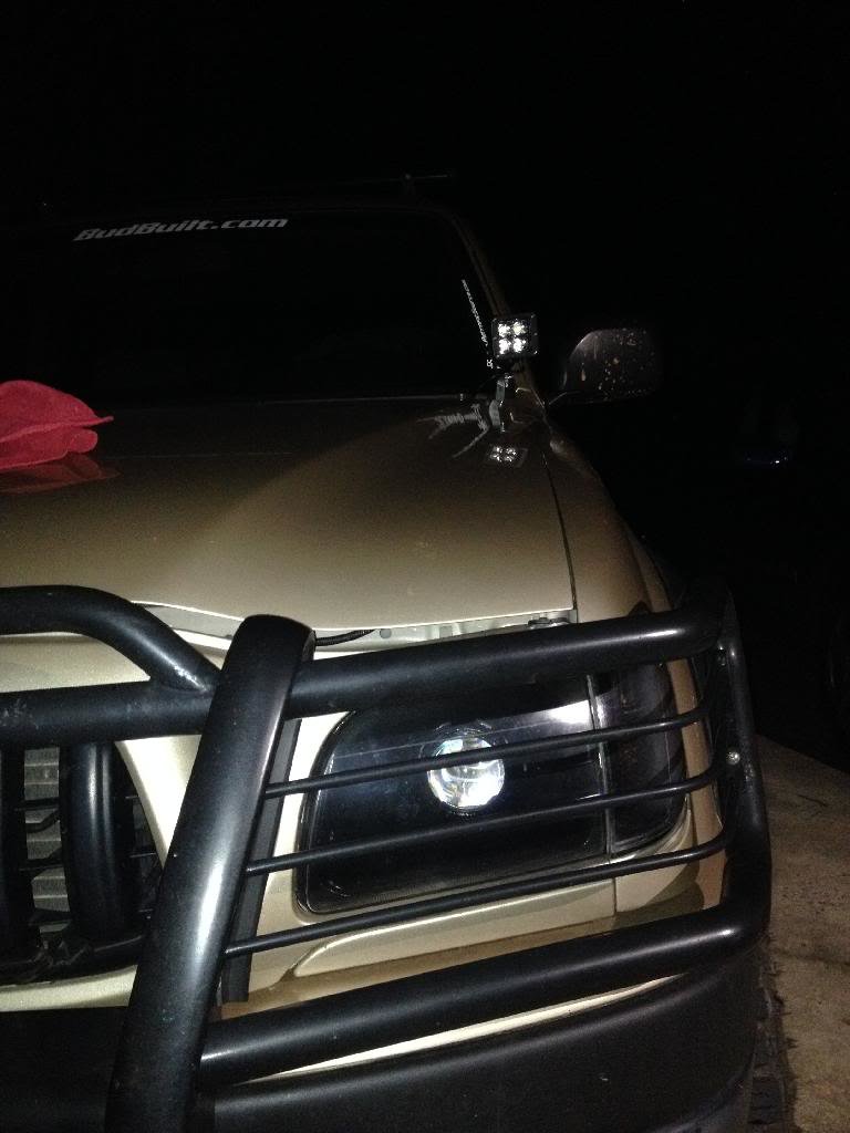

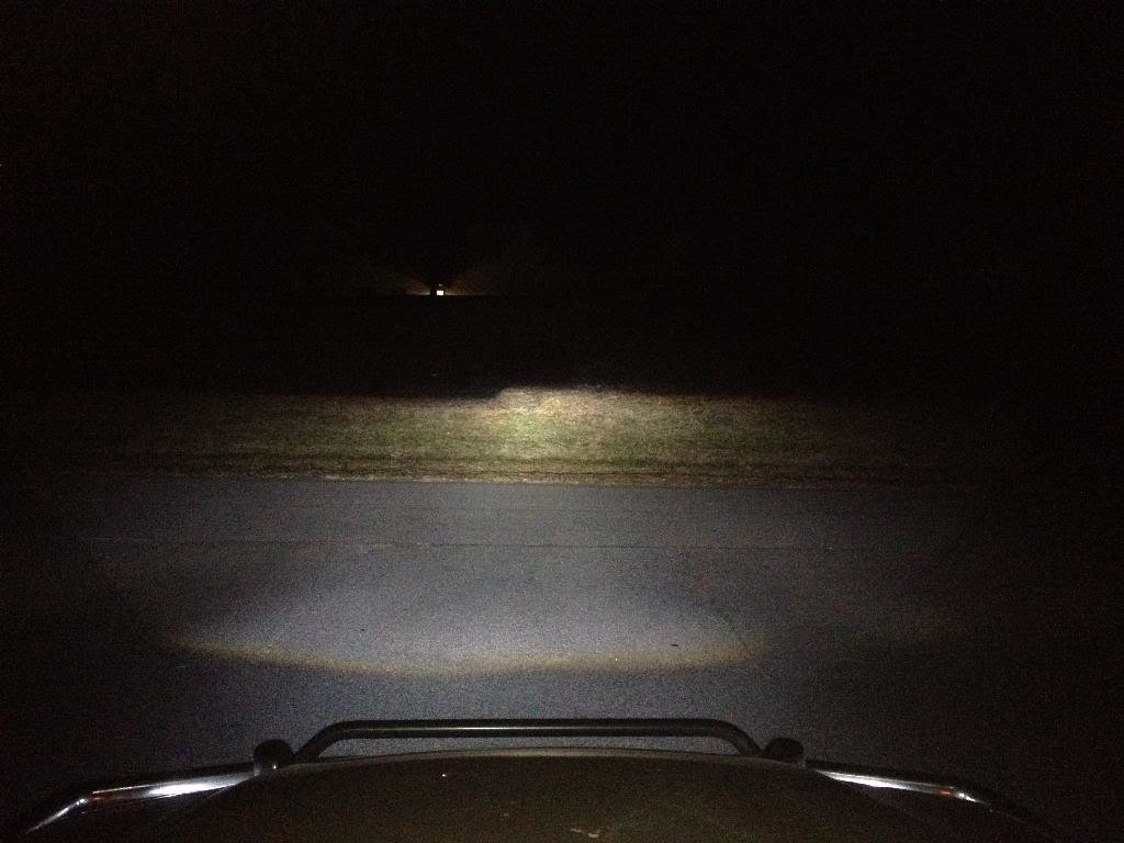

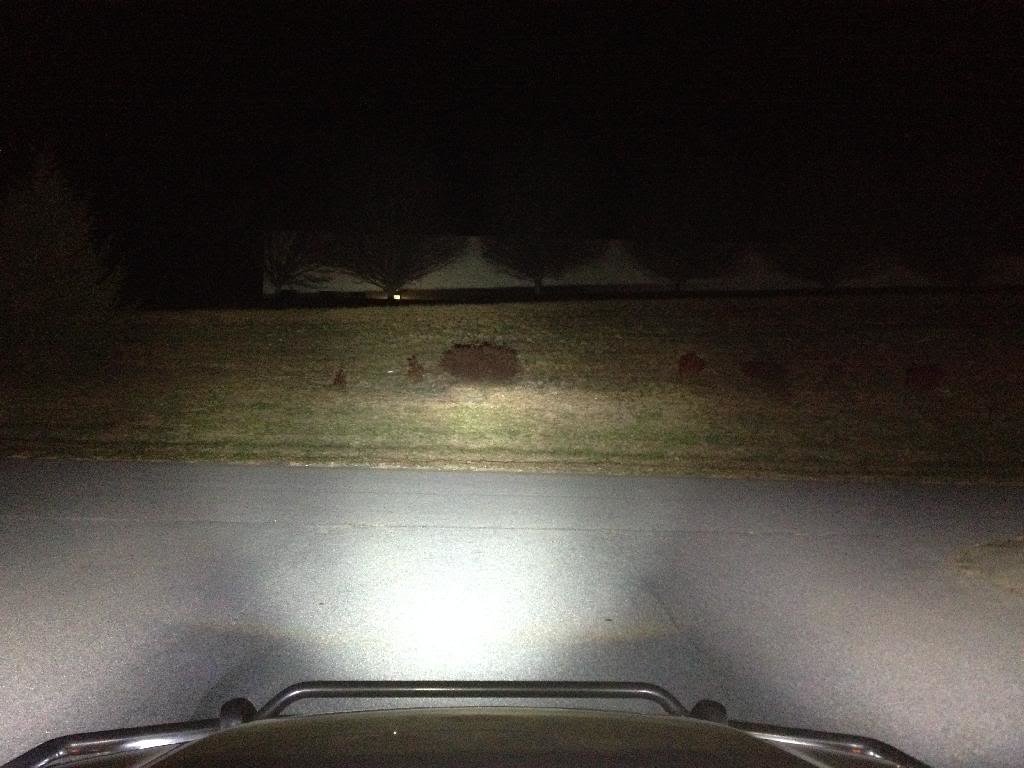

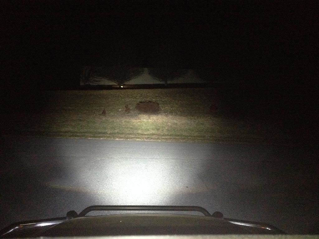

    duallys mounted. still have to tidy everything up since i ran out of time with new years festivities. as usual, pics dont show a bright these lights really are. pics are taken with an iphone
    1DE1C426-7255-4AAE-9F21-B9F1BEA8DE39_zps_1fee78478933e094c429ae8c1bae486bf1610b73.jpg
    Headlights only

    10" flood with headlights

    10" flood, dually floods, and headlights

    quick shot of the setup

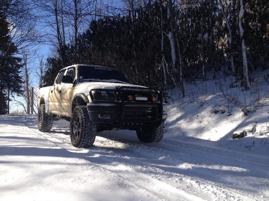

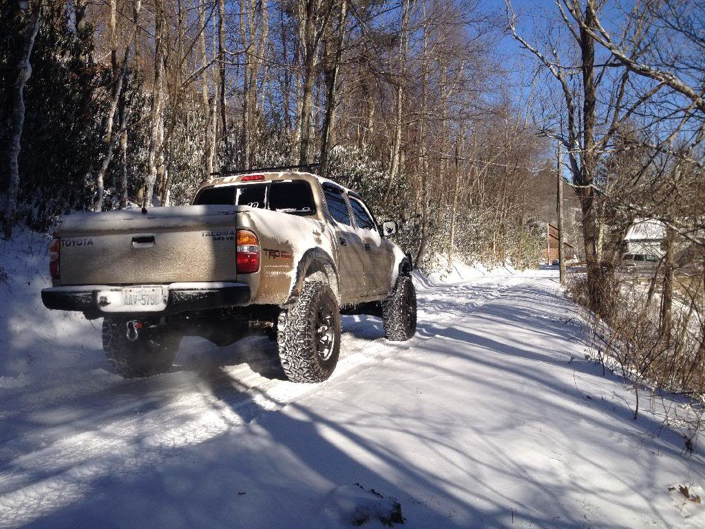

    finally some snow in the mountains

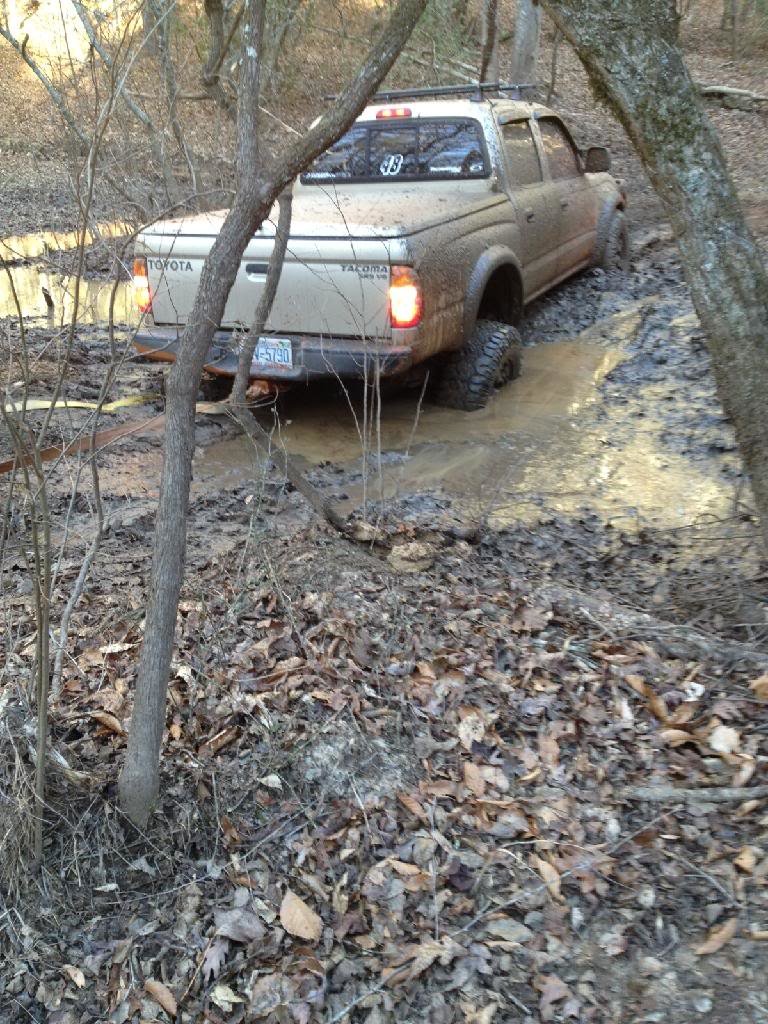

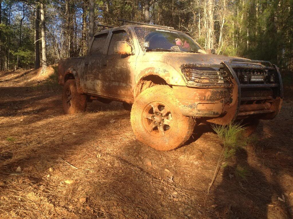

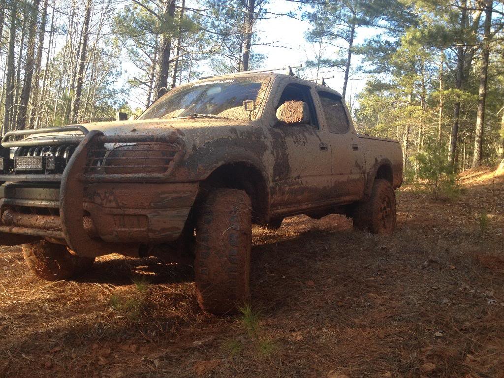

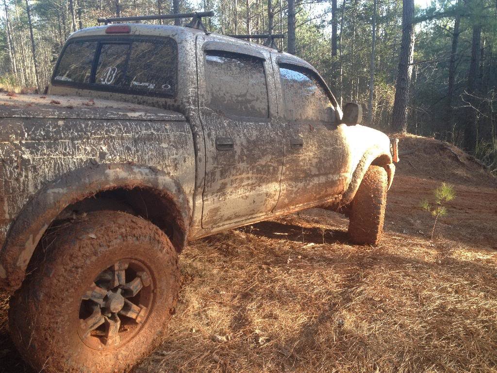

    went against my better judgement and went thru some mud yesterday. not looking forward to the cleaning but it was a good time. hopefully will have my sliders welded on next week as i really needed them pulling out a buddy in a tight spot, tree almost rubbed the entire body of my truck!
