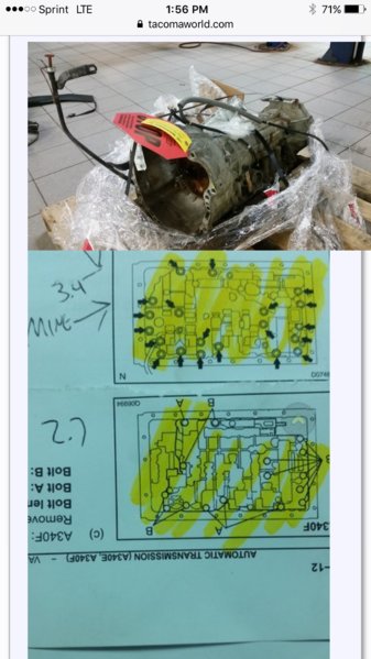

    This was originally posted Jan 27th But I guess I posted it in a conversation instead of the thread. Whoops still learning the forum.
    Well my transmission got here today. I originally hoped i would just be able to swap bellhousing and converters, unfortunately it will not be just a plug n play transmission like I had hoped. This transmission came out of a 03 Tacoma with 60k and a 2.7 engine.
    The problem is the 2.7 used throttle cable transmissions as well. So looks like I mightbe using the output shaft and extension housing of this transmission and swapping them to mine.
    There is another option that might work that I can't find any information about and that's swapping valve bodies in the transmission. I have included a pic of both valve bodies. I'm still don't know if this would work though.
    Won't give up on this project that easy!

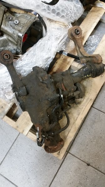

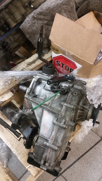

    This was an update from February 9th that I also posted in the wrong area.
    Been awhile since the last update. Transfer case and front diff are in..now just need to buy a few of the smaller pieces and the project should begin
