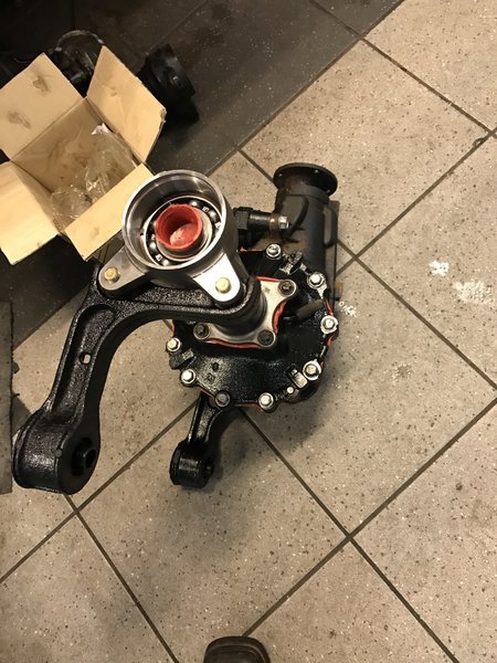

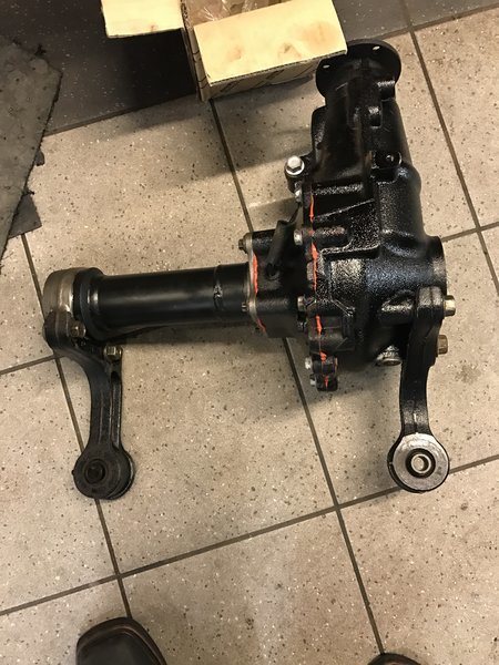

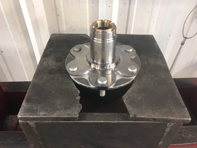

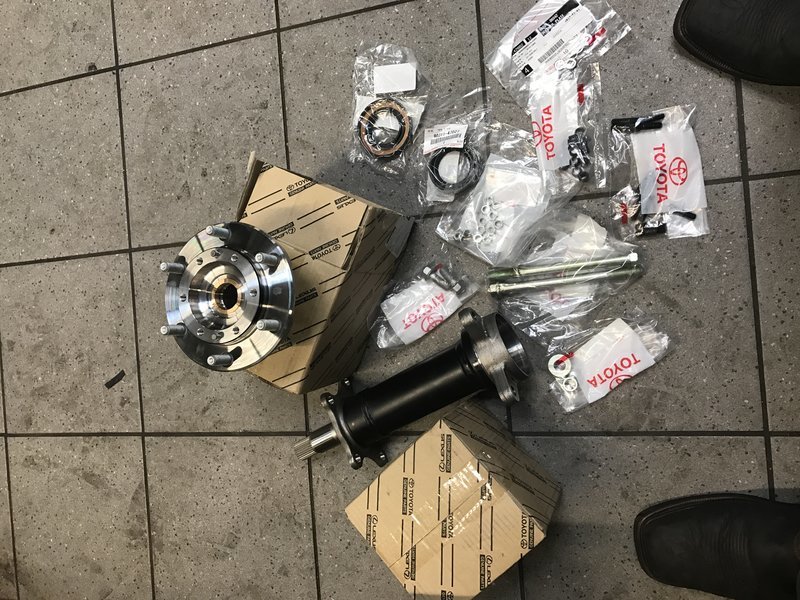

    Update got all the little bits and what not. Instead of searching for used hubs, lockouts, and non add tube I decided to use my good old parts department and buy everything brand shiny new
    In the picture it shows my two new hubs and completely new non add shaft tube assembly new seals for the diff. Also are the studs, cone washers, washers and nuts to bolt the lockouts on the hub. And there is also the nut and dust seals for the new wheel bearings which I do not have yet.
    Last things I need are wheel bearings and axles which I'll get new/reman aftermarket. And I need the speed sensor and interior trim and we are ready to start rippin her apart.
    Ps thank god I get these at cost otherwise this would have been pretty pricey and sourcing all these parts would have took a lot more time I was just not willing to give cause I'm both impatient and eager.

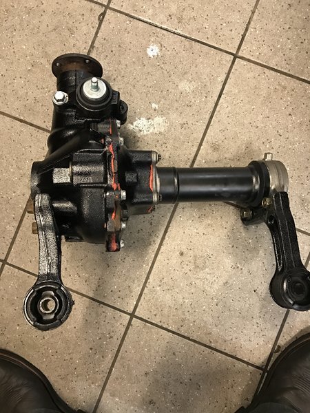

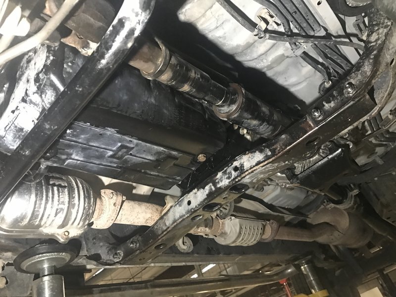

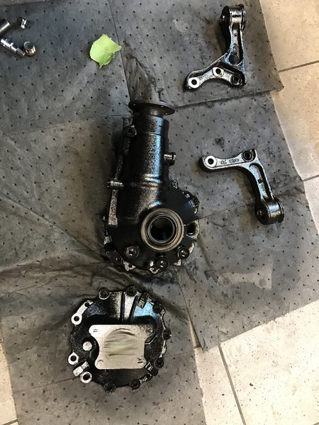

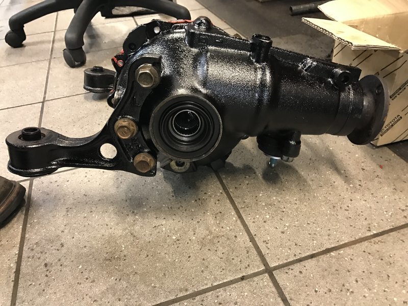

    Installed my non add tube, cleaned and painted my diff today. Also made sure it really was a 4.10 final drive. And it's all good ready to install in the truck

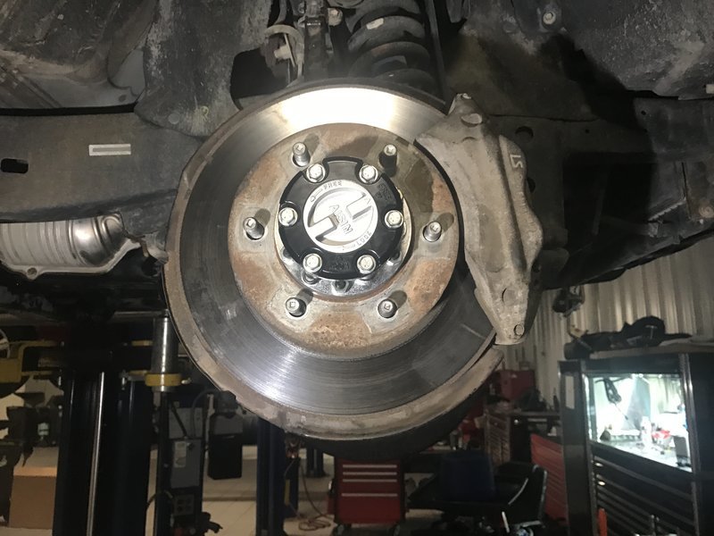

    Yeah but I bought new hubs and aisin lockouts which neither come with studs or cone washers. So 12 of each of those add up. Like I said I'm lucky I work at toyota so I get everything at pretty much cost.

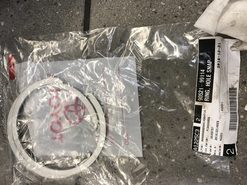

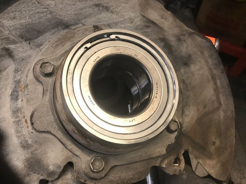

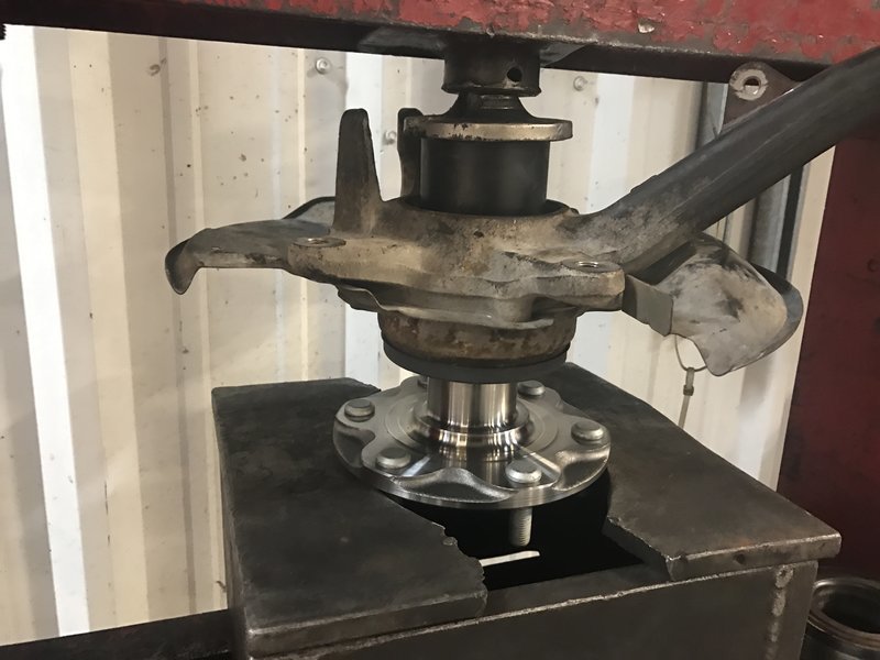

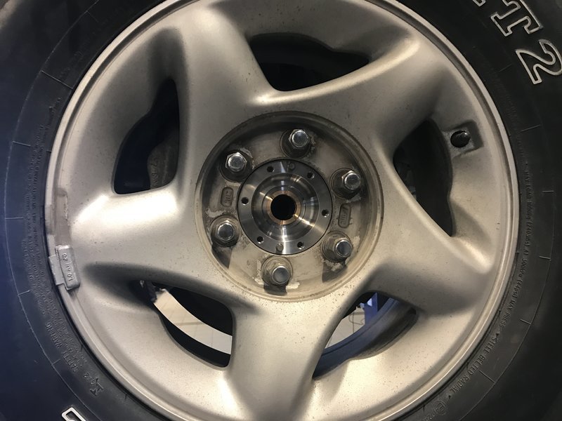

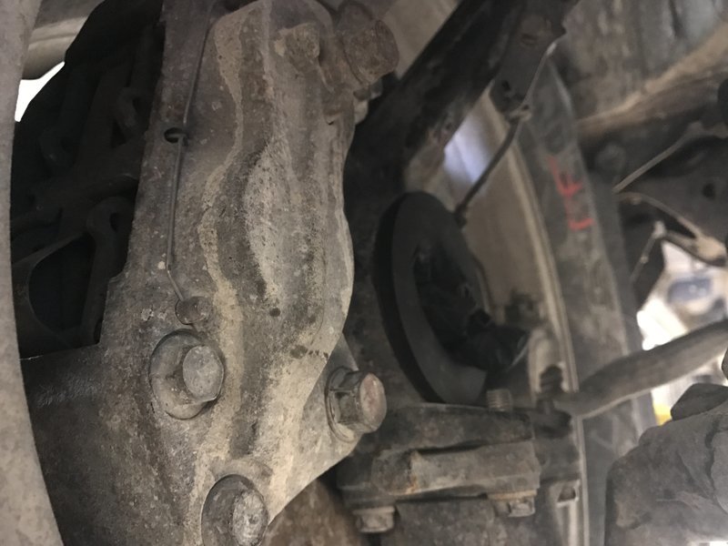

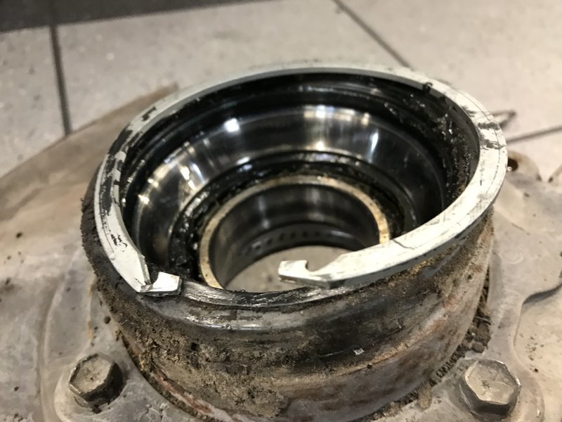

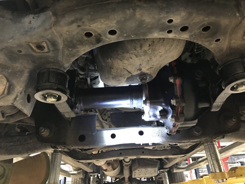

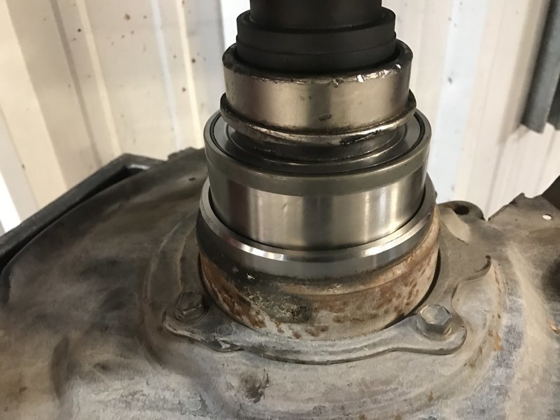

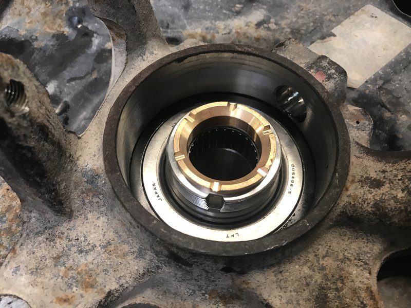

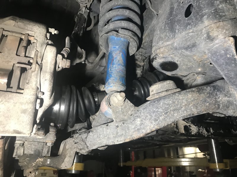

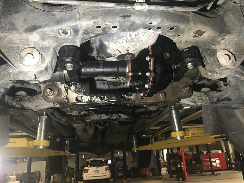

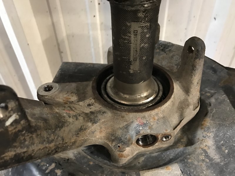

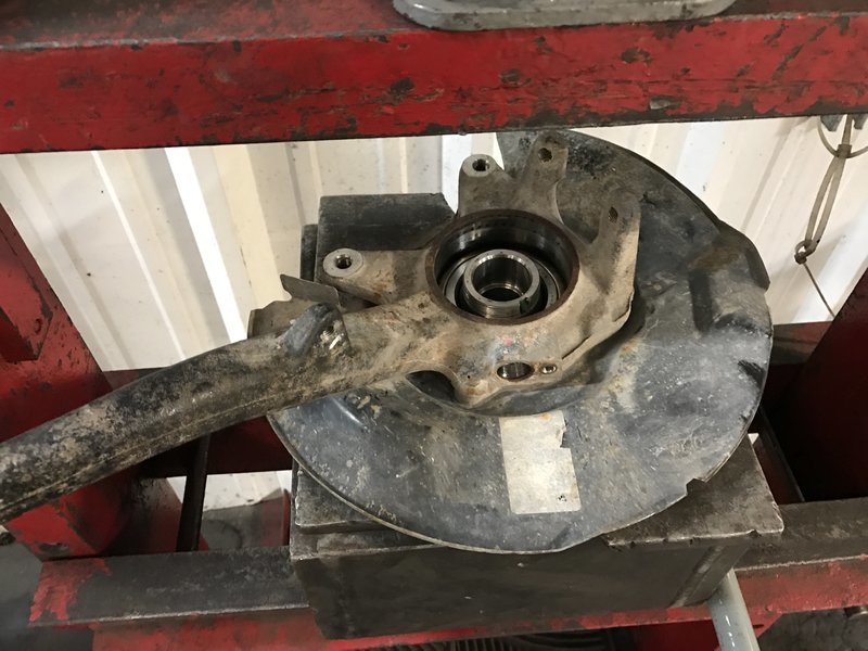

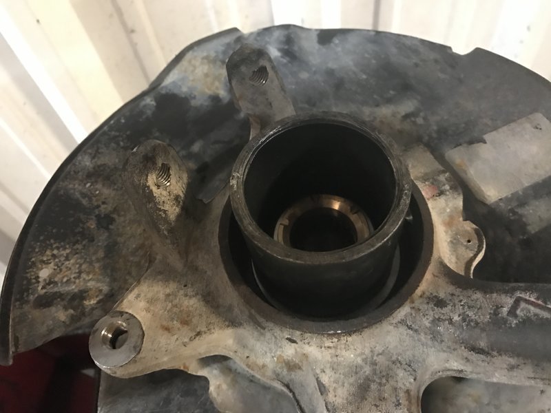

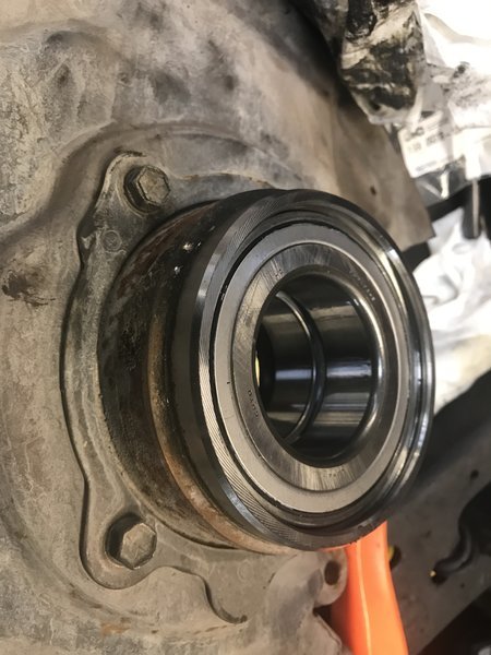

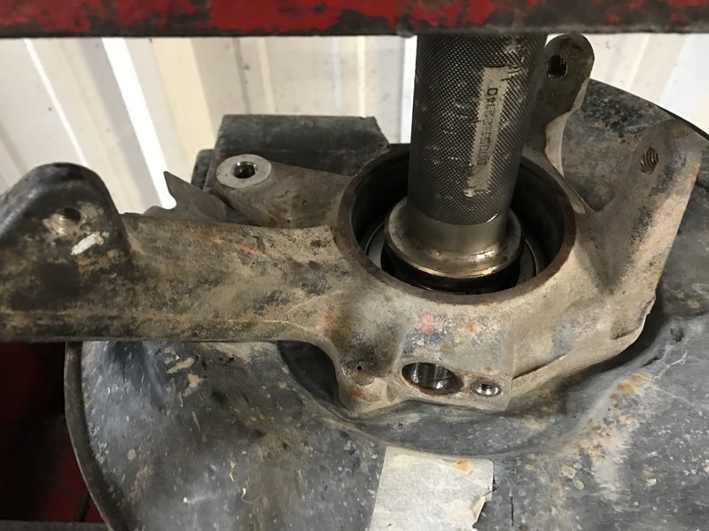

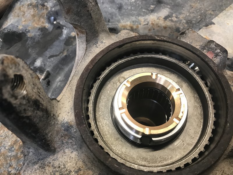

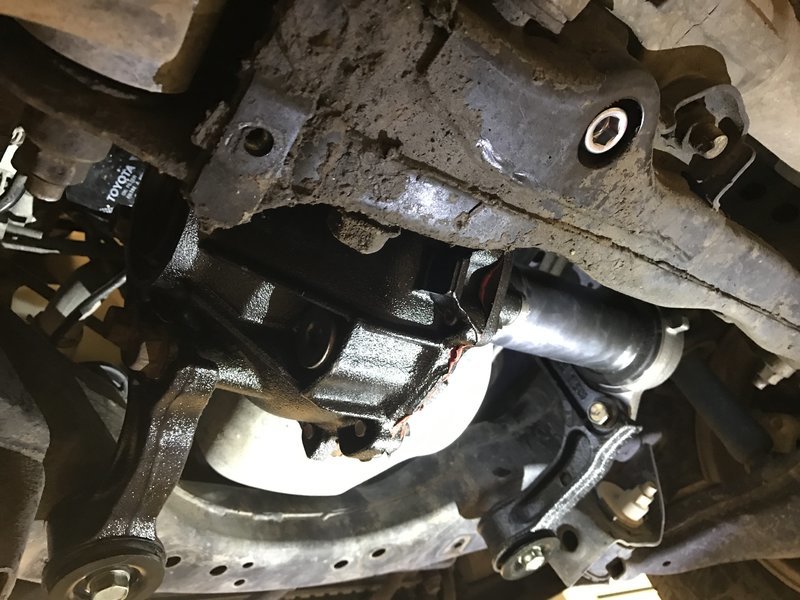

    Slow day at work on Thursday so i pulled my truck in the shop installed the diff and did all the press work In the knuckles including the new bearings, hubs and seals.
    Now I must say I work at Toyota and have done multiple bearings and we have pretty much every necessary adapter to do most yota bearings. This would be extremely hard for any old Joe Schmo shop to do. I'm not saying they couldn't but I'm just sayin ya know lol. If your going to do it yourself make sure you know how to use a press it is really easy to mess up your brand new bearings or break a spindle.
    On with the show for all you visual learners
    Took knuckle off of the truck removed 2wd bearing cover and bearing nut and got ready to press.
    Pressed the old 2wd hub out of the knuckle

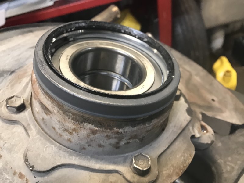

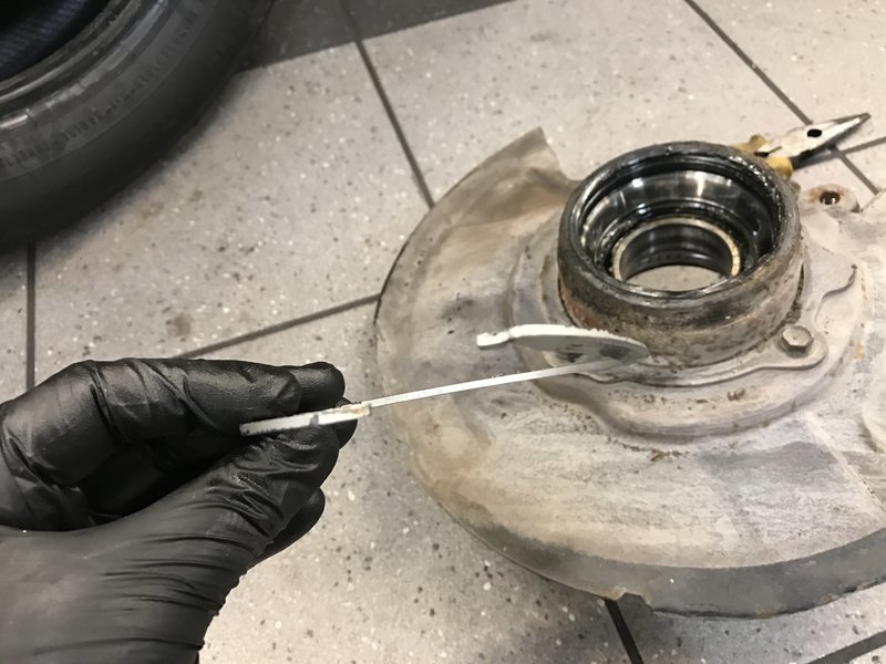

    This snap ring holds the other side of the bearing. Mines were jammed in there pretty good and got bent pretty good trying to remove them. I couldn't save/reuse them thank god we had some in stock.IMG_0051.jpg
    Better look at the snap ring.
    New snap rings.
    Pressing what's left of the bearing out of the knuckle.
    Cleaned the bearing bore and setup the press to install the new bearing.
    Bearing installed just past the snap ring groove.
    Installed snap ring.
    Installed new outer bearing dust seal.
    Setting up the new hub getting ready to press in.
    Pressing the new hub in the bearing/knuckle assembly. Be very careful during this step, it is really easy to mess up your new bearings and push the inside race out of the back side of the bearing. The next picture shows more clearly what I used to support the inner race.
    The hub is already pressed fully in the knuckle /bearing assembly here. Notice the adapter I used supports the race so I don't mess up the bearing. You could easily use a big enough socket but I didn't have one so I used this that we had lying around the shop.
    The installed hub/bearing/knuckle assembly.
    Reinstalled abs tone ring. This just slips right in there no problem.
    I forgot to take pics of the last 2 steps but after this all you do is install your new bearing nut and torque to 174ftlbs and then install your inner bearing seal and your done.
    Rinse and repeat the other side.

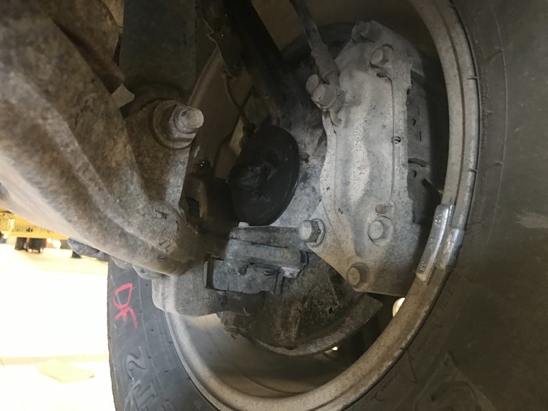

    Reinstall your new knuckle assemblies and your new knuckles are ready to accept cv axles.

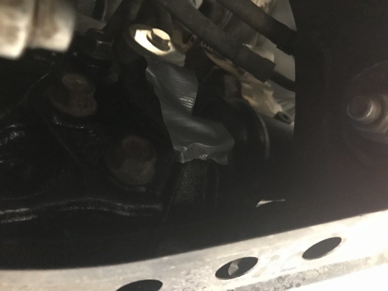

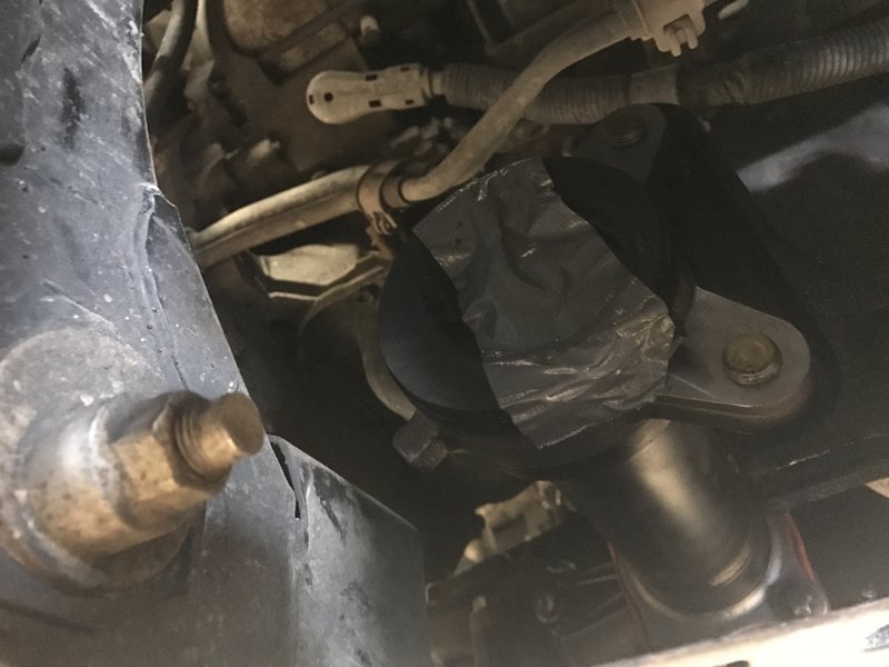

    I put a glove around my inner seal because I'm not putting the axles in at this time to protect water/dirt from getting in my new bearings.
    The rest of the pictures are of the diff installed and I put gloves around those seals too to avoid getting water/dirt/debris in the diff too.
    Hope you all enjoyed the show.

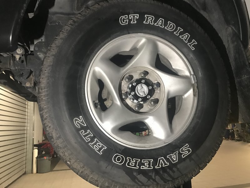

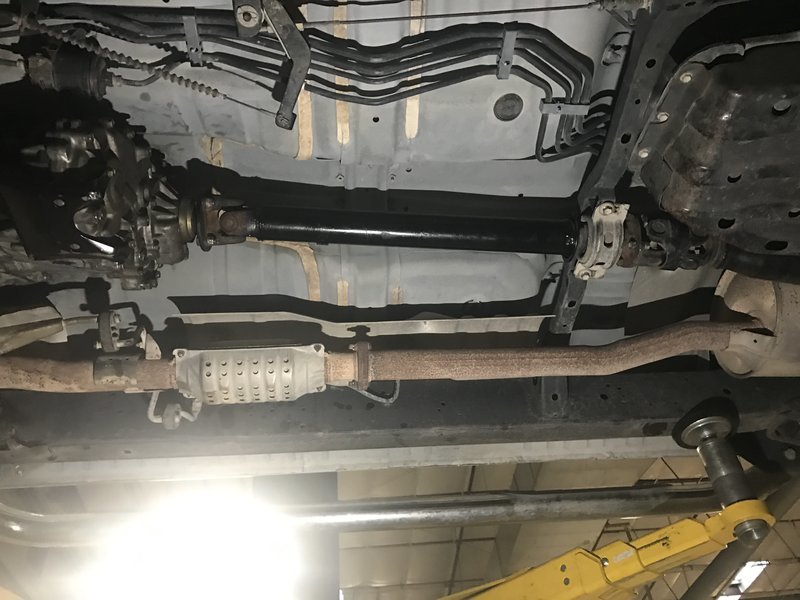

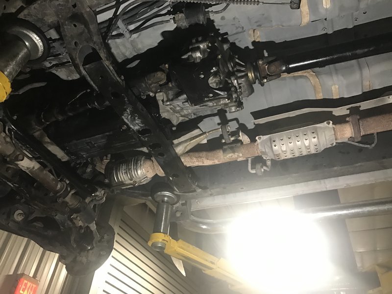

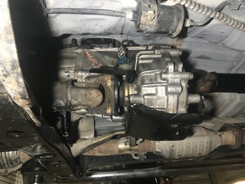

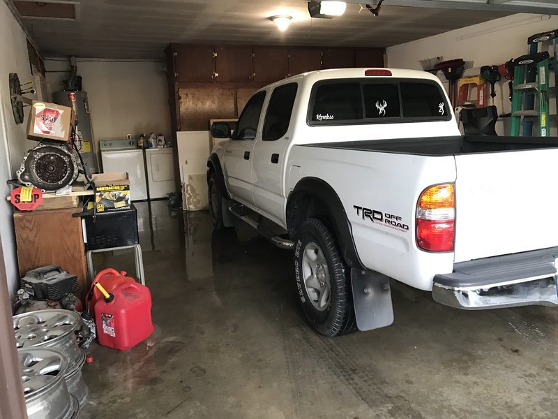

    First picture of the truck y'all have seen buttt..
    Who's ready to drink and install a transmission?
    Starting on it now

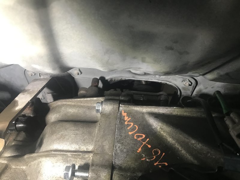

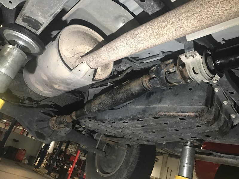

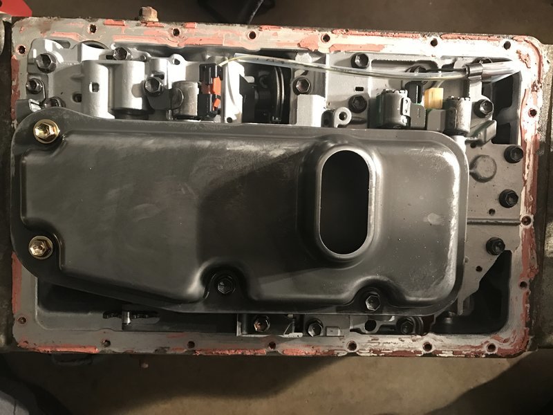

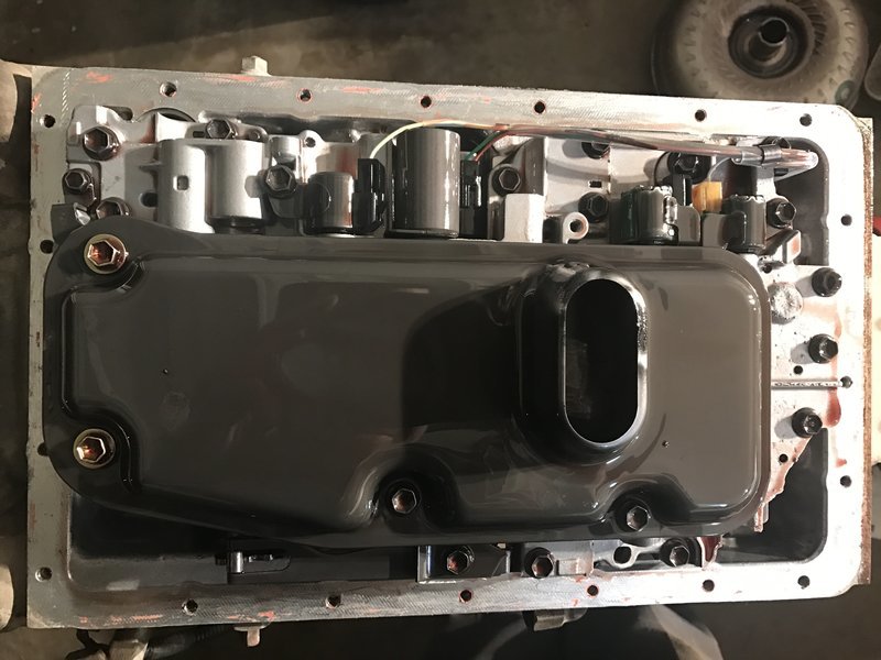

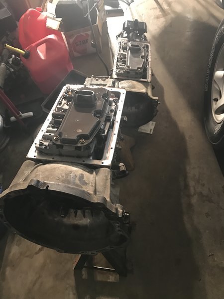

    Not documenting this part but the trans swap has begun. Started at midnight and between taking lots of breaks and stuff took me 3 and a half hours to pull.
    Looks like I'll be able to swap valve bodies, top picture is the new tranny bottom is the old. Gonna finish this up tomorrow and while I'm doing that I'll drop my driveshaft off to get shortened. IMG_0074.jpg IMG_0073.jpg

    Conversion is complete and successful. Just need a speed sensor and interior trims and it's done. Thanks for everyone's help I'll be updating this thread as I do more things and button up the conversion on the truck. Once again thanks guys.
    Ps I got lucky swapping valve bodies worked
