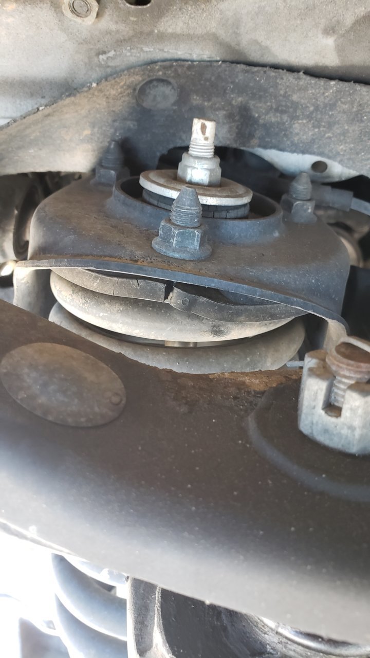

    So I picked up an 03 TRD 4x4 double cab, supercharged with a 6" (I believe) fabtech lift. Long story short the suspension feels horrible and kind of shaky. I noticed a rhythmic....bounce i guess, at speeds over 50mph. Jacked the truck up and got some play from side to side in the tire, up and down had no play. so I replaced the outer tie rods (inners had no in/out play so i left them). The steering feels fine on paved roads but on a fire service road with decent washboard its unmanageable. There is decent play in the steering shaft so I am going to weld that in the next day or two but I think the coilovers are original from the lift install several years ago. This will be my new daily as well as my camping rig so I need to make sure its 100% before I switch from my current 02 dcsb.
    So heres the question. I have read that I can use the RCD bilstein 5100s and eiback 620 coils to replace the current ones but I am having a hard time confirming that this will work with the first gen tacoma and fabtech lift combo. I apologize for asking a question with so much info available during a search. The answers are just diluted and hard to be 100% that I am going to order the right stuff. Any help is appreciated, thanks in advance.

    I thought the Fabtech lift included giant spacers to space down normal height/travel coil spring/shock.
    Maybe you can find the specs of the Fabtech shocks and compare the extended length and minimum length to Bilstein specs.

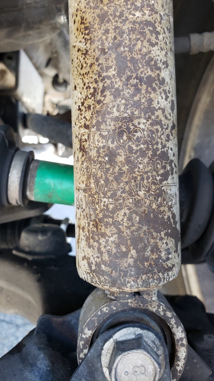

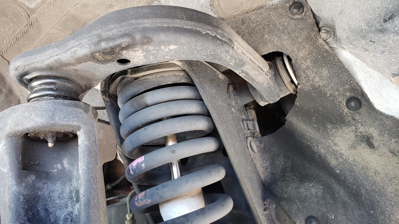

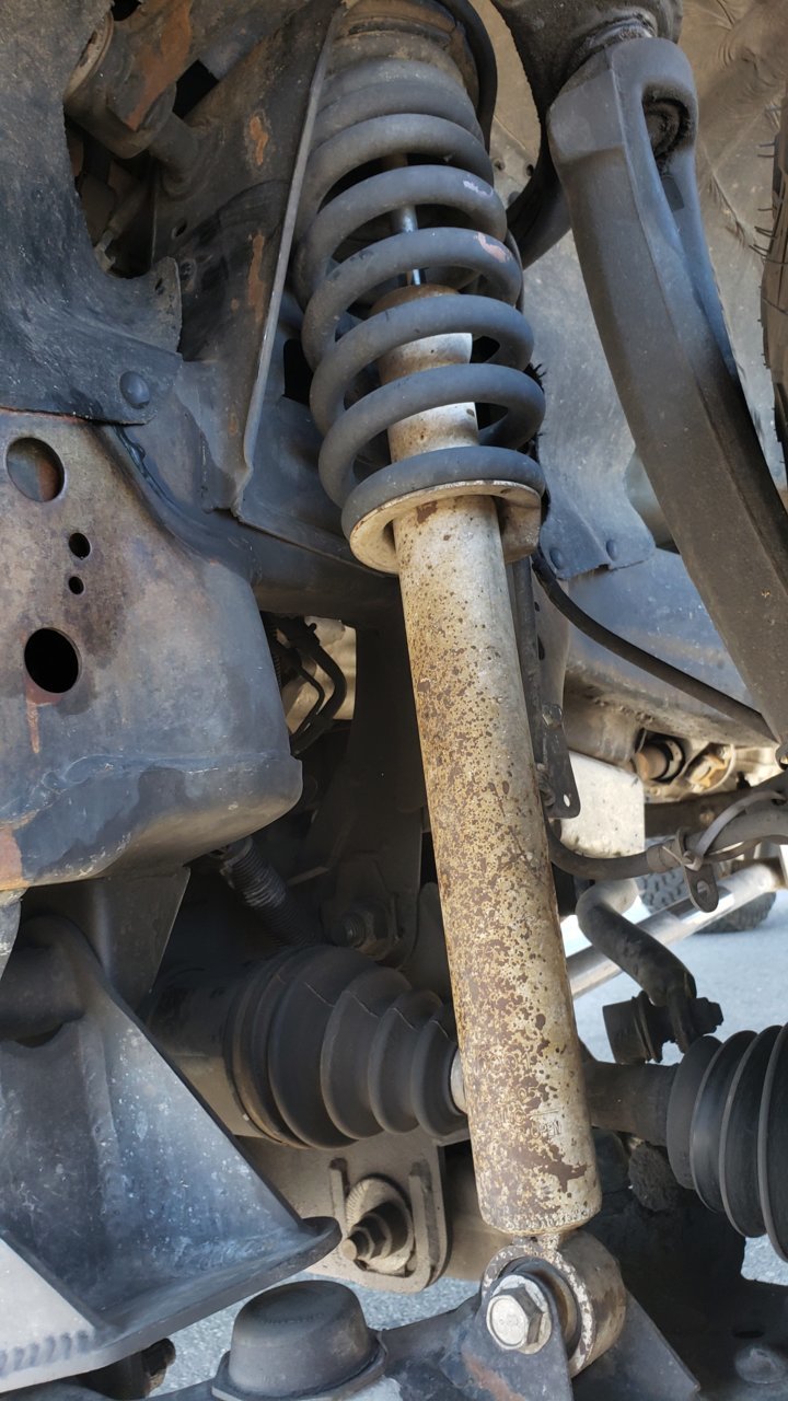

    Theres no spacer, I have seen that as well. This looks to be extended coilovers. I see some markings I'll take pics of, no brand names visible though.

    Part number on the shock says FT70001 then under that it has smaller numbers that read 005432 0505

    After a quick search these are the fabtech front struts for the 6" lift I have on the truck right now. They are pretty cheap to order new ones, about $140 a piece. The price difference is pretty severe. I am going to try to call Bilstein tomorrow to ask about the 5100s. I have seen the Kings but not the Radflo, Ill check those out right now. With how crazy the cost difference is I am wondering if I will see a better ride with the King or Radflo vs. the Fabtech replacement ones?
