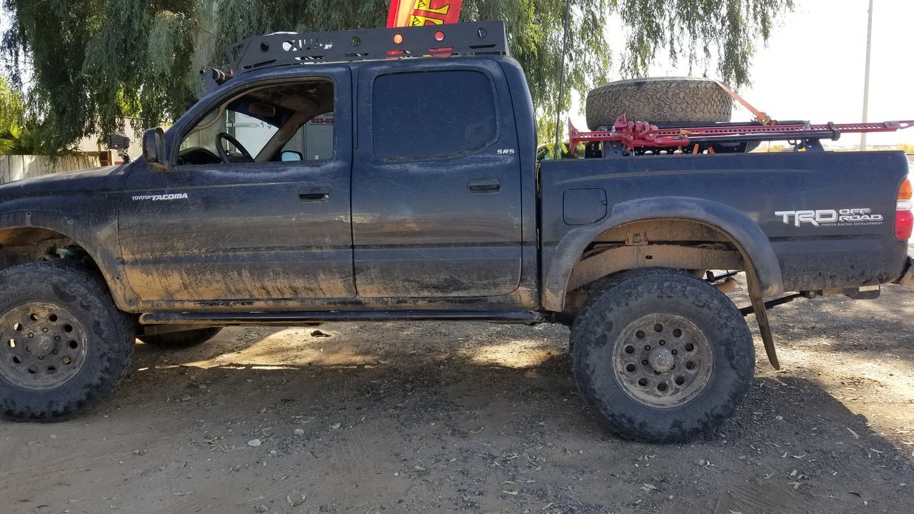

    How it currently looks as of 7/25/2017

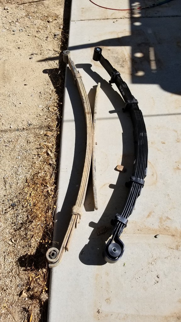

    Spent $600 on this sticker but it came with a free set of leaf springs ;)
    Now I need to adjust coilovers again and should be good for a while on suspension

    I need rear leaf springs too. Couple of questions Sarah, if you don't mind helping:
    1) How much higher did those rear leaf springs raise?
    2) What shocks (if any) are needed to run with those rear springs?
    3) Most importantly, how any inches/or what do I need in the front, to keep the factory rake by using those rear leaf springs?
    Thank you
  14. Oct 23, 2017 at 8:58 AM
    #254
    Tacomagirl64
    Tacomagirl64 [OP] Well-Known Member
    Sep 4, 2010
    #42712
    875
    Sarah
    Phoenix, Arizona
    2003 Tacoma SR5 3.4L
    King Coilovers 3", AllPro upper control arms, fabtech rear shocks, Avis Offroad Bed rack and roof rack, Avid sliders, Ulta 16" Baja wheels and 285/75/16 KO2s
    No worries at all!!
    I went with the AllPro Expo leaves and I achieved 4" of lift with the bed rack on it, but once the RTT is on it will be about 3". I did have to get extended brake lines though!
    I am currently running Fabtech rear shocks, but I am going to go with the King resevoirs to match my front coilovers. I believe an extended shock is needed to run these, but don't quote me on it.
    To keep it level/factory if you went with a higher leaf, I would add 3" to the front. If you go with the Allpro standard leaves they lift the front 3 instead of 4"!
    Hope this helps
