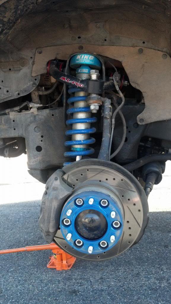

    UCA's and wheel spacers that I installed last year...never got around to getting pictures up until now

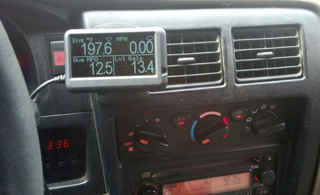

    UltraGauge came in the post today finally...installed during a dust storm so its filthy already :/

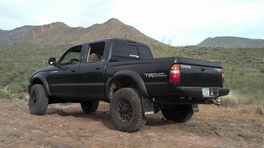

    Couple of pictures from this weekend's adventure...have some nice Arizona pinstripes again

    Nice! I love that the UG (ultragauge) has sounding alarms (not just visual) that you can set should your temps go over a certain threshold. The UG saved me one time when I had it setup in an old Mitsubishi Eclipse that had engine cooling problems. I didn't want to have to glance at the analog temp gauge in paranoia ever second, a sounding alert worked much better so I could keep my eyes on the road. During my scenario the UG made a nice alert sound when the engine climbed over 230 degrees. It ended up being a failed thermostat, I replaced it, and I was good to go. A bonus is that the UG has the capability to reset the CEL.
    I wish my trusty SG (scangauge) had the alert sound feature of the UG but I really need to monitor my transmission temps, and the SG does this very well. I may have to just get a OBD2 splitter and run both! :D
    I'm curious, are you having any problems with the ABS light turing on with the UG? I had to get a special "ISO only" cable (it has a missing pin on purpose) from the scangauge folks to run my scangauge to avoid the ABS light on my dash from triggering.

    I love the UG! I got it because my temp gauge stopped working after I had my LEDs installed. Probably nothing major, but it was a good excuse to buy an UG. My ABS light is actually on at the moment but it was on before I installed it. I will let you know once I figure out why the light is on if it stays on with the UG. I don't think so though because from what I have read on here, no one else has had problems with that.
