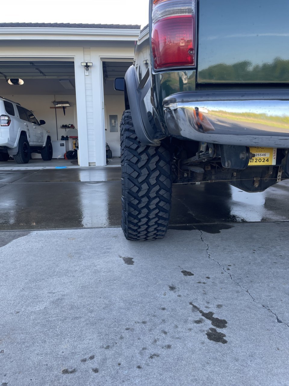

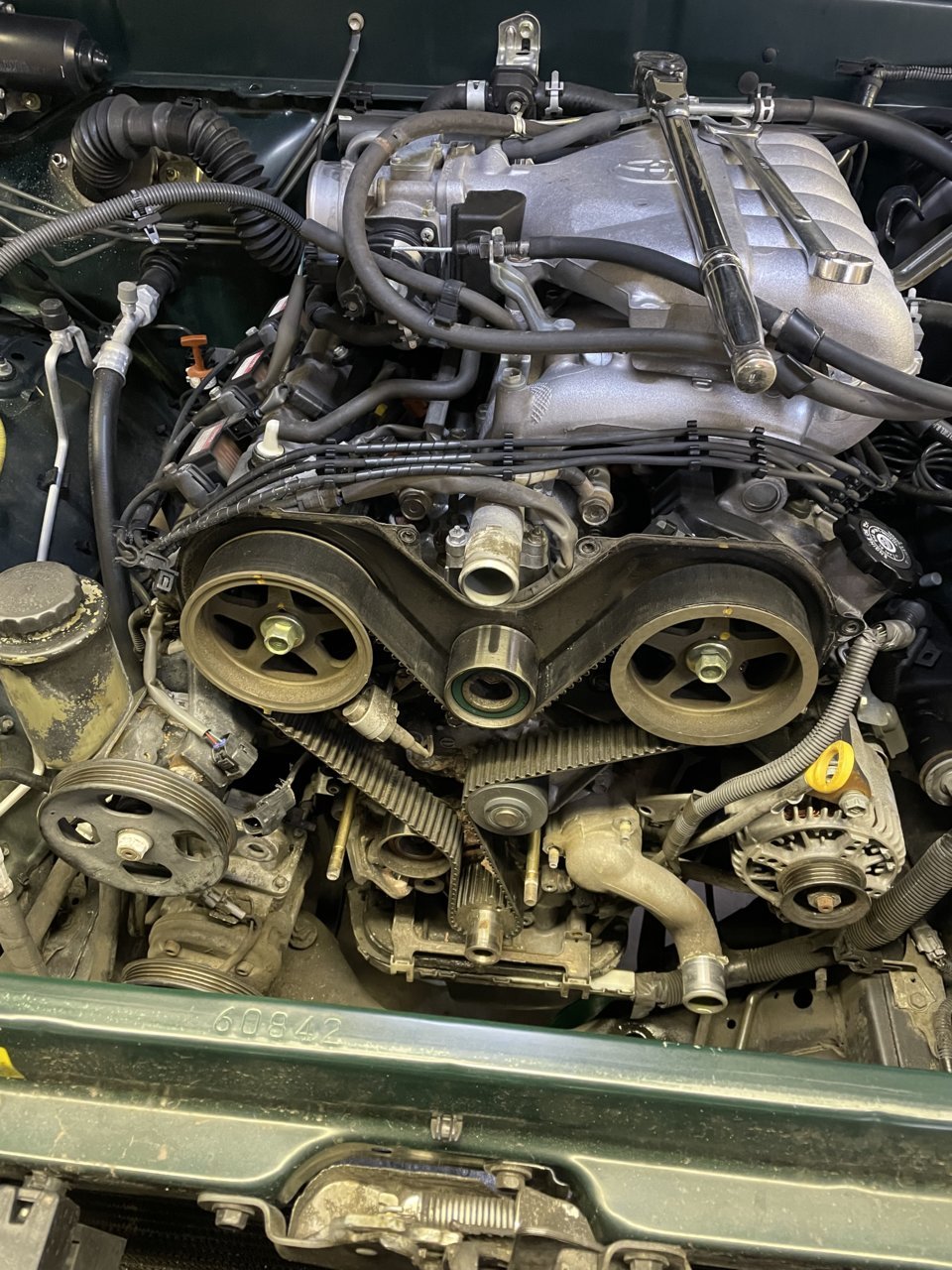

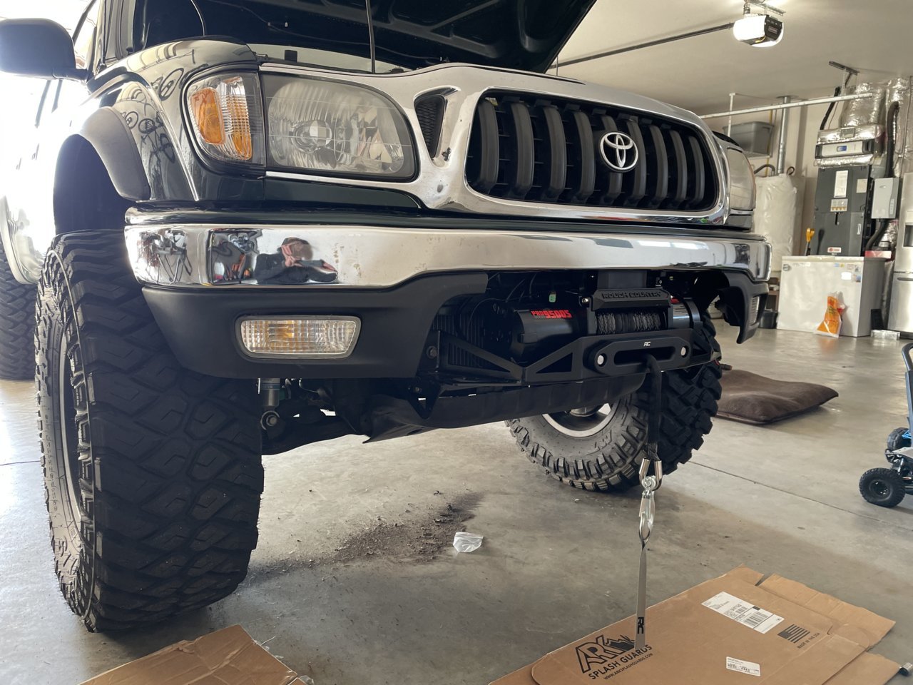

    First post on here, been slowly building up a Tacoma I picked up from original owner that was bone stock and only ever had engine oil changes. Picked up with 163k miles and first thing did was timing belt, water pump, etc since had never had one. 3” toytec bilstein lift with 1” body lift. 529s with Detroit truetracs from East Coast Gear, Amp’ed hidden winch, 4x innovations weld on sliders, and that’s really about it. Started on 35” good year Duratracs that wouldn’t ever balance up, so traded out into than maxxis 35s but we’re way too wide and rub frame even with spacers, now it’s on nitto 35-11.50-17 which so far I love the narrow look and load range C and mostly posting this since while reading around I do not see many people talk about narrow 35s. Here’s some progress pictures below.
