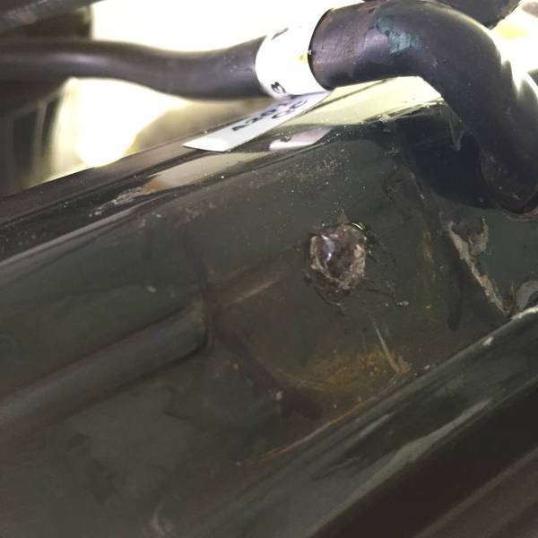

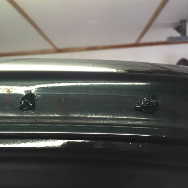

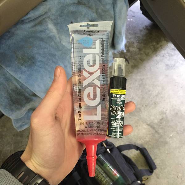

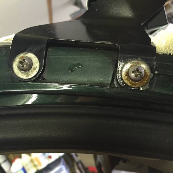

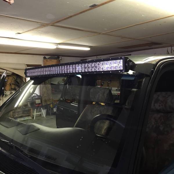

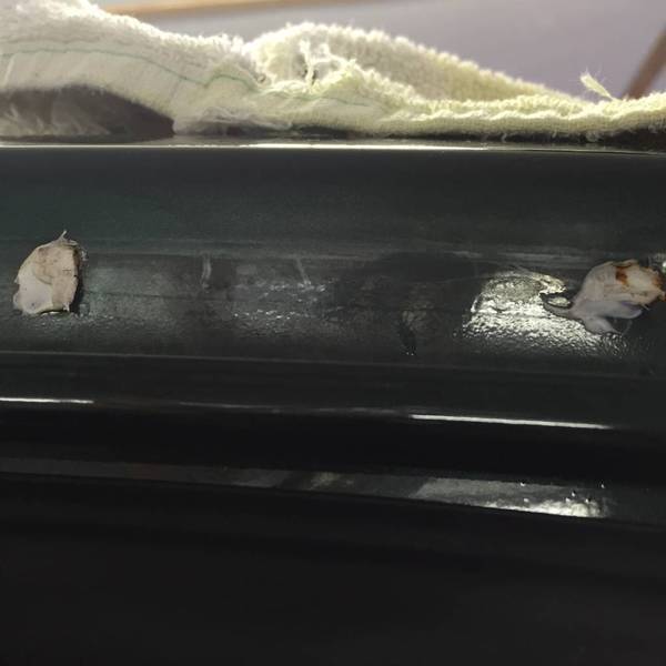

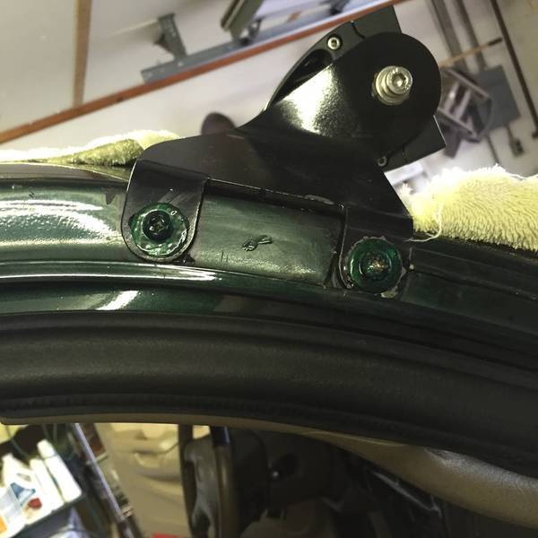

    Fixed a couple of things on my light bar mounts...
    Painted the white silicon that covered the first holes drilled by this "custom car shop" here local...would NOT recommend these people..they had the bar like mounted in the middle of the cab, said the light bar was too long, like of course its too long you mounted the brackets in the TOTALLY wrong spot..anyways i told them to forget about it, ill just do it myself
    I used dupli color color match pin for paint, super strong enamel paint
    Took the brackets off and re-sealed them with lexel silicone so no water would get inside the liner..
    And i also paint the hardware for the light bar, started to rust so used the style pin..
    doesn't look the best but you cant see it with the weather stripping put back on
    All done
