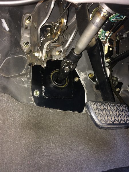

    Yesterday, I reworked the firewall plate & seal.
    I needed to move the seal to the RT 5/8" to center the shaft in the seal going through the plate. I also properly phased the 3 steering u joints... I was off a few splines.
    These plates do not fit well at all. I trimmed the RT side and bottom at least a 1/2" and elongated the holes to get it to fit and quite a bit of silicone too. Good to go now.

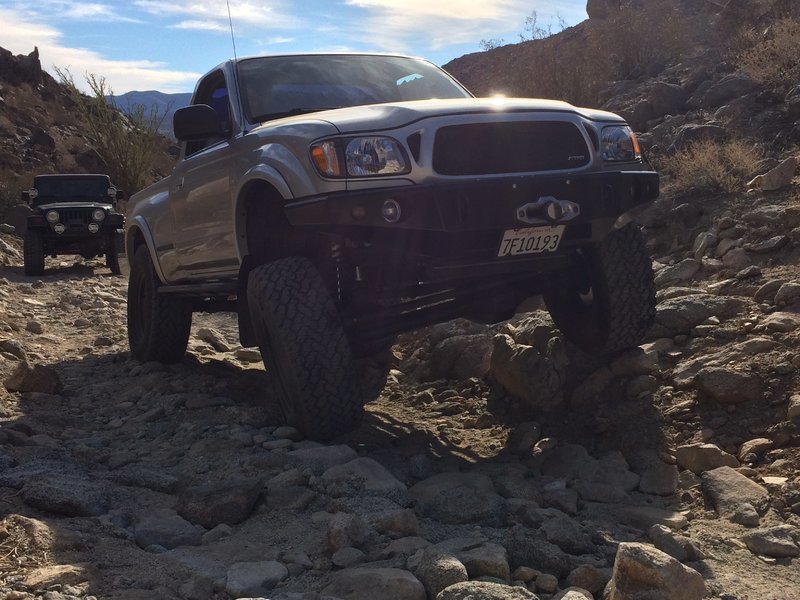

    I finally was able to get my truck in the dirt on Sunday.
    Went north of Borrego Springs to Coyote Canyon. The rangers had a portion of the trail shut down but it was nice to try out all of the parts.
    Front hubs locked in and we were off. Didn't need the front locker but did have the rear locked.
    Everything rode smooth, much better than my previous IFS setup. I didn't use all of the suspension but had a good time regardless.
    Nothing broke, no leaks and I couldn't be happier.
    Nothing too technical and the rocks were small. This is the only pic I have.

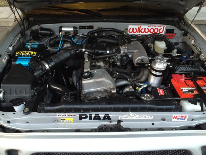

    I have the all pro bumper as well and can't for the life of me find a good spot to install the solenoid box for my m8000, it was easy on the ARB I had because there was a bracket for it. Did you move yours into the engine bay ?

    I did move it, it sits to the left of the battery. The remote solenoid is between the OEM air box and fender edge.

    The pack fits between the radiator and the grill, mines zip tied to the grill with some big ass zip ties and has been like that for 10yrs now, works great!

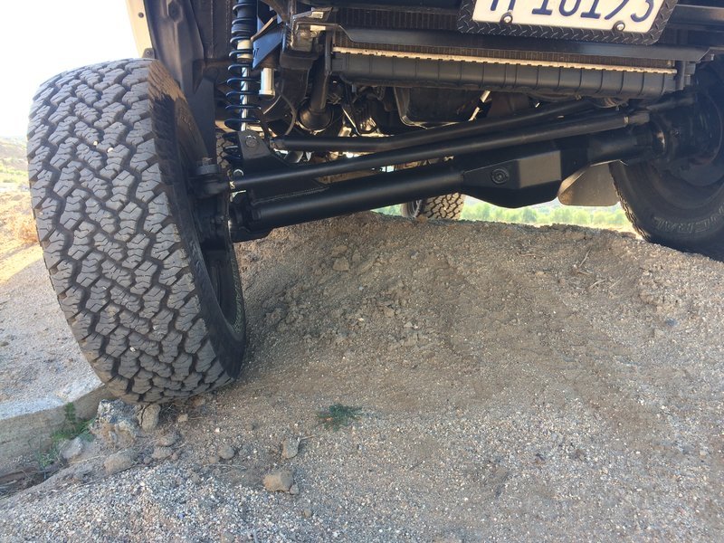

    So I took it out for some flex shots.
    The DS tire is just getting into the bumper so I stopped there. I'll need to trim approximately 3/4" off of each side for full stuff.
    As for droop, there are 3" remaining on the shock.
    More to follow.

    From the pic, does your panhard has a bend in it? Thought the golden rule was for it to be straight...though I've seen many rigs with bent panhards, especially jeeps.
    Just curious...

    You see correctly.
    It has two bends in it. No bumpsteer at all.
    I still need to do more research as to why the DS wheel hops.

    That golden rule is for lowers and uppers. Panhard doesn't see as much force.
