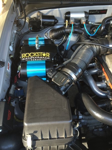

    On Saturday morning, I was able to get my compressor installed. Needed to reconfigure the original bracket to fit above the shock tower. It turned out better than the original install I did a few years ago.
    Rear shocks will be installed this morning.

    That looks really good.
    I also like how those shock towers allow you to keep the air box in the stock location.

    Thanks...
    I did leave a 3/4" gap between the bottom mount plate of the compressor & the top of the shock tower. This allows flex and clearance as the compressor is somewhat bolted to the body of the truck via hacked fender well.
    I did add beef to the mounts which added some structural integrity to the fender well.
