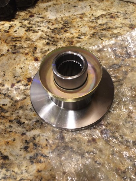

    Marlin makes, or at least used to make a 5 pattern drilled 27spline flange, i have one of the front output of my lefty that i built. However it may be quicker at this point to redrill it if you have access to a drill press.
  6. Sep 7, 2016 at 2:53 PM
    #226
    Ritchie
    Ritchie [OP] Well-Known Member
    Dec 24, 2012
    #93649
    1,931
    San Diego (North County)
    RC Step side Pre-runner
    2.7 w/auto, 4WU 3 link, F & R Diamonds, ARB's F/R w/ Yukon 5.29's, Inchworm 4.7 Lefty, Deavers, ARB OBA, Schrockworks up front.
    OK... I did scout their site and came up with nothing that I need or could make work.
    I ordered a 27 spline blank that I'll drill out then install.

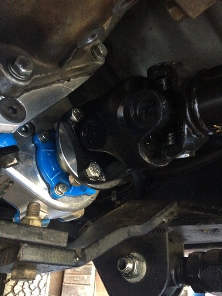

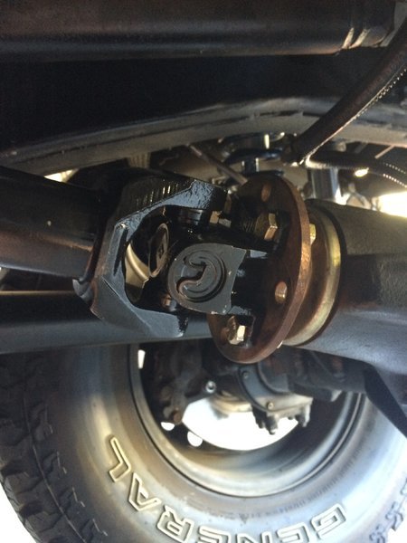

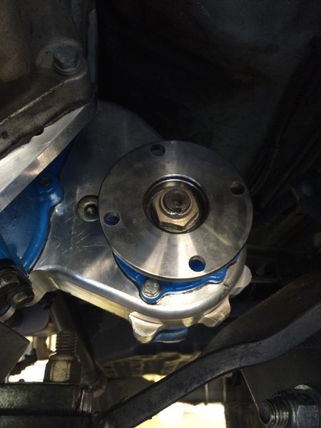

    Just finished installing the front drive shaft. The 27 spline blank from Core West was the ticket, thanks ToyRyd04. Drilled to match the CV end then bolted up. Tested the front locker and it functions as it should.
    Also, I replaced both TRE's. Found one very loose and the rubber was wasted around the joint... after install, steering is much better.
    Spoke with Brian @ 4WU, he will send me a tool to tighten the remaining Johnny Joints. Of the 5, I have 4 remaining to tighten and the tool will make it much easier to complete. Kudos to Brian.
    More to follow.

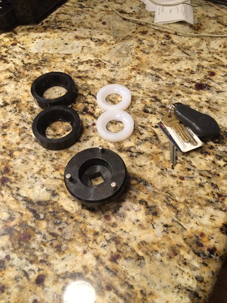

    After a couple of weeks doing research, I was able to find the shop that sells the type of Johnny Joints I have.
    Rusty's Off Road https://www.rustysoffroad.com/ had what I needed, spanner tool as well. I now have it in my possession and will get everything tightened up this coming weekend. I will finally get to do something on my truck this weekend. GOD I need to finish this.
    I'll re-work the crappy fire wall plate as well. Although they are close, they really do suck, they're not even flat when you receive them.
    As a note to all, the fire wall seal that comes with these 'kits' is an actual OEM Toyota part, which is # 45292-35090.
    Hope this helps someone.
    EDIT: I received the spanner tool from 4WU this afternoon, now I have two.
    Kudos 4WU.

  18. Sep 29, 2016 at 6:05 AM
    #238
    Ritchie
    Dec 24, 2012
    #93649
    1,931
    5 out of 6 joints are JJ's, the upper link at the diff is a heim.
    Here is the spanner tool and some bushings for the JJ's:
