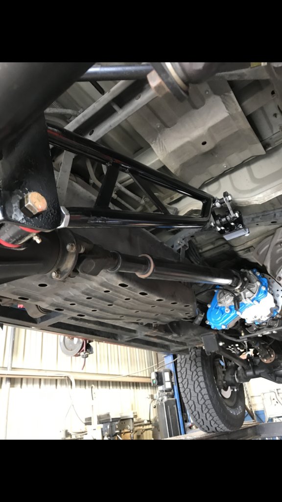

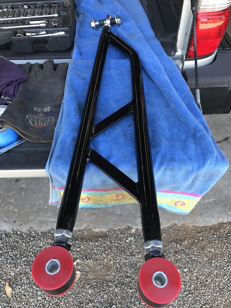

    I installed a BudBuilt trac bar on Thursday, along with re-working my exhaust.
    I highly recommend this item for those with aftermarket leafs. All axle wrap is eliminated.

    As I am a regular cab, I had to remove 10" from each of the end links at the rear. This resulted in elongating the upper elongated hole down 1/2" to accommodate the shorter upper bar end.
    Simple install and works so damn well.
    For those with aftermarket leafs, make this item a priority.

    Looks great! Next time I come by you'll have to take my truck out for a drive. I don't think I have any axle wrap but it seems so common on our trucks.

    Looks really great man; super clean looking even though you had to modify it. This will give you extra insurance also in case you add more powa' to that engine in the future.
    That's interesting. I was having this conversation with Ritchie off line the other day. I have never experienced axle wrap. It seems to be more of an issue if you have super soft springs and/or a lot of hp/torque. I think Ritchie's problem is that his rear springs are really soft, probably more than other springs.

    Yeah, it seems the soft leafs are the issue or it's a coincidence. I've not heard of guys running expedition type leafs having the axle wrap issue.
    One thing for sure, this little gem cured my issues.

    Ah, that makes more sense then. I'm running OME Dakar rear leaf packs which are pretty stiff unless loaded.

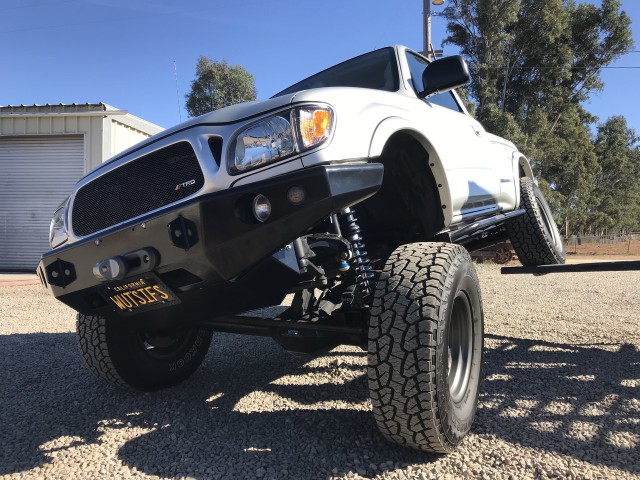

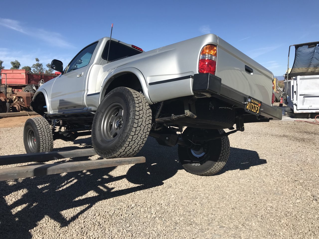

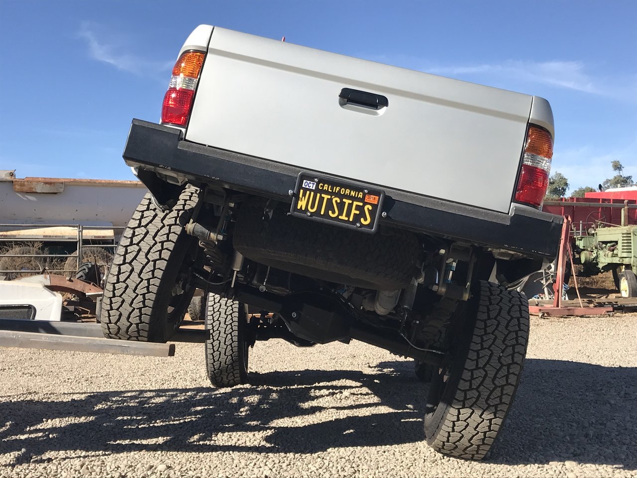

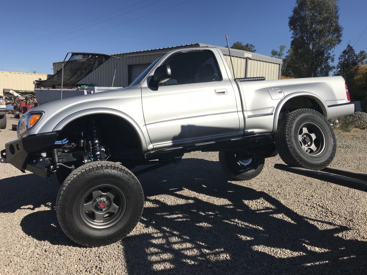

    Been a while since I've updated but... the build portion is complete.
    I moved the PS shock tower and bump bracket & mount forward 1" to mirror the DS. This required a modification to the bump bracket. The DS lower link bracket was moved forward 3/8" and rotated inward 13 degrees. Both turned out great. Everything flexes well, no binding and equal link movement throughout the axis. It really drives great. The adjusted wheelbase is 105.5" on the DS and 105.7 for the PS. I was told that the added .2" on the PS is for the crown in the road and will keep the truck from wandering. Whatever the reason, it drives true.
    I replaced the radiator as it had a small crack on the lower tank. Not sure when/ how that happened as I've only been out once in 21 months. Afterwards, I built a front skid to protect the lower section of the radiator. It's a bit longer than I want but it'll do.
    Here are some flex pics which are long overdue. Offline, Oz mentioned I may need softer leafs which appears to be the case. The Deavers still have arch in them and the Fox shocks have 3-4" of shaft remaining. Also, the stuffed PS has 3" of up travel remaining.
    Questions, comments and suggestions are welcomed. Thanks for tuning in.

    2,908
    Max
    Santa Cruz, CA
    99’ Bro-Coma’s Revenge 3RZ 345k+
    Stock
    Sick AF!
    Doesn't look like the rear is doing much though o_O

    Bad ass. Clean looking rig! I dig the "OE look." It almost looks like the truck came from factory with a solid front axle...which is the way they should all be :thumbsup: Great attention to detail on that build.
    The rear springs seem to be the limiting factor now. Maybe they'll loosen up after they stretch out on some trails.

    The leafs seem to be the limiting factor. I'll repeat the flex process and check to see if the HEIM on the trac bar is maxxed out or not, limiting the flex but I doubt that's the issue.
    If I need to replace the leafs, I'll do it instead of removing leafs from this set.

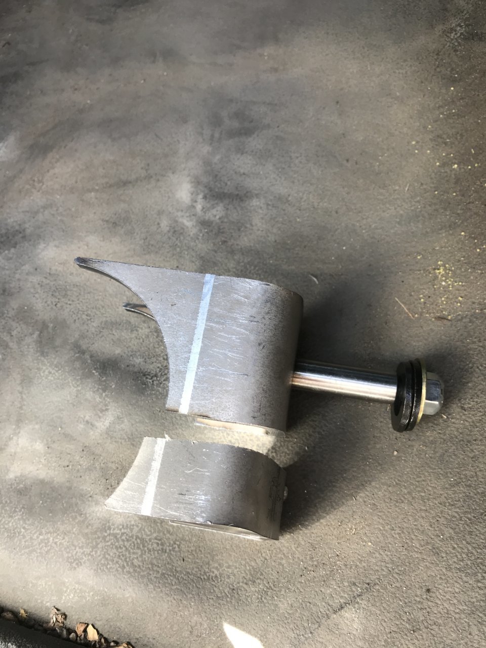

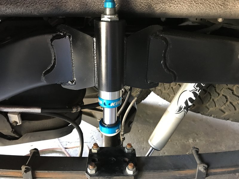

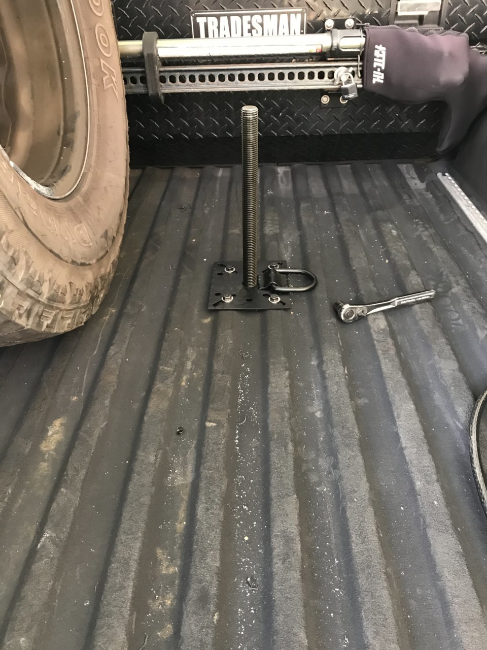

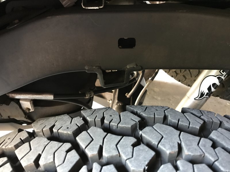

    ... and again, been a while since I've updated things.

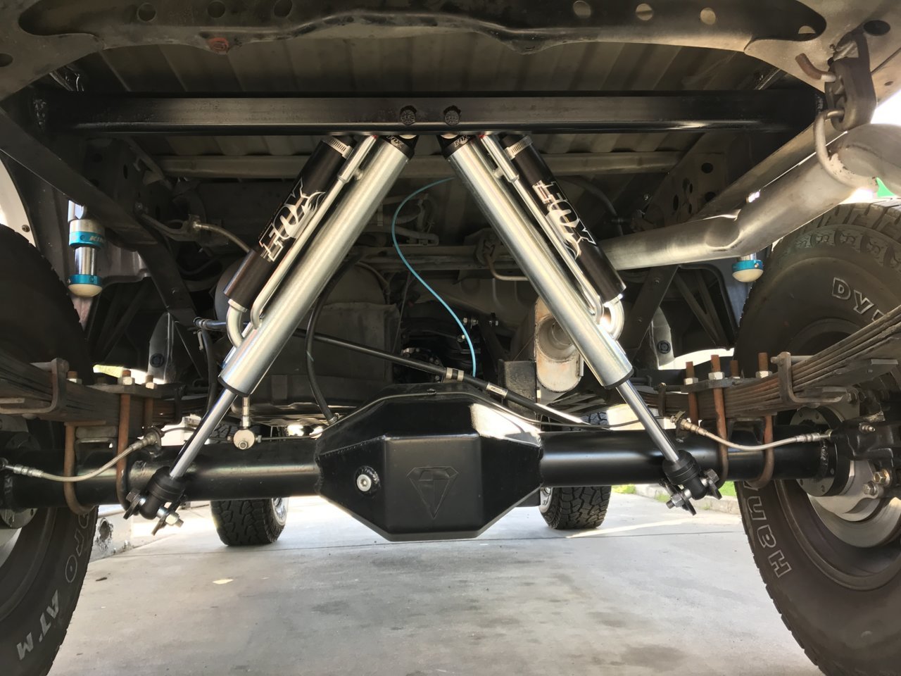

    I learned that the trac bar HEIM did not allow enough rotation. I replaced it with a larger piece and a pair of mis-alignment spacers, that fixed that. I haven't flexed it yet but it will work.
    I added a pair of FOX 12" 2.0 bypass shocks for the rear. I completely removed all parts related to the spare tire carrier, added a 2x2" cross member to mount them behind the axle. The rear is much smoother than before.

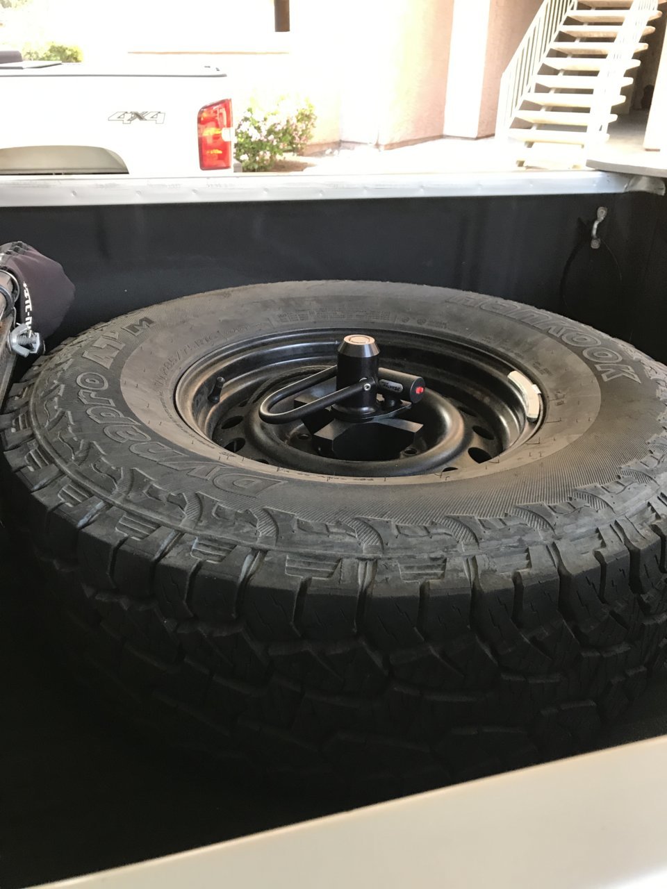

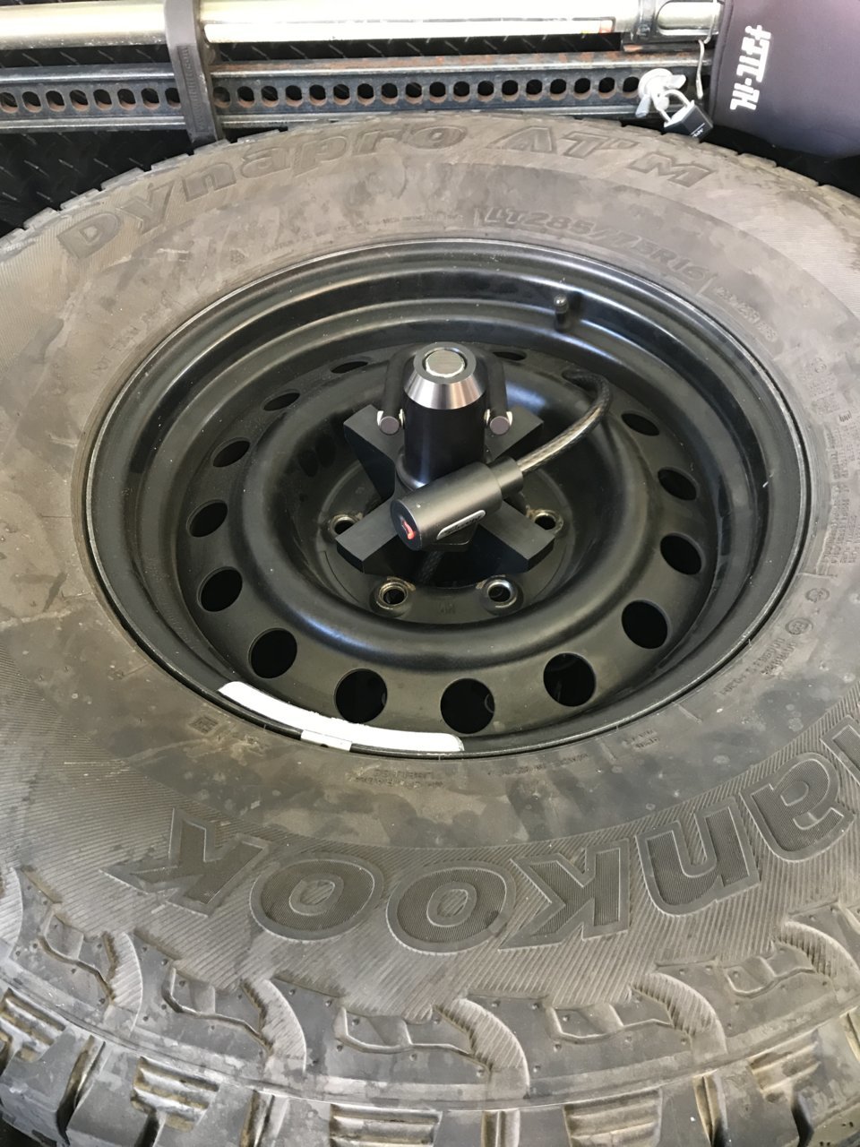

    I bought a spare mount kit for the bed. Found it on JEG's and is a Tire Gate product. Good quality stuff. The full size spare fits great and I have enough room for my YETI45 cooler between it and the tail gate.
    I will re-work the shock mount tabs on the axle this Sunday. I received a pair for a JEEP, only to install them after I'd removed the others without opening the box to check parts first. No big deal.

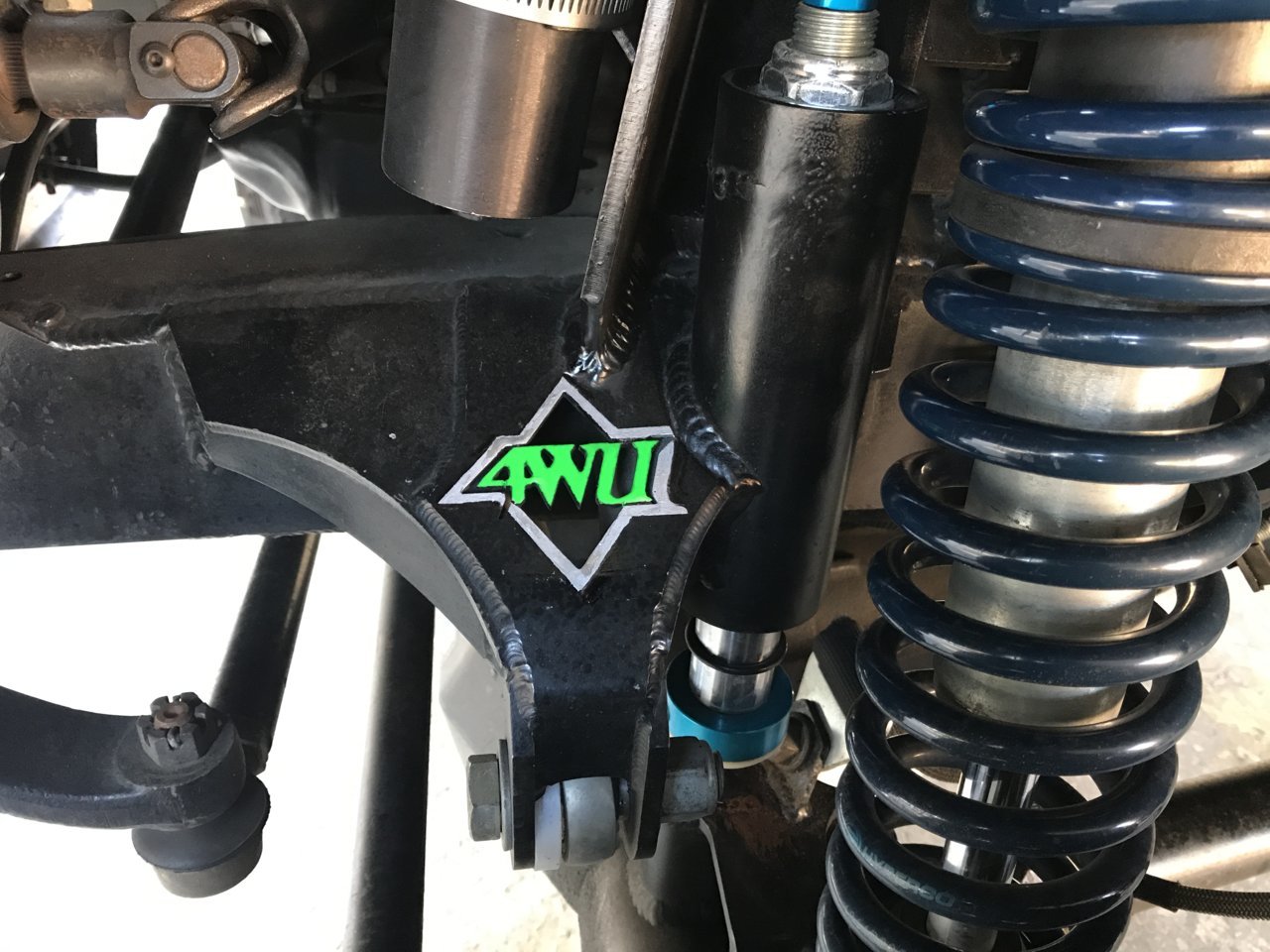

    Did some detail on 4WU's laser cut logo on the pan hard bracket.
    IMG_0041.jpg IMG_0086.jpg IMG_0104.jpg IMG_0110.jpg IMG_0111.jpg IMG_0112.jpg
