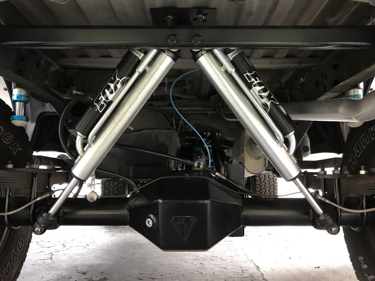

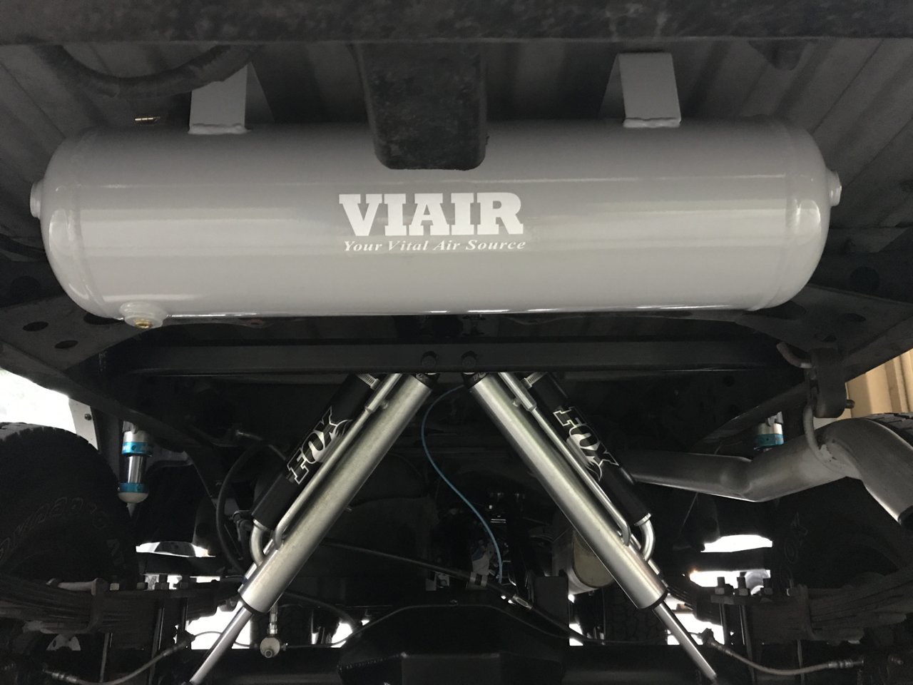

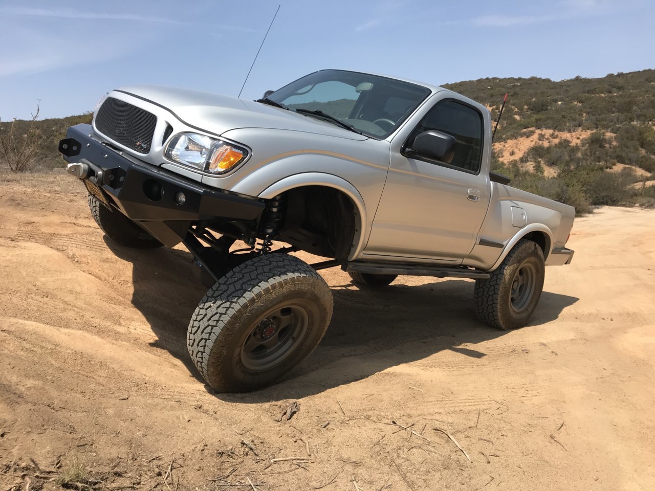

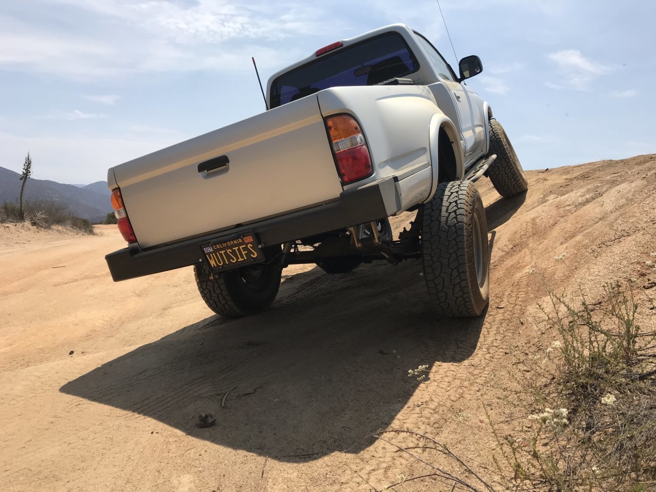

    I took the truck out for a shake down in Pamo Valley, a bit North of Ramona. I wanted to see how it worked after I relocated the rear shocks and added an actual Viair 2.5 gallon air tank. This tank in addition to my driver side slider provide nearly 6 gallons of air. The spare now resides in the bed.
    All worked well. In the following pics, there is 2" of shock remaining in the front and 4" in the rear. Stoked.
    Before air tank:
    After tank install:
    Some flex pics:

    I have to ask. Why buy bypasses and run hydro bumps then mount the shocks like that? Completely defeats the purpose and benefit of running a shock that size in that location. Probably would get better performance/damping/ride with the shocks || vs /\

    Well I couldn't pass up the great deal on the shocks and the bumps were installed when I had the OEM shock configuration.
    The current configuration really rides well with the Deavers and also allowed me to set them up for 6" up/ 6" down travel.

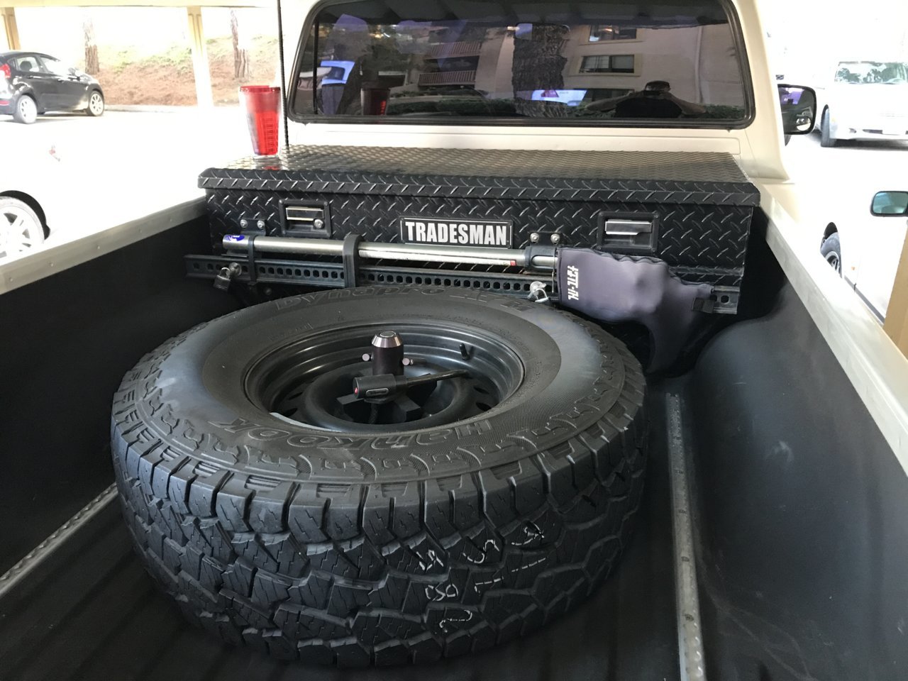

    ... also, I don't have much bed space after relocating the spare to the bed and I'm definitely not cutting holes in the bed for the upper shock mounts.
    When I test fit the 12" shocks in the OEM location, that left me with 1-3/4" of up travel.
    I may look into a new set of leafs and remove the All-Pro shackles... dunno yet. I want more flex than I have now.
    More to follow.

    I squeezed 12" fox shocks in the rear of mine without cutting and use all of the travel the shocks allowed with them angled back on chevy 63s. Just a suggestion and question was all as I know with them mounted inward looses a lot of the damping and allows for more body roll. Ill trade you some 12" fox 2.0s for them bypasses so I can outboard them on mine haha ;)

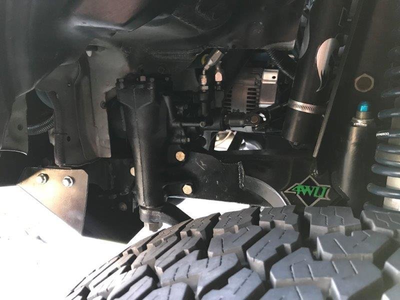

    ... so I dicked around with the IFS steering box a couple years ago. Anyway, chasing and fixing issues were complete yet still had a bit of wander and slight steering gain.
    I spoke to several guys @ SEMA and each came to the same conclusion that there are/ were issues with the box which leads to the purpose of the post:
    I ordered a rebuilt box from Marlin Crawler. After a bit of a wait (out of stock), I received this beauty. I installed it last Saturday and it drives perfect. On Sunday, I re-routed my winch cables and PS cooler lines. They no longer exit the engine compartment into the wheel well area.
    This eliminated approximately 12"-14" of each cable/ hose and looks nicer too.
