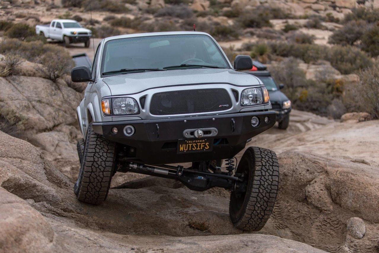

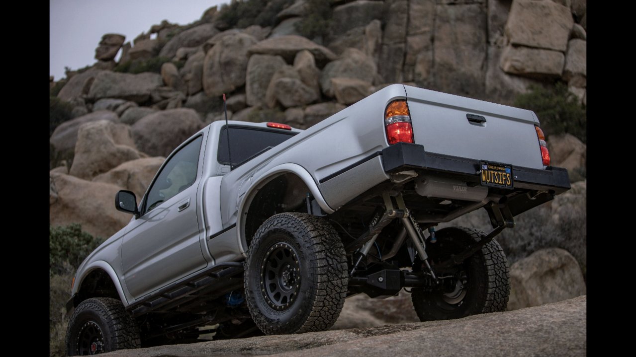

    Finally used my truck a few weeks ago. It worked well and nothing broke. These pics were taken at the Valley Of The Moon by @sdfstop

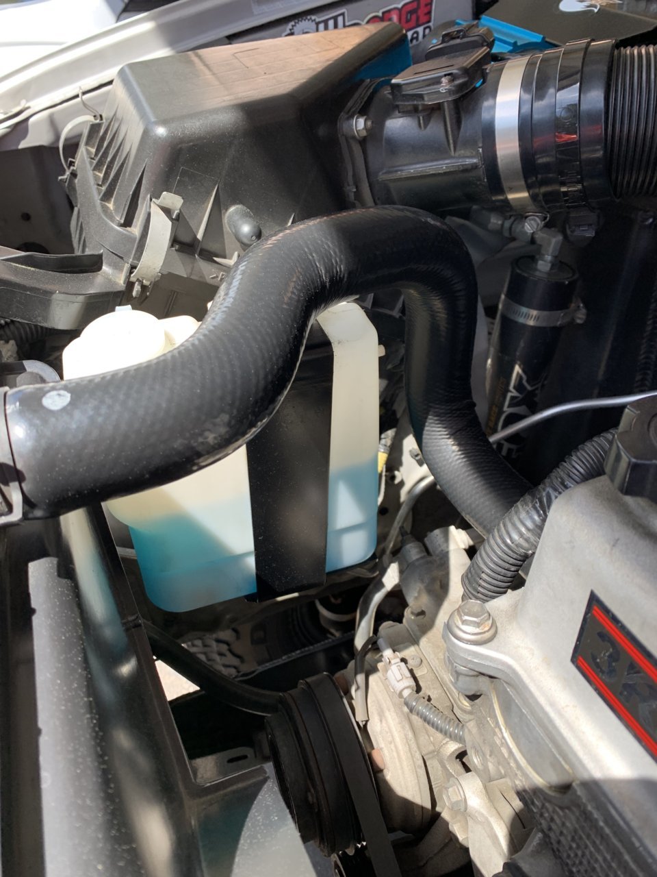

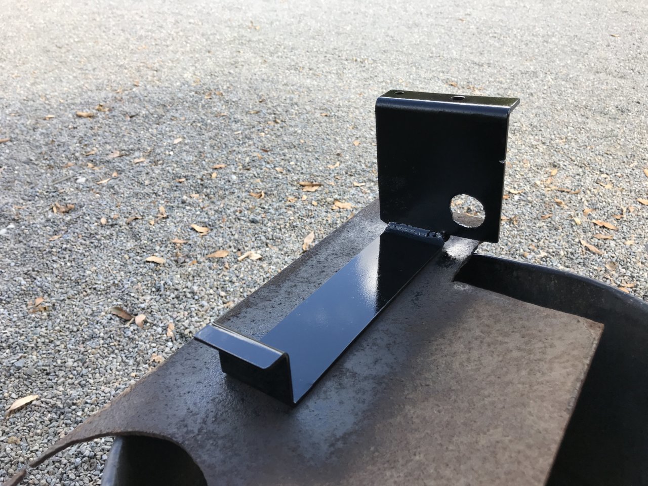

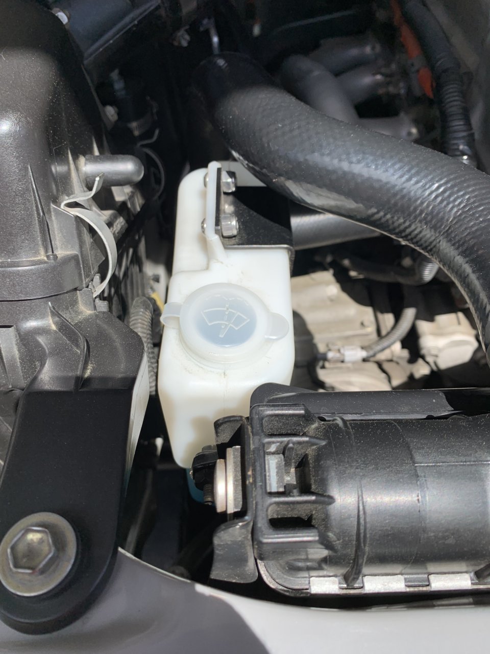

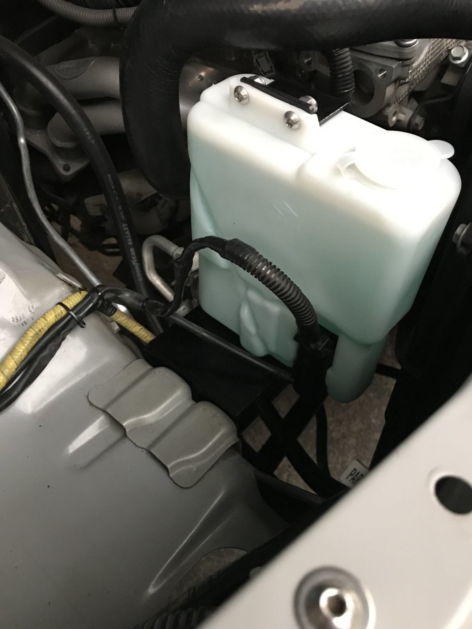

    So I was tired of replacing the windshield washer reservoir... damn neck kept cracking and it really wasn't in a good spot due to the SAC. I came up with this bracket and 1987 tank/ pump combo. Works great.

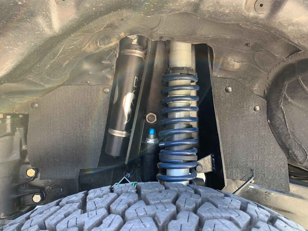

    I decided to make some splash guards from conveyor belt material. I threw around the idea of cutting/ shaping some sheet metal to fill in gaps around the shock towers, but that was too much work.

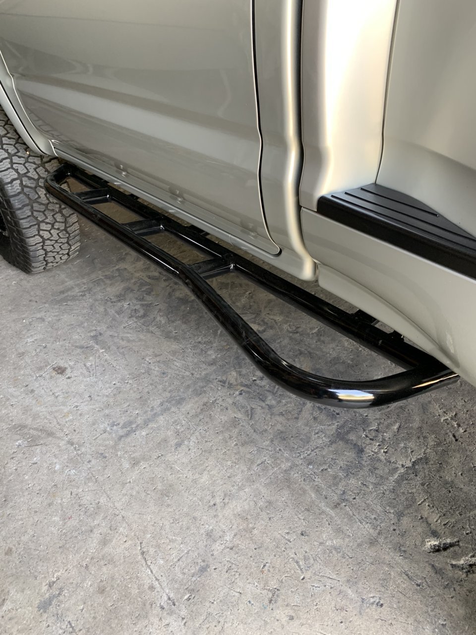

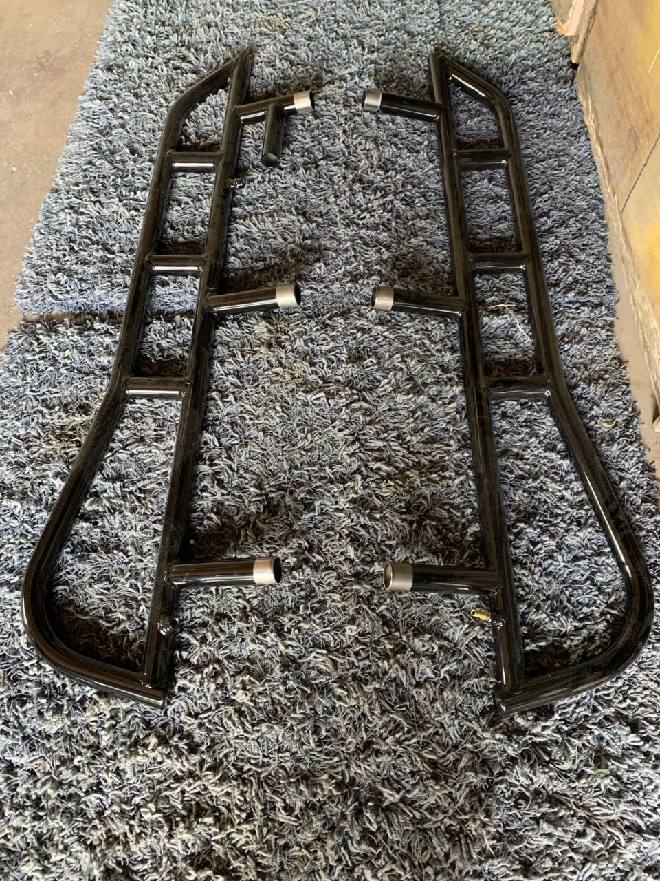

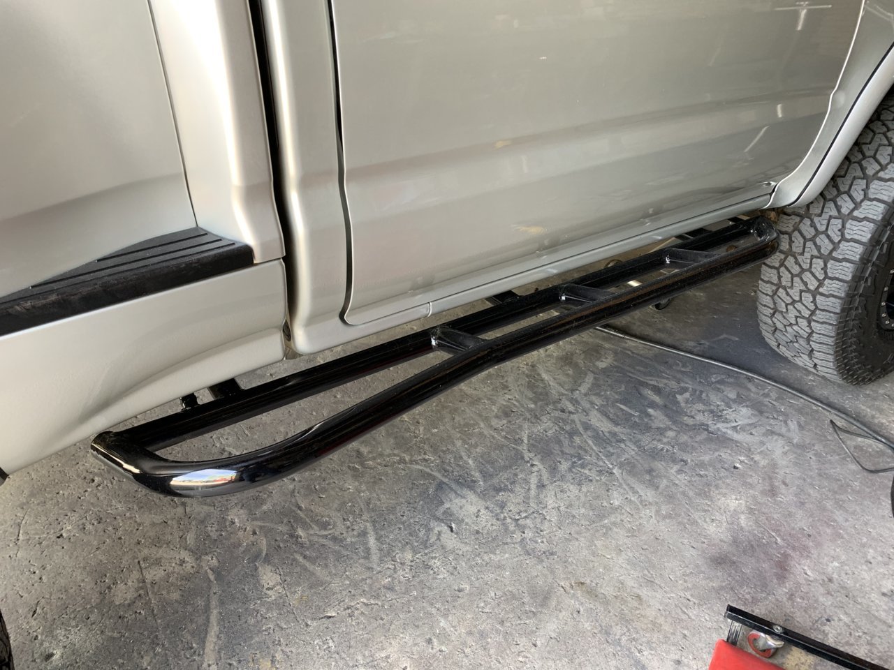

    About a year ago, I bought a pair of sliders from Marlin Crawler. The kit is 75% welded out but you need to measure/ cut/ weld on the kickers which I welded to plates I had welded on the frame from the previous set I made years ago. I had them powder coated. Both now hold air.

    Where did you pick up the new windshield washer tank? Judging by the pics, it might fit perfect between my air box and core support.... I just didn't see it on rockauto or summit racing, or anywhere really for that matter

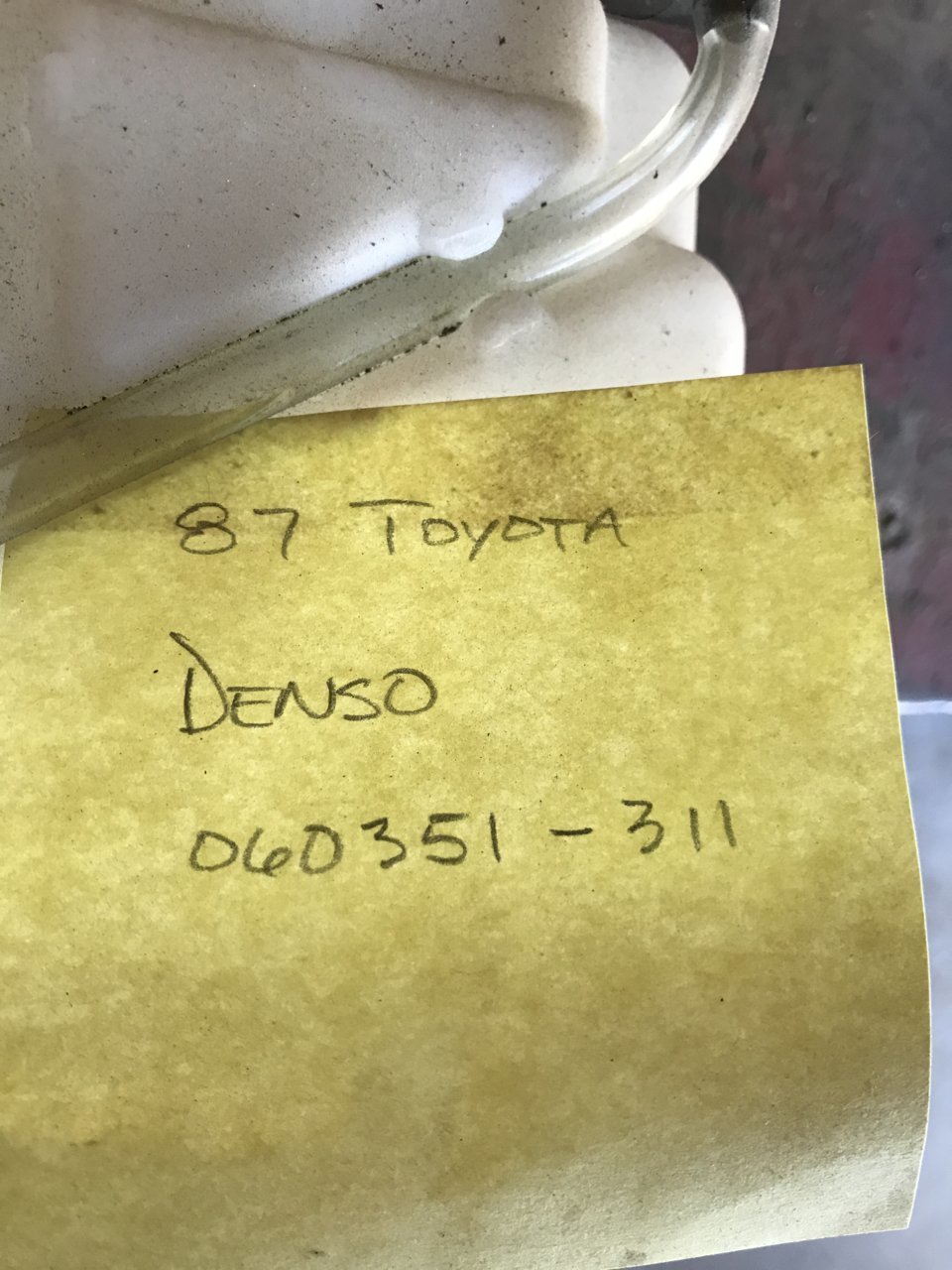

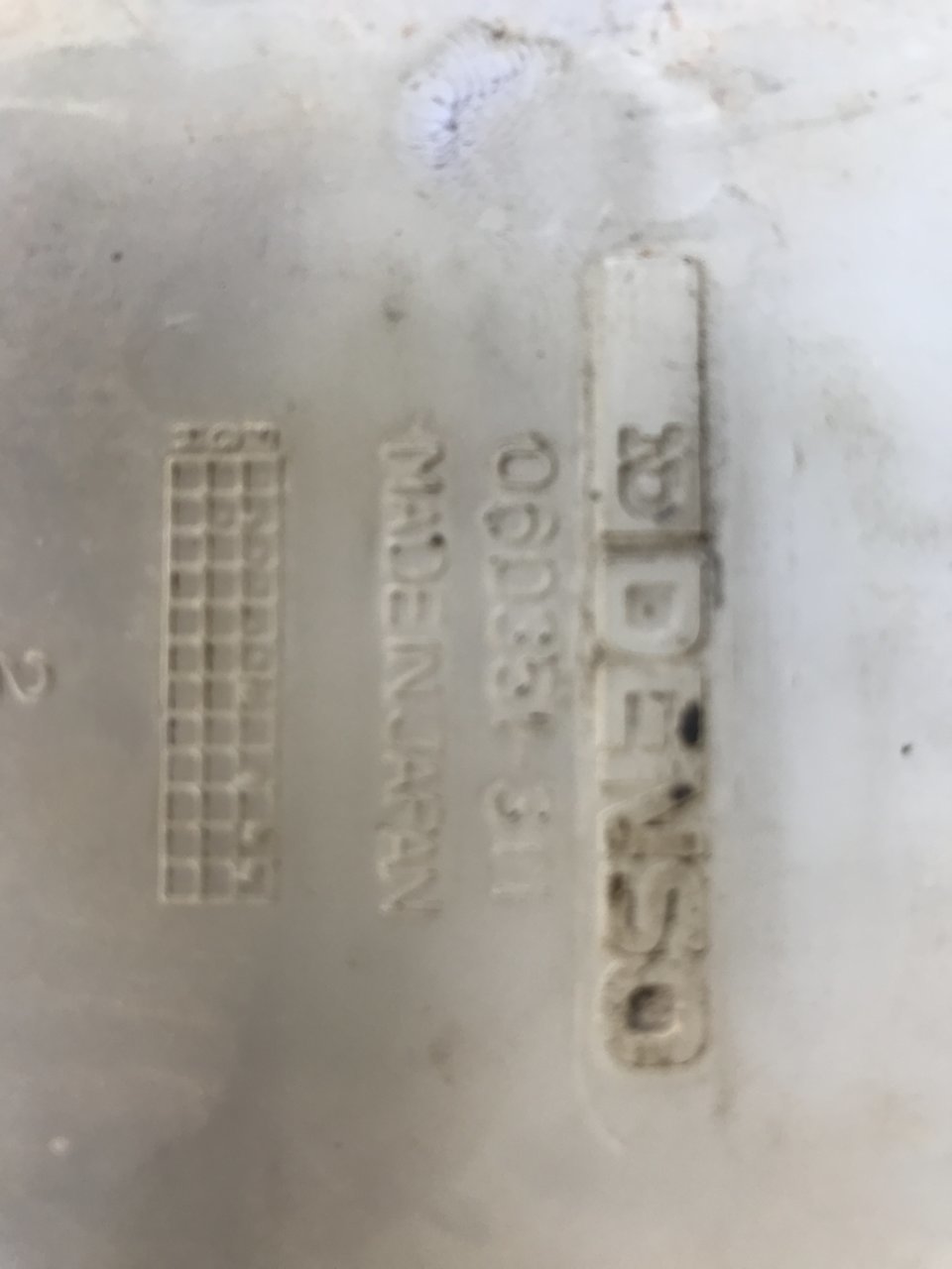

    IIRC, autoanything.com.
    It's for an '87 Toyota truck. It came with a pump too ... all for $34.00 plus s&h and tax.
    Here are more pics for reference. I bolted the bracket to the airbag sensor bolts as they are long enough to use.

    Legit! I'm going to have to look into something similar. I want OBA and want to free up room in the engine bay for it.

    FWIW, I bought that same washer bottle off eBay for $25 shipped. Not OEM but it is brand new.
