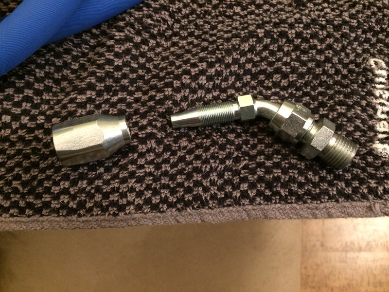

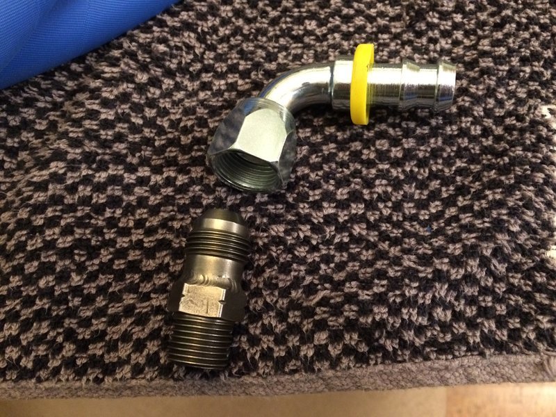

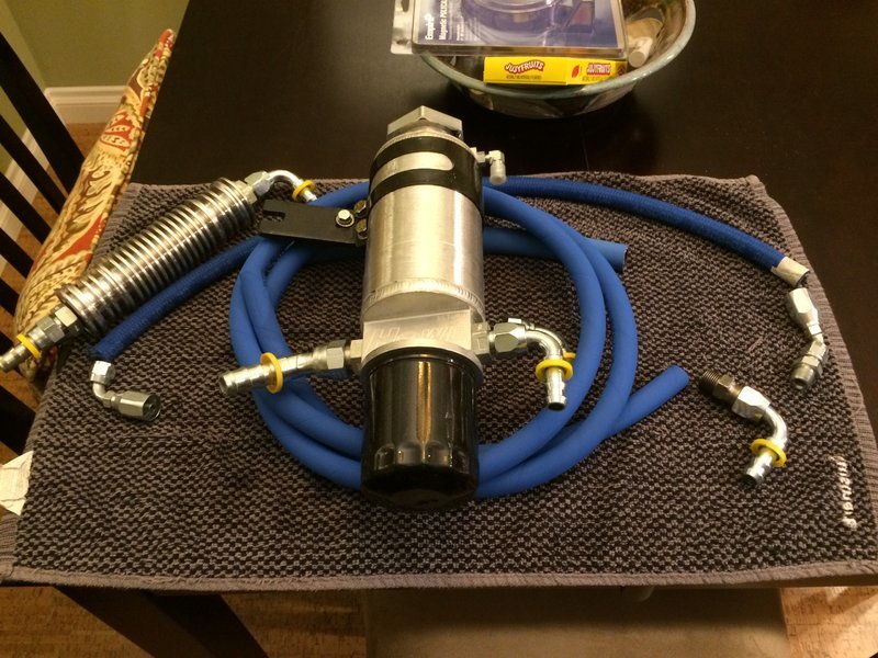

    Here are some pics of the hoses & fittings.
    Group hug of all parts going on minus pump:
    Low pressure fittings:
    High pressure fittings:
    The low pressure lines are a press in type. The high pressure shroud type fitting is a left hand thread... twist on tubing till it bottoms then add power steering fluid to the right hand fitting and thread in. Use two wrenches to tighten. Totally a trail type fix if need be, just carry extra hose.
    Should be killer when I get it installed.
