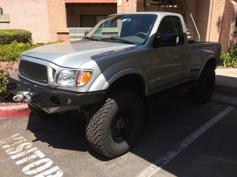

    Eventually, this will not be a DD. The LS and Atlas are just goals I've set for myself when I retire in 6 years. I need to have a toy to tinker with.
    Here is a shot with the new tires... and I finally washed it after 4 months.

    I will say this truck is going to be one kick ass sleeper rig!! With a reg cab truck, linked, locked f/r, and with a crawler will embarrass most trucks sitting on larger tire sizes. If i didnt wheel on boulder strewn trails, that are rutted up from Tim Cameron wannabees I would have kept 33's, but i need the belly height with my limo.
    This truck would walk damn near all of moab i bet and probibly never break!

    Thanks Slander... my hope is to do these trails in the future. Work is in the way most of the time.
