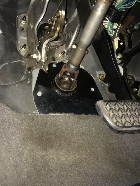

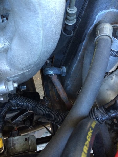

    Here are pics of the steering linkage I will replace two weekends from now. I will remove what is here and replace with the Howe set-up. Their u-joints are smaller, stronger, shorter and have a much better operating angle.
    Where you see the u-joint after the HEIM, the new will go in front of it which will properly align the shaft going through the fire wall plate and seal correctly.
    The pic through the fender well shows the size of the u-joints, and there are 3 of them.
    Lastly, you can see the grande' u-joint stuffed into the seal on the fire wall plate. That beotch makes awful noises while turning the wheel.
    Thanks for tuning in... more to follow.

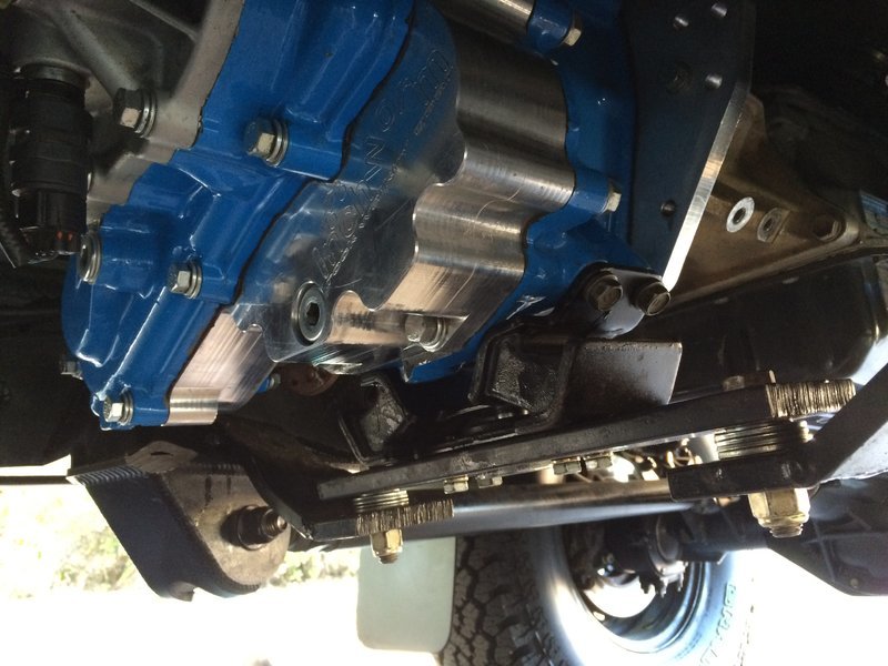

    Here is a pic of the cross member I built. The washers were installed incrementally to find the right spot in eliminating the drive line vibes. I was close in that MIT removed one washer on each side and repaired the bearing in the back of the box.
    I'll get a piece of 1/2" plate in there to replace the washers.

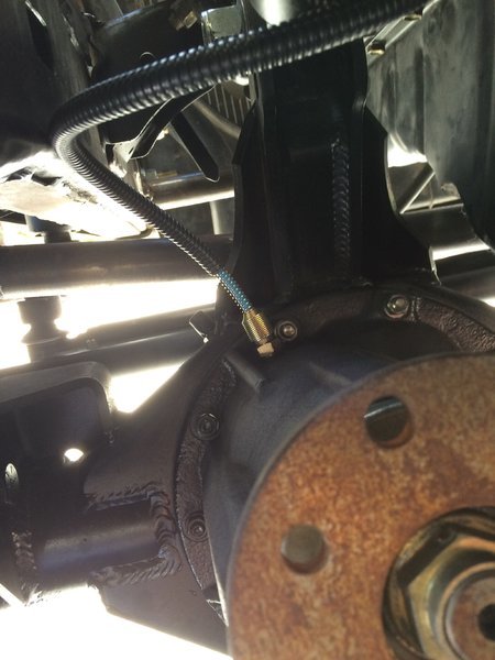

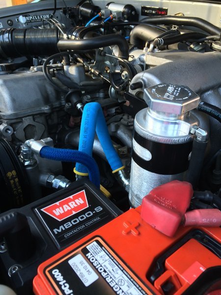

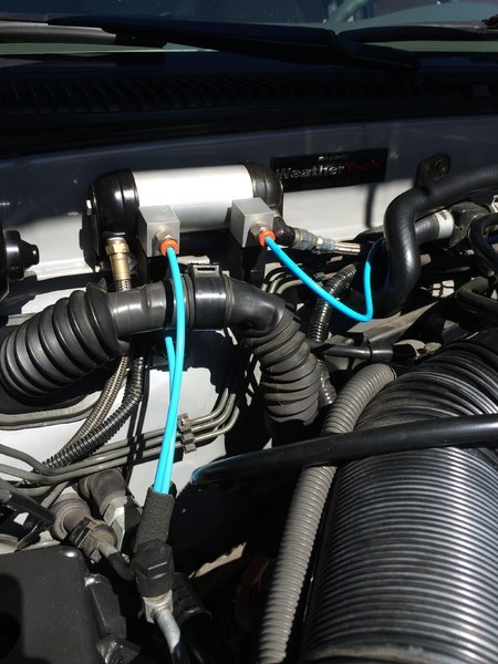

    So I had the CO's charged with nitrogen today. Turns out the fittings were loose but now being tight, feels great on road.
    I was able to electrically plumb the front locker today. Felt great to accomplish something on a day when typically nothing happens due to time constraints.

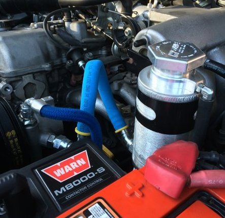

  11. Apr 17, 2016 at 5:52 PM
    #151
    Ritchie
    Ritchie [OP] Well-Known Member
    Dec 24, 2012
    #93649
    1,931
    San Diego (North County)
    RC Step side Pre-runner

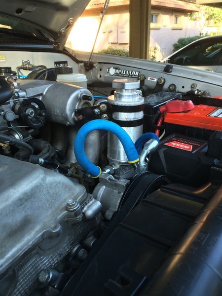

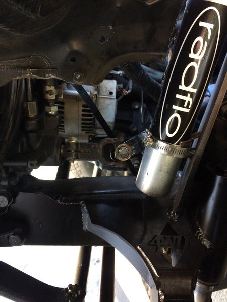

    2.7 w/auto, 4WU 3 link, F & R Diamonds, ARB's F/R w/ Yukon 5.29's, Inchworm 4.7 Lefty, Deavers, ARB OBA, Schrockworks up front.
    Just finished installing all of the steering components with the exception of the u-joints & shafts, that is coming very soon.
    It steers like a new truck, so much better than with the OEM pump and accessories.
    During the week, I'll dremel the inside fender well to clean up the edges and get the black crinkle wrap on everything for protection. I'll get everything up, tucked in and secured at the same time.
    Next project is the steering shafts and u-joints. I'll see how the week goes.
    Thanks for checking things out.

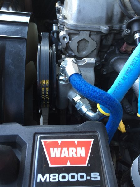

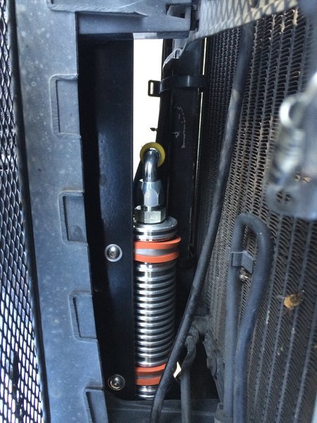

    Here is a pic of the new fitting & hose install. ToyRyd04 nailed it... smoked the pump.
    I did get the CO's adjusted and took it for a test run, even got a bit of a flex shot. Still room for more droop.

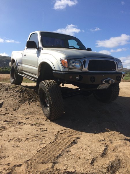

    ^^ I hear you on that.
    The 33's are all I'll go with this drive train combo. With 5.29's and an auto trans, it struggles to do 0-60mph in 20 seconds as it is.
    Nice to get something accomplished today.
    More to follow.

    I was pulling 40's at 80 on the highway with my 3rz when I was still n/a. 5.29's should pull 33's stupidly easy... And honestly you're stupid overgeared for 33's.
  20. Apr 23, 2016 at 8:03 PM
    #160
    Ritchie
    Dec 24, 2012
    #93649
    1,931
    ^^^ Do you have a manual trans?
    With the auto trans I have, there is no way I could use this truck as a daily driver going with larger tires on the Southern CA freeways.
    I turn 2750 rpm's @ 70mph with my configuration now. With the hills in my area, it's perfect.
