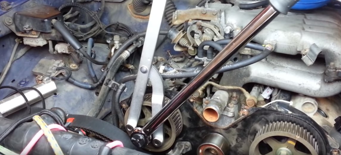

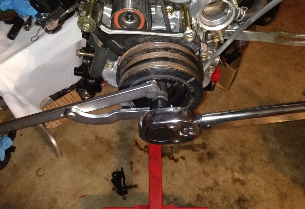

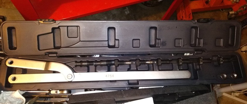

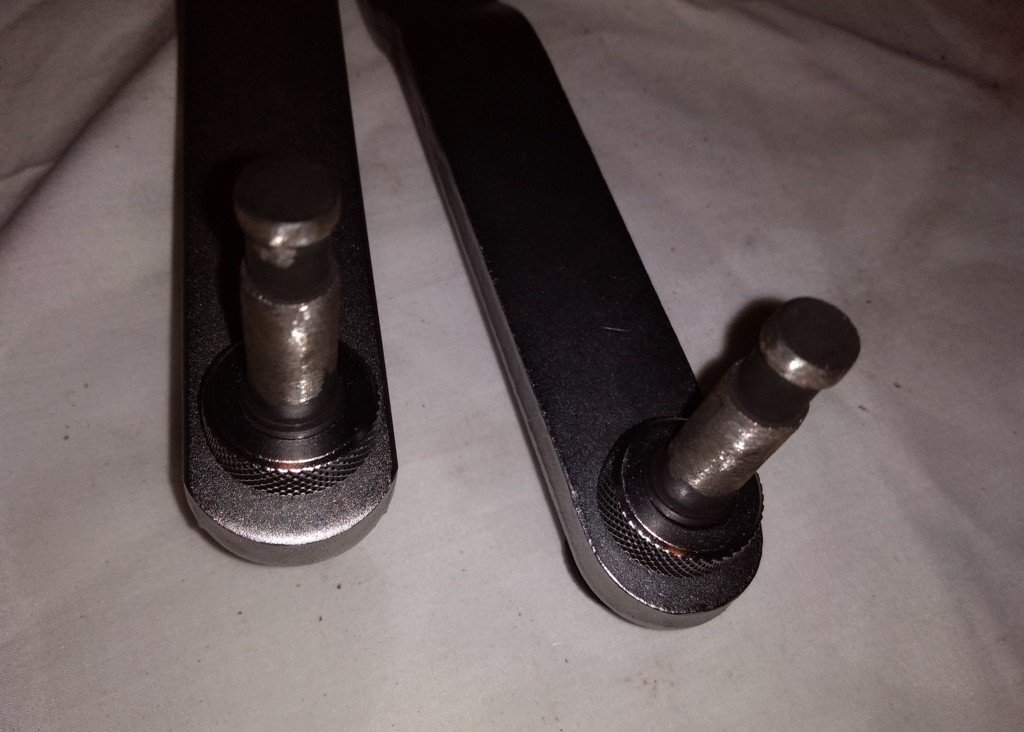

    How many people have used the Schley (SCH97300) Toyota Timing Belt Tensioner Compressor to re-pin the tensioner before removal?
    Since I couldn't find the Schley crankshaft tool, I bought one of these OTC 4754 multi-purpose pulley holding tools.
    Though initially, the holding pins were either too large for the crankshaft pulley holes or too small to hold it under high torque.
    So I decided to take the next to largest side pin and use my grinder to buff down off a small amount of metal so those would fit tightly inside the two holes on the crankshaft pulley.
    Well, that worked swimmingly.
    Here's a picture of the tool.
    Picture of the pins with a slight buffing around the outer edge to fit inside the crankshaft holes.
    Picture using the tool with my 3/4" drive HF torque wrench that I purchased almost 10 years ago for other engine projects. Click.
    The OTC 4754 tool worked for the crankshaft and the camshaft pulleys.
    I think the guy in the video is a member on here.
    https://youtu.be/j_TfAACwJac
