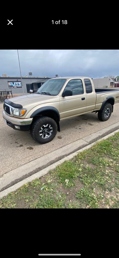

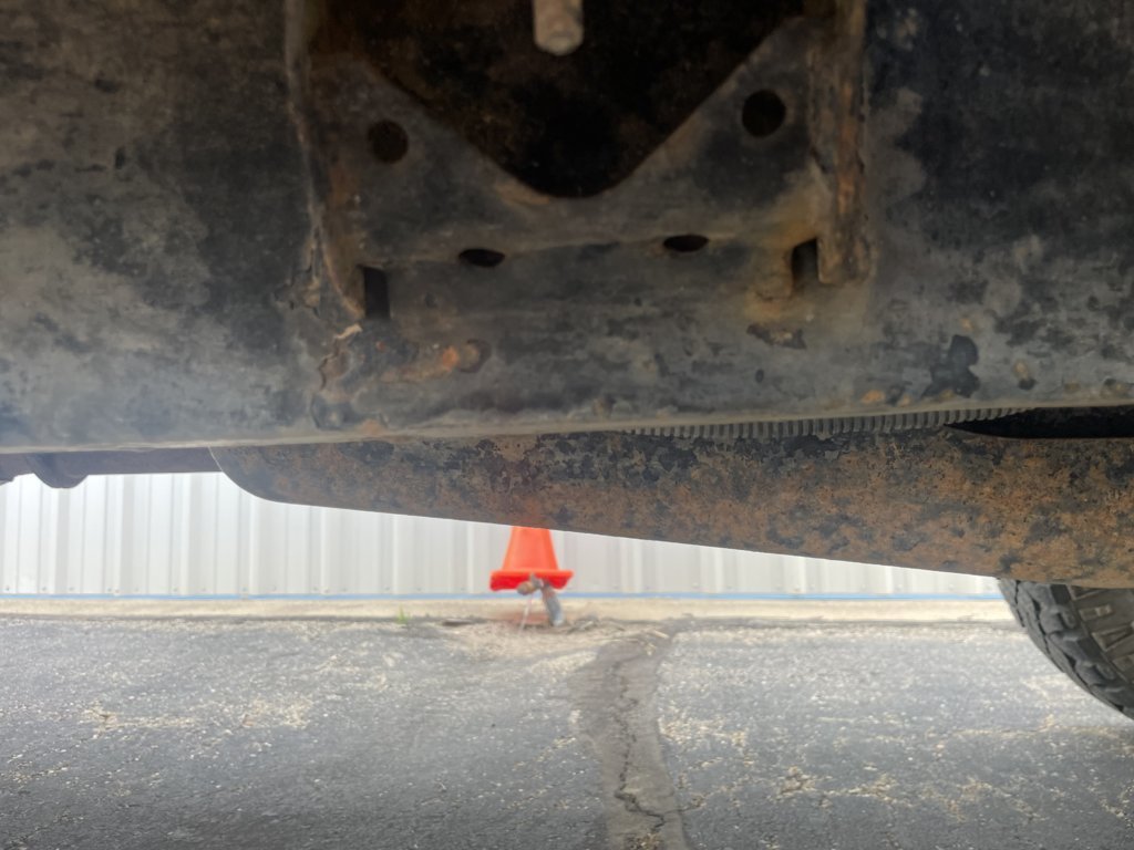

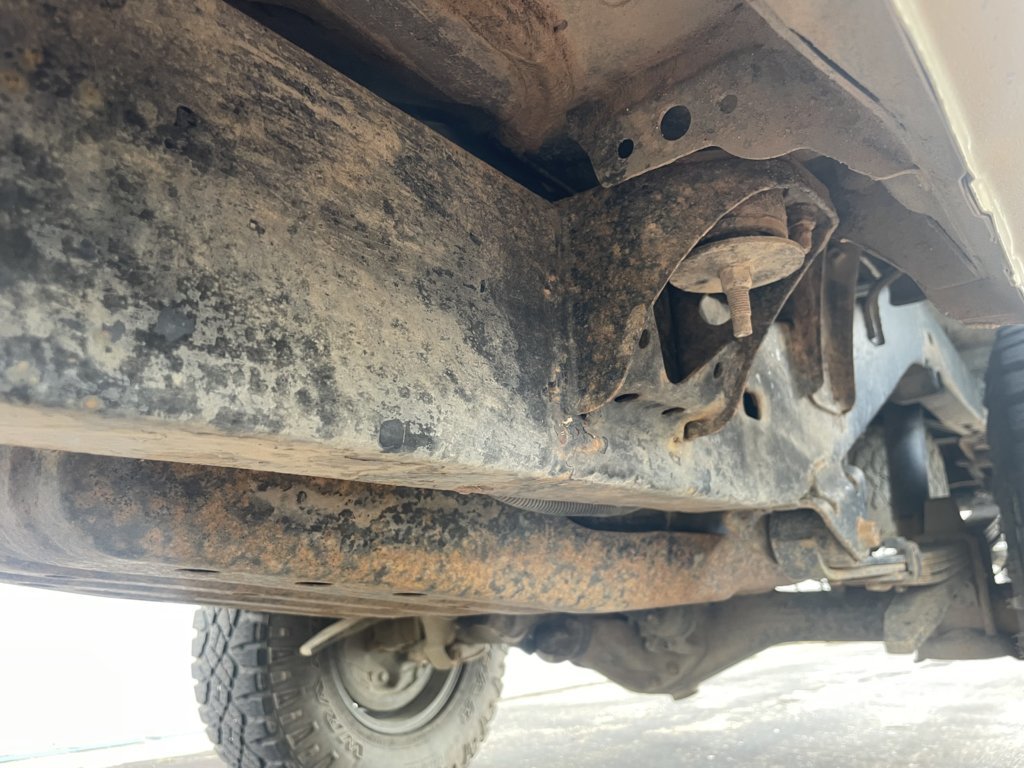

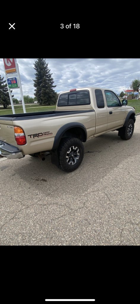

    Hi all. I’m new to the forum and really appreciate any input y’all can offer.
    I have the opportunity to buy this 03 SR5. Engine, body, interior all seem to be in great shape. Only 138k miles and 2 owners.

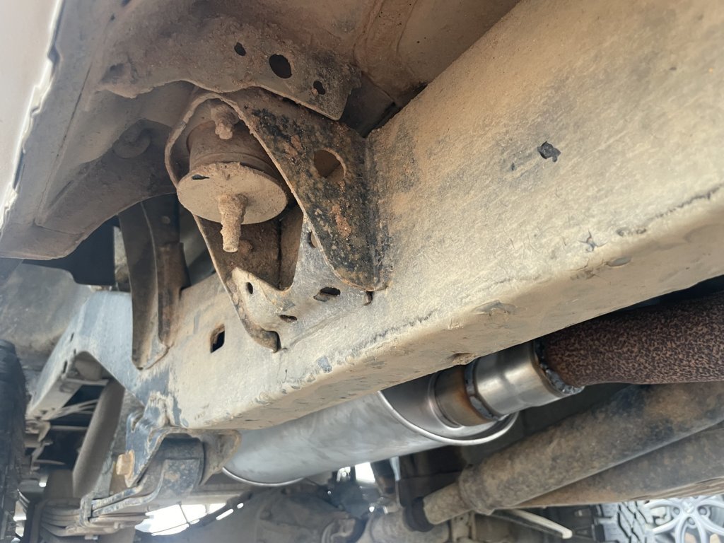

    My main concern is rust as the frame was never replaced by Toyota.

    Where has the truck lived?
    Much of that looks like red clay / mud, so in the SE?
    BTW, frames had to meet certain criteria for warranty replacement. Not every truck qualified. And not every owner was smart enough to follow up with care or inspections. You are wise to proceed with caution.

    Look like minimum surface rust.

    I agree with others that the rust appears to be just mild surface rust. If you were to buy it, I would recommend lightly wire wheeling the rust off, hitting the frame with some black rustoleum, and then coating the frame with some fluid film

    When I tapped the frame with my pocket knife there was a point that the sound turned from a ting to a light thud on the passenger side rail. Would that indicate rust issues propagating from the inside out?

    That rust isn't enough to be a concern. Send it.

    That said, OP: truck sounds good. But do tap around on frame more if you heard a thud.

    It looks like it may have seen some off-road use or dirt roads maybe. If you buy it I would clean it up and paint the frame.

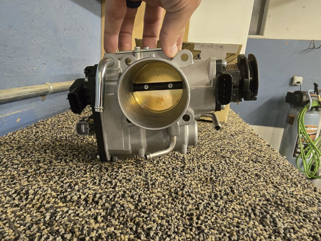

    Looking to buy a spare myself.

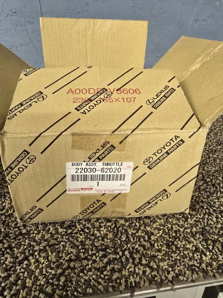

    Can you confirm that it’s the “Throttle body assembly with motor?”
    There are two parts that fit my 04 3.4.
    Throttle Body Assembly with Motor (PN 22030-62020)
    and
    Throttle Body Assembly (PN 22210-75240)
    I’m inspecting the parts diagram and cannot see what the difference between the two is.

    I'm about 99% sure that I have the PN 22030-62020 on the shelf, but I can confirm when I get home this evening (its still in the box with the part # on it). That being said your '04 is a DC, I assume with the auto trans (mine's an '03 v6 manual trans)? So pretty sure you and I will have different part #'s either way

    Part #:

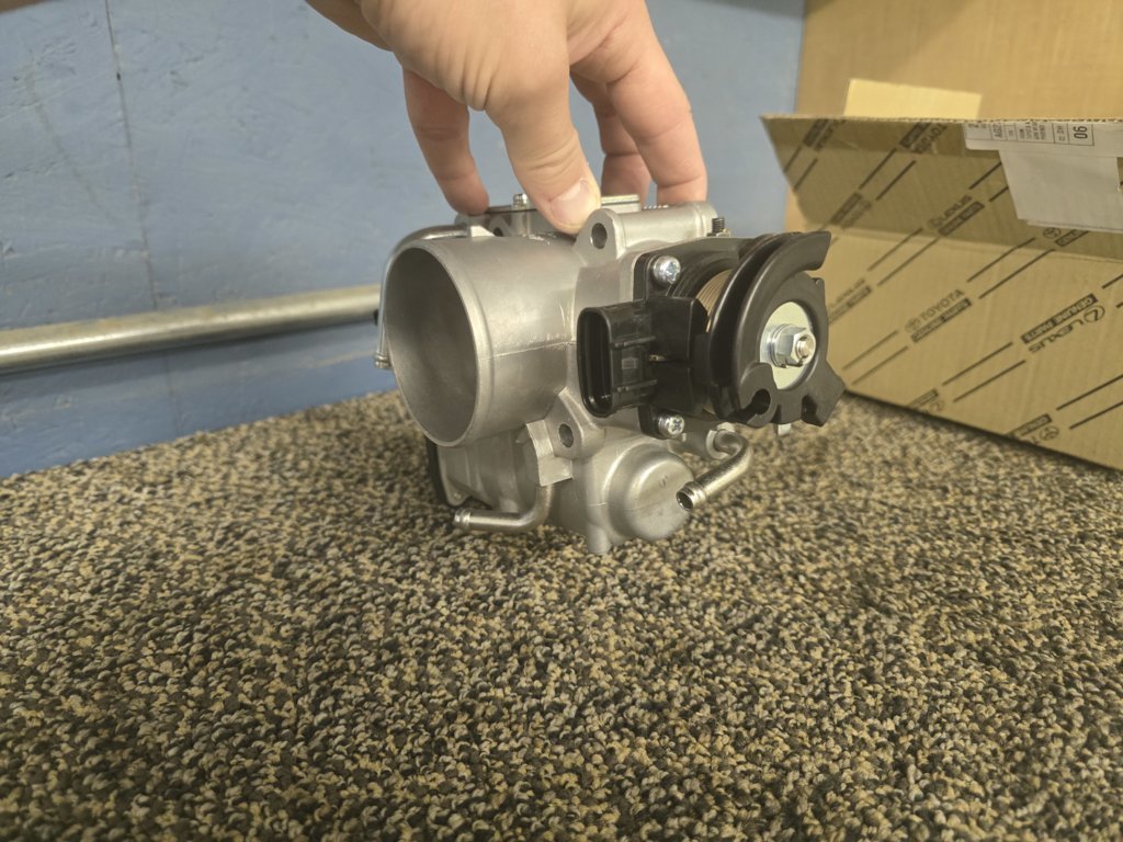

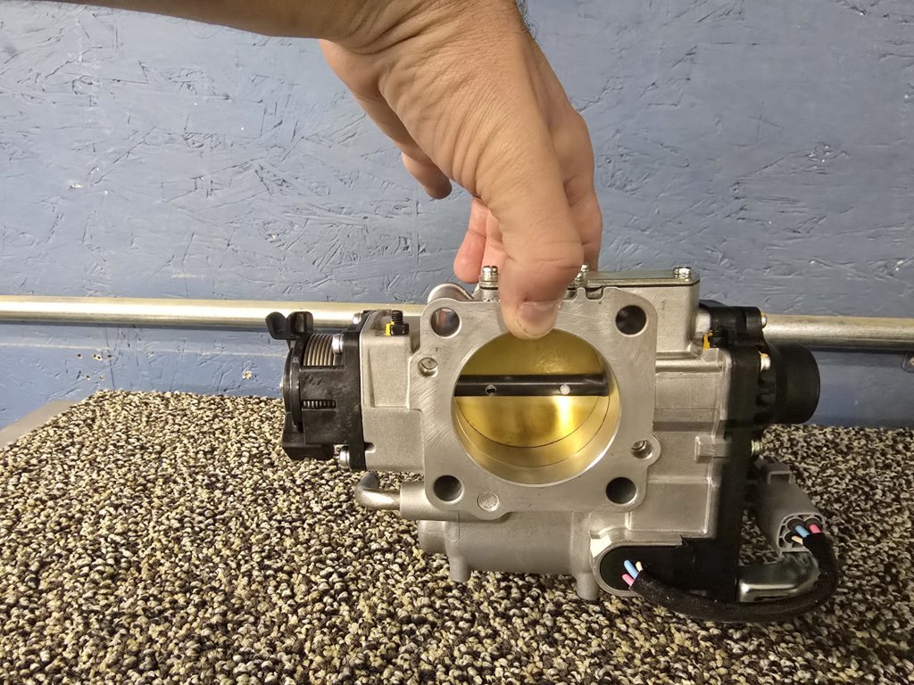

    Pictures of the throttle body itself in case they help you figure this out:
    Edit: now that i think about it, I believe your DCSB with an auto trans may actually still use the same throttle body as my truck. I think the later A340 transmissions used electronics to "kick down" versus an old school kick down cable that ran to the throttle body like earlier automatic Tacomas/4Runners, thereby allowing the same throttle body to work with both.
