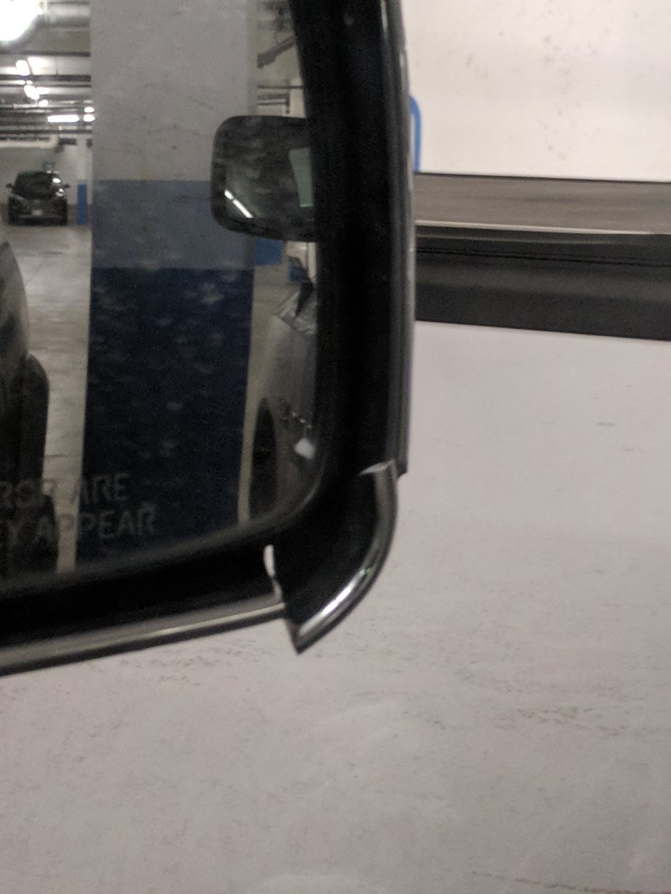

    So I did a thing....now I have the excuse to find heated mirrors, is there such a thing? In chrome?
    Ugh condo life

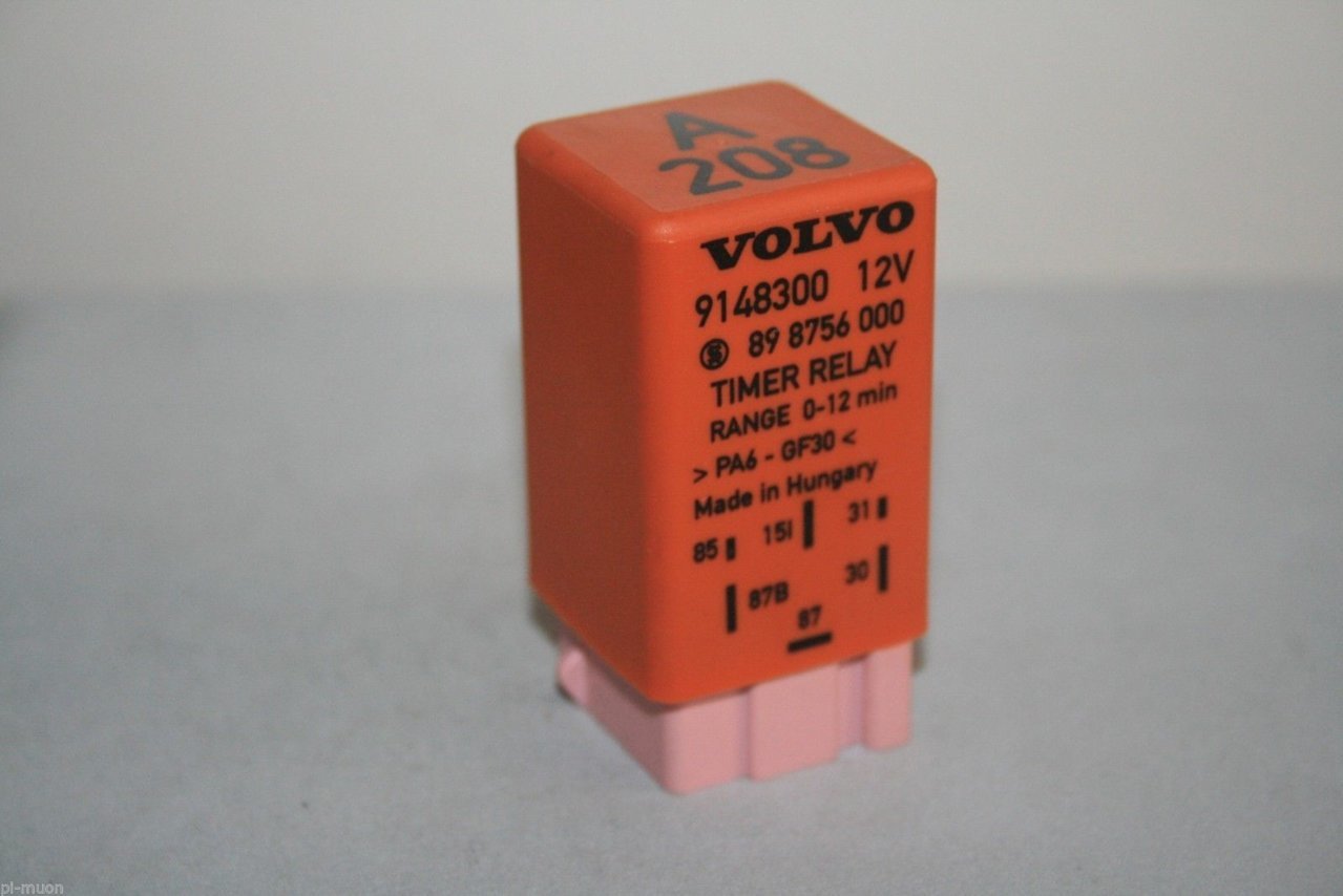

    I did the heated mirrors on my 2003.
    I used a Volvo V-70 Defrost timer. I then found a Mirror defrost switch that had the look I liked and fit the Tacoma.
    After removing the mirrors from the housing. Take a slim piece of metal/ putty knife (hacksaw blade)and carefully heat it up then slide it under the mirror to remove the glue.
    I bought motorcycle heated hand grips an glued them in place behind the mirror.
