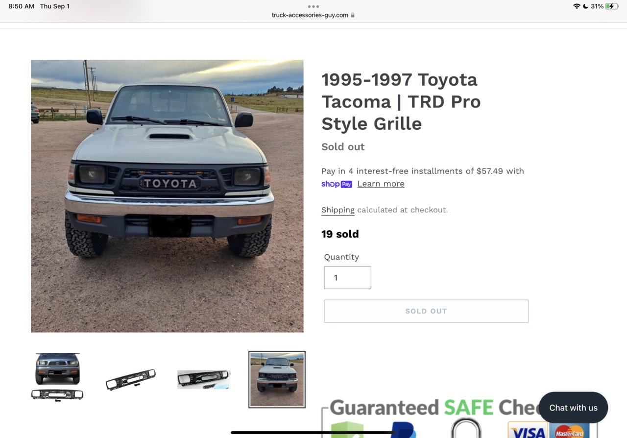

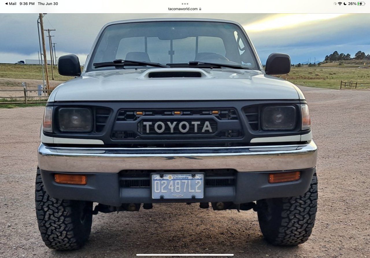

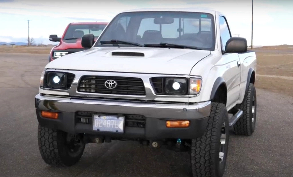

    To make it look factory and clean you are most likely going to have to do some cutting. Find any scoop that suits your fancy, preferably from a 4Runner or second gen taco, I think they look the best, cut it out and weld it into place within the cutout of your hood. There are some great examples of this, like this cat, he’s running a supercharger and has something like 500 plus thousand miles on his taco.
    1997tacomav6.

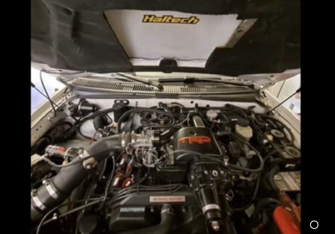

    V6 5sp,RegCab,TVS1320 Supercharger, 56mm pulley, methanol injected Haltech ECU, AC Tvs1320 supercharger,(MUST DO) every 125,000- 150,000 needs rebuild Projector headlights HID 5 speed manual Amsoil for all drive train Smaller 56mm custom pulley, (MUST DO) 2004 DESNO fuel injectors, zero ping ping, 2004 side door mirrors Dick Cepek Rims, Michelin tires LTX, ATM Pathfinders Dynopro ATM ( that last 100,000 miles) Now running Dynopro ATM mud and snow tires KN cold air intake Cat back dual exhaust with ss exhaust tip, Raised exhaust tail pipe to 2" below body line Optima*dry cell battery,red top Alpine sirius radio, 200 watt amp, focal is165 split door pod speakers Focal door speakers Subwoffer behind seat Viper alarm, Electric Locks Dark tinted windows, bucket seats corbeau lg1 Tacoma Rubber floor mats TRD fender extenders, Bilstien shocks, King shocks JBA UCA trailer iv hitch, electric brake control, Drilled slotted brakes, High carbon steel (MUST DO) EBS green stuff 7000 series pads(MUST DO) TRD engine oil cap TRD stick shift, Marlin crawl shift kit. Rear sliding window 2002 4Runner functional hood scoop cut into Tacoma hood, 4Runner dual overhead map light Gentex Auto dim + Compass + Temp, garage,rearview mirror Snow Methonal kit stage 2 Custom 3 core aluminum radiator Linex bed liner Haltech stand alone ECU, Intake supercharger gauge. Stainless steel brake lines, Custom leather wrapped steering wheel, Haltech stand-alone ECU,

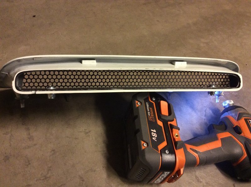

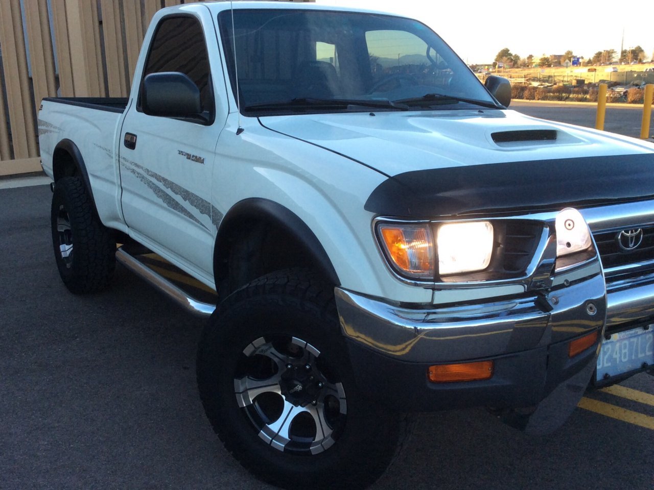

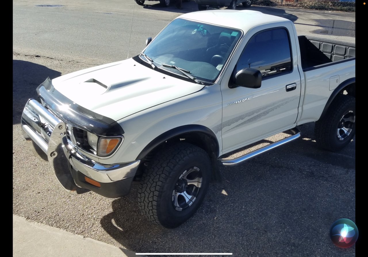

    Here is a thread I started 6 years ago step by step how to do the scoop foe a factory look.
    It’s a lot of work but a great payoff
    https://www.tacomaworld.com/threads...into-1997-tacoma-for-trd-supercharger.452234/

    Not true, mine was done 6 years ago with no issues,
    I guess if you do it incorrectly without welded it in , :)
    Just go through my build on the link for this mod.
    You could weld the scoop to the hood without cutting up the hood too I guess.
    I wanted air flowing over the supercharger to cool it down so the scoop is functional for me.
